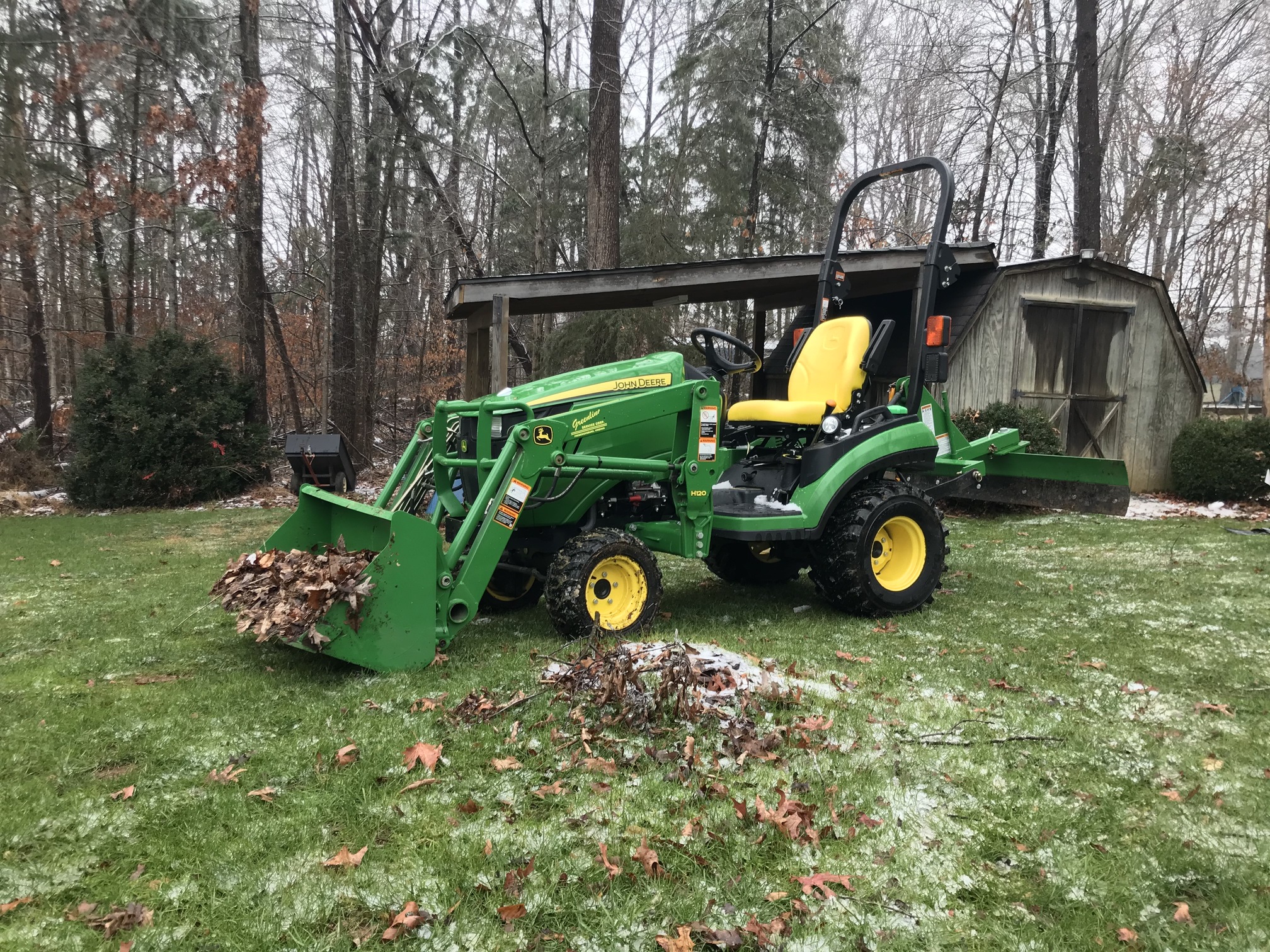

Well it's been awhile. Parted with my Kubota BX2360 in 2014 but recently began the search anew. I knew it had to be green; I grew up earning money in the summer on my Dad's GT275 - which I have now along with a GT235. I looked at 2210's, 2305's, 4100's, 1026R's... and I am sure a few others. I was close to pulling the trigger on a 2305 when I came across a 2016 1025R with 122 hours. I put some cash down and somehow ended up with same as new financing on the balance. I am thrilled to pieces, looking forward to keeping this one forever!
Welcome back sir.
As mentioned by bigtiller "six years without a tractor, there must be some horror stories in there". As handy as the newer subcompact tractors are, I could not imagine not having one if I still had any yard at all. Not my favorite color but it's a good looking tractor.
Enjoy.
