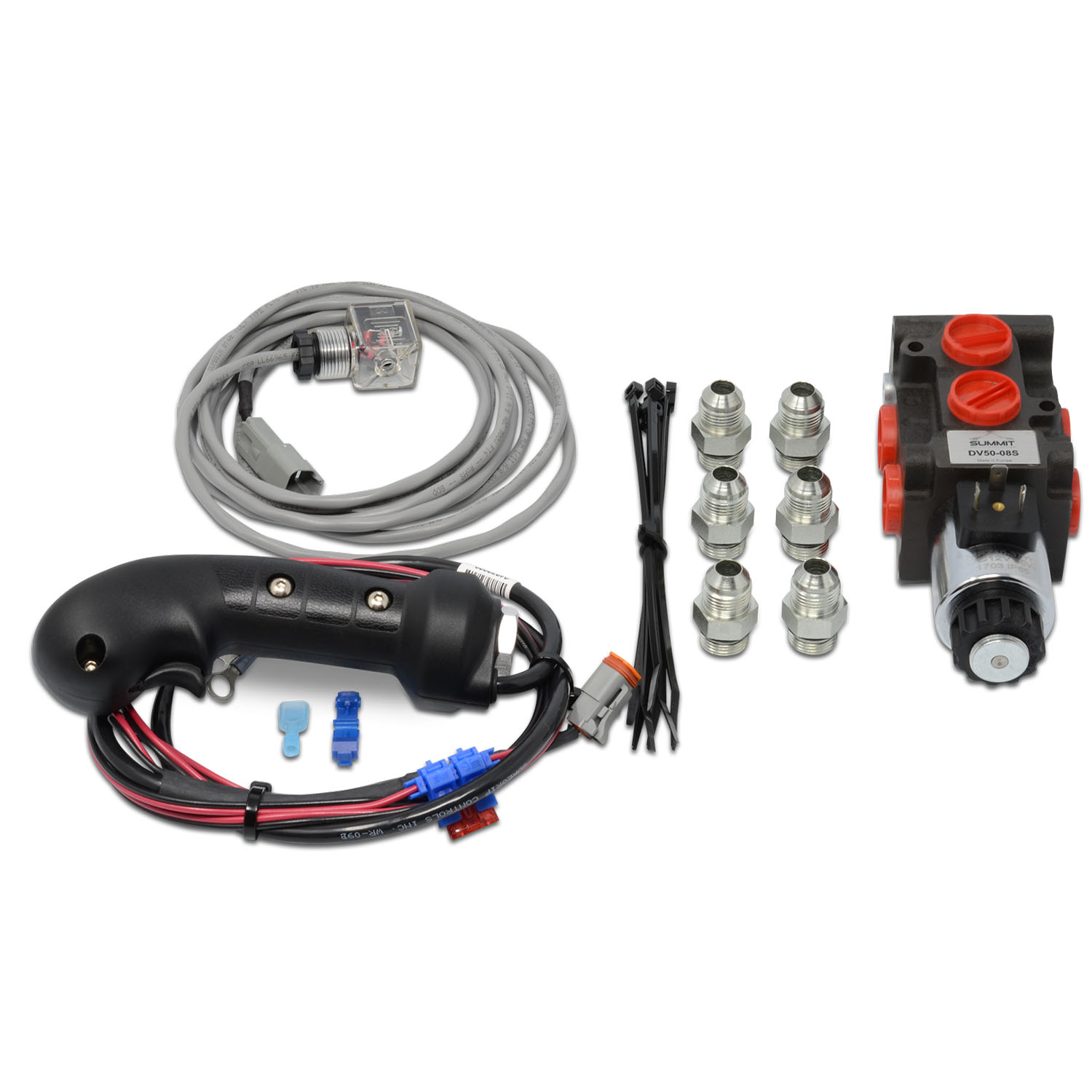

I had a tractor while back that tapped into front loader lines with an electrical divertor valve. Costs around $500 complete to go that route plus hoses and odds and sods. see pic of sample kit. Or if open some try and use rear remotes themselves if available and not being used for something else.
now I just go 3rd function plumbed in power beyond (or similar) not too much more $ and cleaner and more long term stable install IMHO

Either a diverter or an electric 3rd function is much more ergonomic as there will be a button on your loader joystick. And your hand never has to leave the control lever

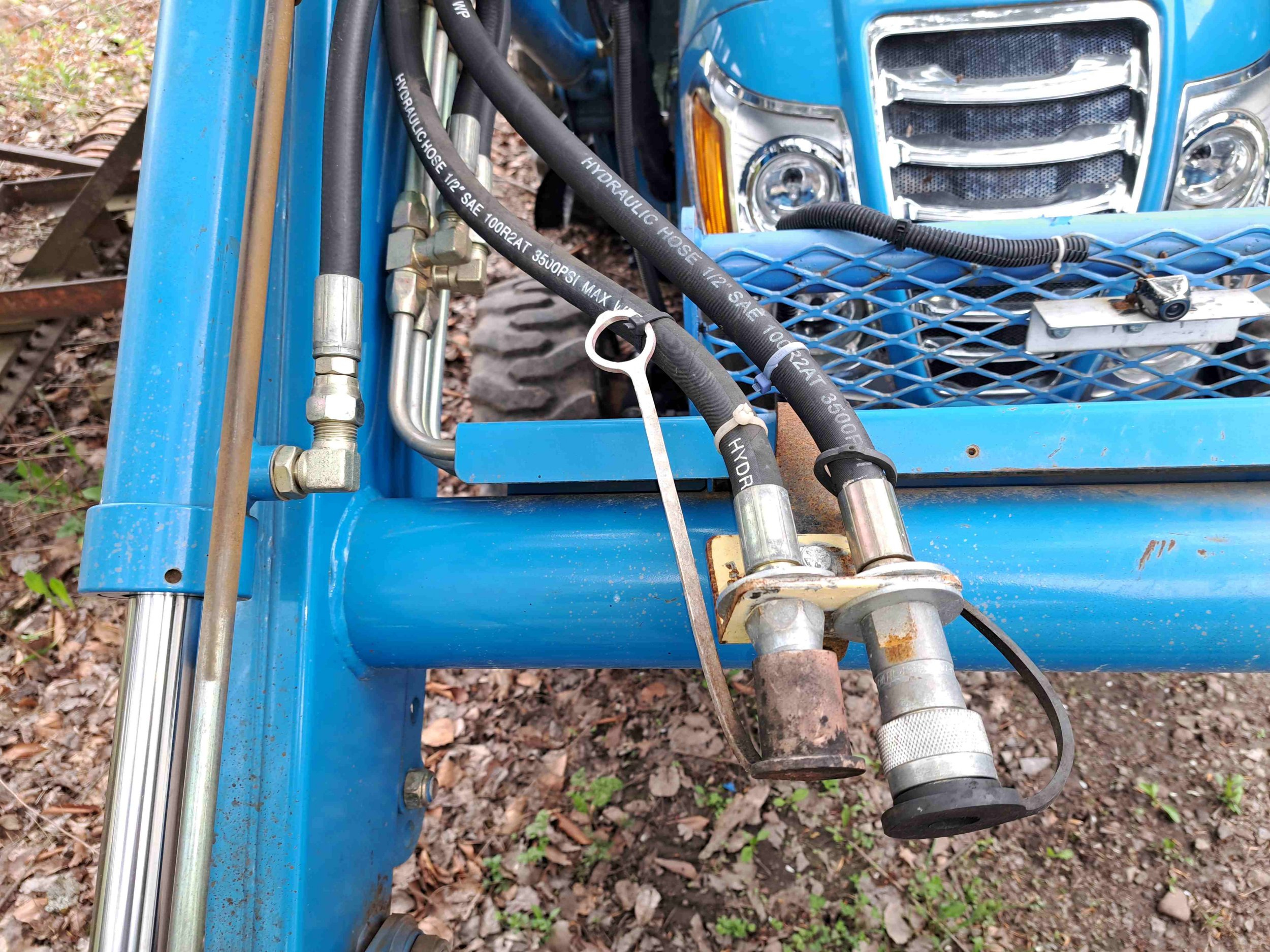

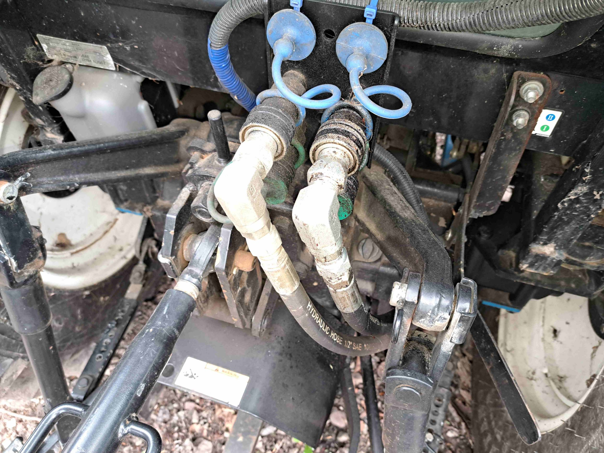

I just bought a new LS compact 47 horse tractor. I didn't get the 3rd function set up for a grapple in the front. I was told I could run longer hoses from the rear connections, to the front for this propose. Is this true? If so, do I simple buy two hoses?
You can run hoses from the rear remotes to the front. I did it and use them to operate a hydraulic thumb on my forks and to angle a snow plow in winter. Bought hose and fittings at tractor supply. Ran them under the tractor and zip tied in place. I posted a thread listing all materials used but couldn't find it using this sites search function.
