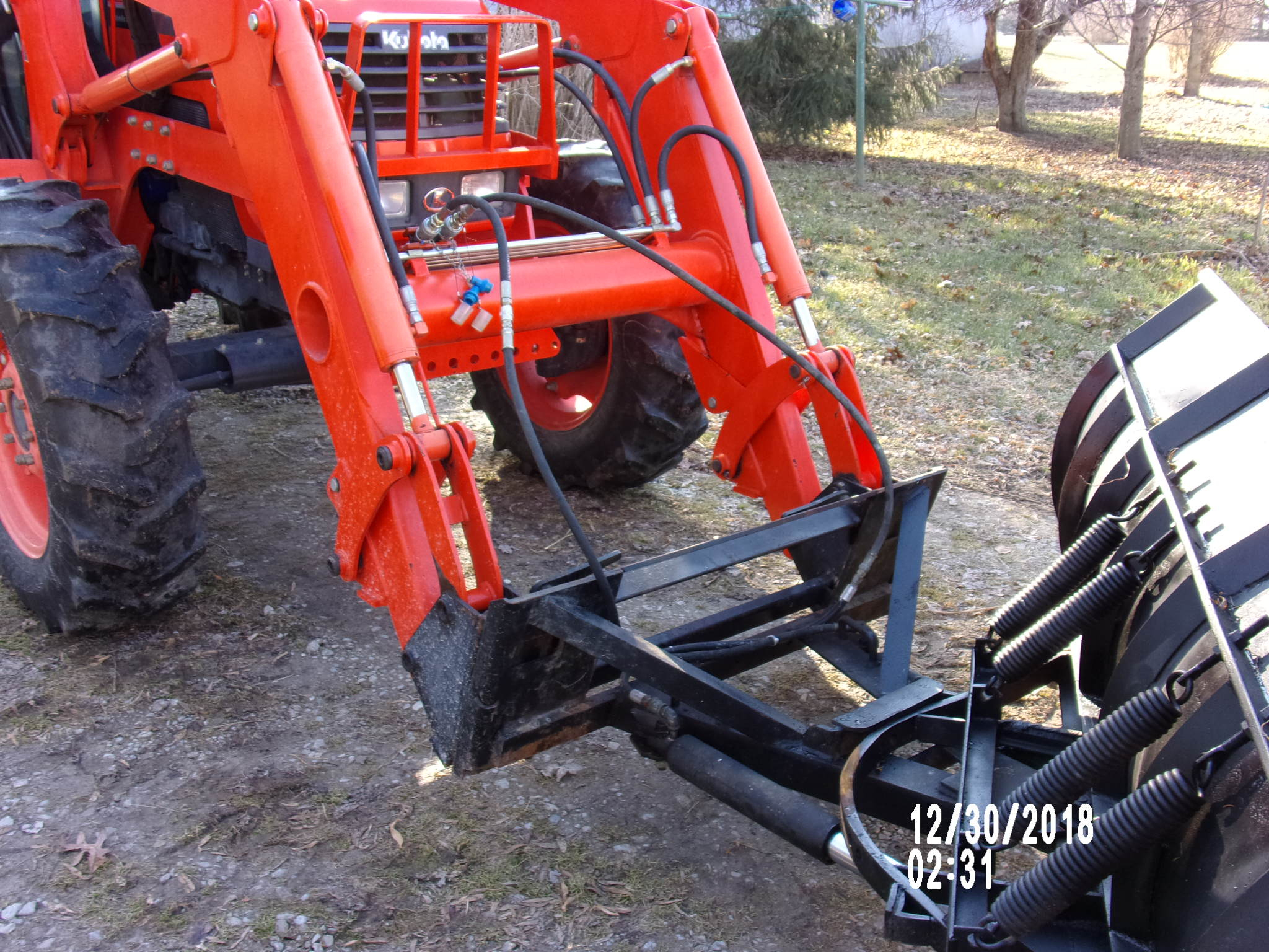

What I did with my cabbed M9 actually but there is a bit more to the story as Paul Harvey used to say..
If you ever want to remove the loader, you'll have to install a set of couplers where the loader plumbs into the loader feed lines. I added a set of male and female Pioneer couplers (mine uses Pioneer QD's) so you can remove the loader. I used smaller diameter hoses I sourced from the local parker hydraulic shop. Ran them along the present metal loader lines.
Mine is for my power angle snowplow...
