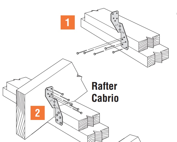

The brackets are flipped around backwards (don't change the orientation, but put them on the other side of the rafter), but it looks like you are using the right nails. I'd like to see a horizontal ceiling joist between the low beam and the tall post to help triangulate things. The beam-post connection should be through bolted.
For the spatially visual challenged a picture would help:
What the poster did:
451098d1450582400-im-building-wood-shed-i-clips-jpg
What is recommended:
451725d1451226960-im-building-wood-shed-i-rafter-tie-jpg
   / I'm building a wood shed....I need some help #113
For the spatially visual challenged a picture would help: What the poster did: What is recommended:
