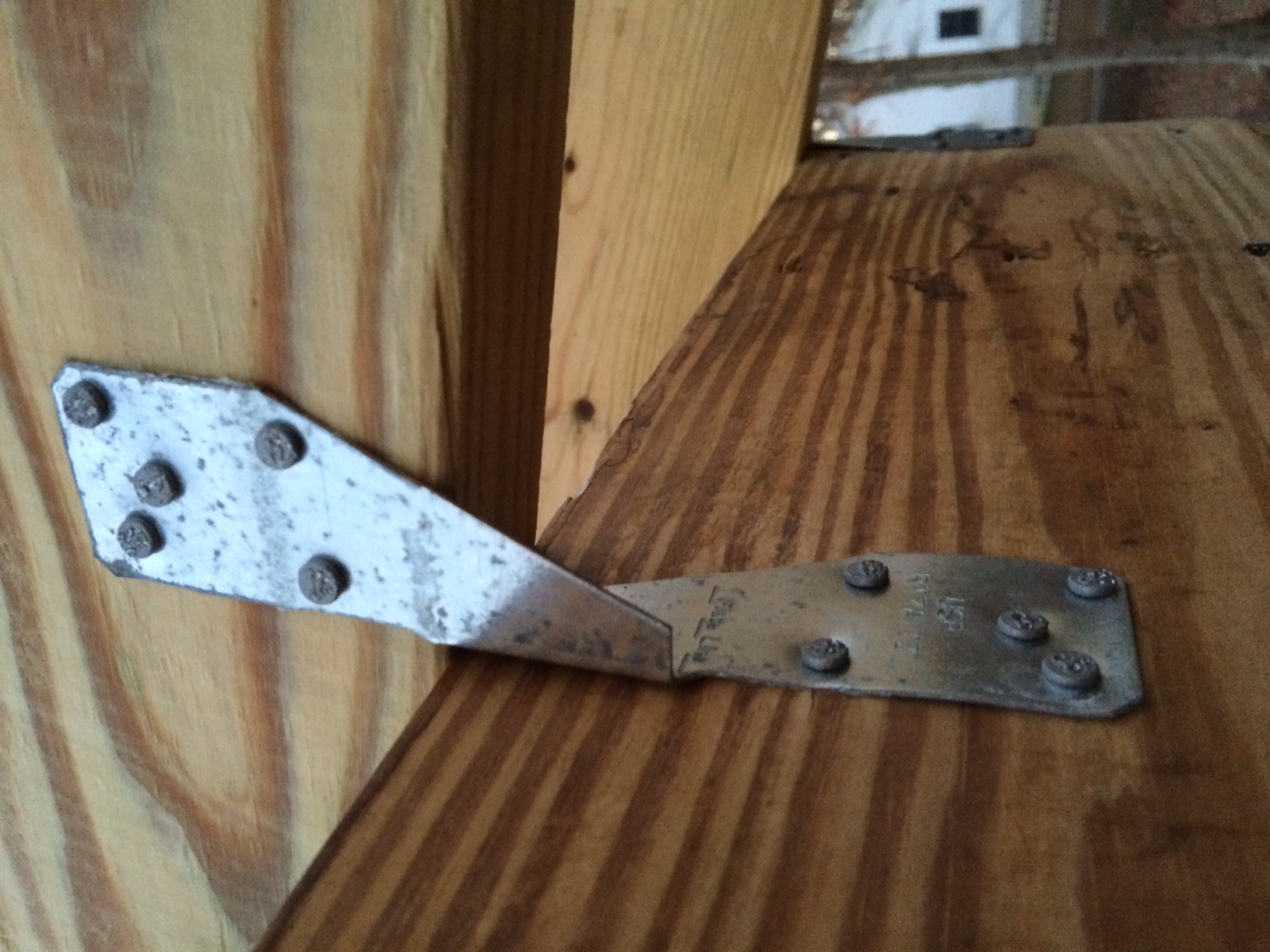

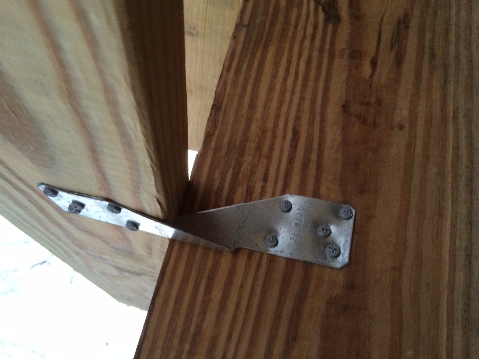

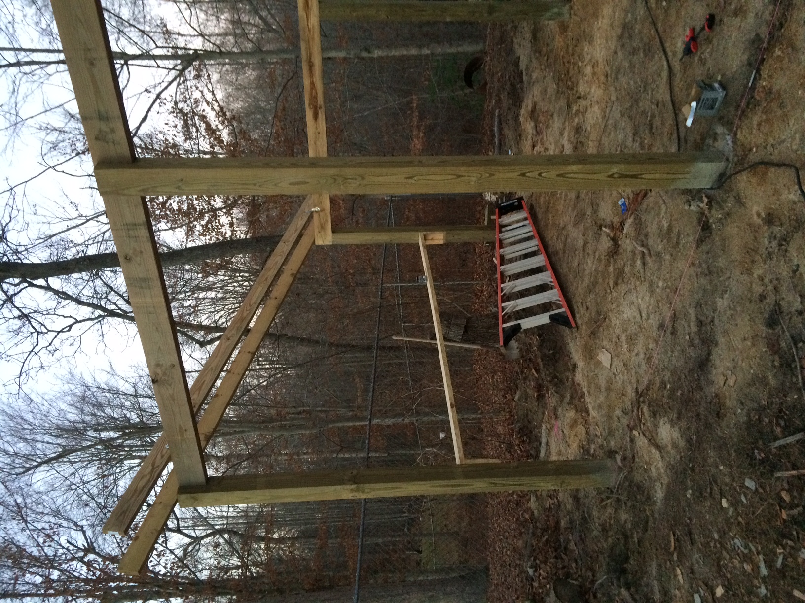

Got a few hours today to work on the shed. Got the rear double header up, a couple side braces and a couple trusses.
Question: I picked up these truss braces but I don't know if I'm installing them right. Here is a couple pics. I've flipped these things all around and can only get them to basically work one way but they sure don't lock the truss down good. Maybe I'm supposed to install one on the opposite side of the other on each end??So if the front is on the right, put one on the left at the rear.
Don't worry the headers will be bolted to the posts.
   / I'm building a wood shed....I need some help #75
The ties aren't designed to help the rafters ridgid. They are simply designed to keep them attached to the building as they give a ton of uplift prevention. The rest of the roof structure is what gives it rigidity.

Yea I saw FTG used them on his lean to. I like those better, I think I'm gonna with those kind instead.
LD1 - so they're hurricane clips then? I'll use the ties plus toe nail some screws in. I did see a video w/ some 6 inch timberlock screws that get toenail screwed into the header underneath the the truss then up into the truss.
   / I'm building a wood shed....I need some help #77
Yes, those are hurricane ties. So are the other diamond shape type.
Good for uplift, as they are designed. You still need to build a proper roof
