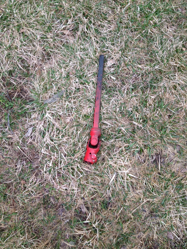

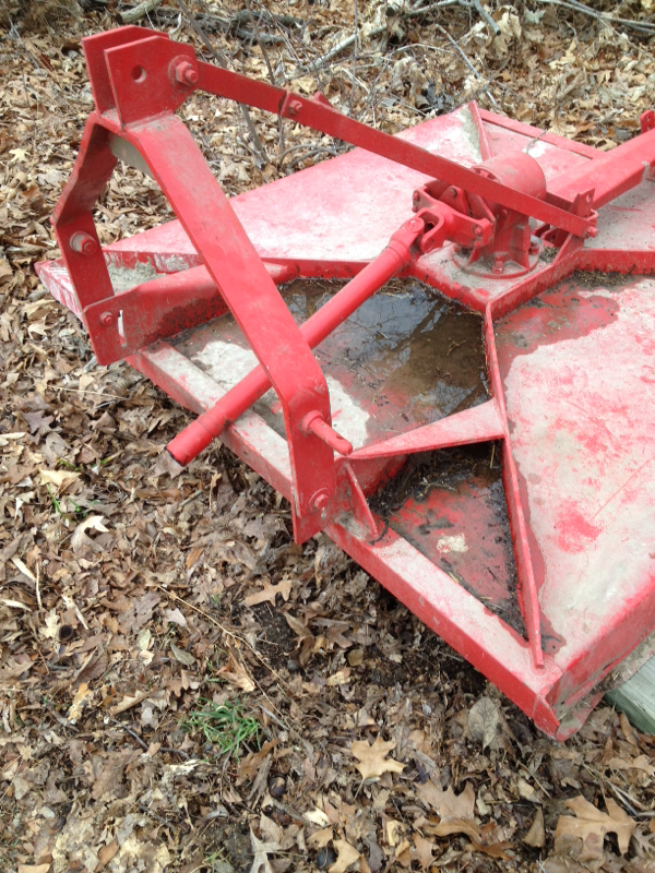

The ballast box is supposed to arrive in St Louis later today. I can't pick it up until Monday.
I did buy a very used Mohawk brush cutter yesterday. I spent some time trying to get it hooked up to the 3 pt hitch.
All good, and relatively quick, but the PTO shaft seems way too short. I had the lower links in all the way, and the top arm in, but the PTO shaft was almost extended too far. It wasn't turning properly, didn't seem straight.
I guess I need to get a longer shaft.
It's a five footer, but seems to be in decent shape.
Having never owned or really run a tractor before with the PTO active, it's different. Just trying to figure out if I've got everything hooked up right. Ha

MOPops. how much overlap do you have on the PTO shaft?.. keep in mind that varies depending on where the 3pt lift is. Six inches is normally considered the bare minimum. Also if you get a new shaft, be sure it is not too long as it can damage your PTO bearings on the tractor. Here below is a guide. The PTO overlap is constantly changing by design as you go over the ground or back over a hole and when you raise it fully up.
BEFCO - Technical - Technical Tips - Adjusting the Drive line to the correct length.
   / I'm going Bobcat.. #138
Further info, you may be able to just change out the tubing, depending on the design of your shaft. It may require a hydraulic press to get it out. Most towns will have a driveshaft rebuilder who may be able to help you. PTO shafts are not cheap.

Great. It's a very old model and the driveshaft is open, (as in not enclosed or protected) so I guess I'll be shopping for a fix. I'm guessing I had a little less than 4" in there.

Here's a pic of the Mohawk brush cutter and the shaft. I was hoping to just extend the square shaft. However, the shafts I see at new implement dealers all look enclosed or something. Is this antique that unsafe?
