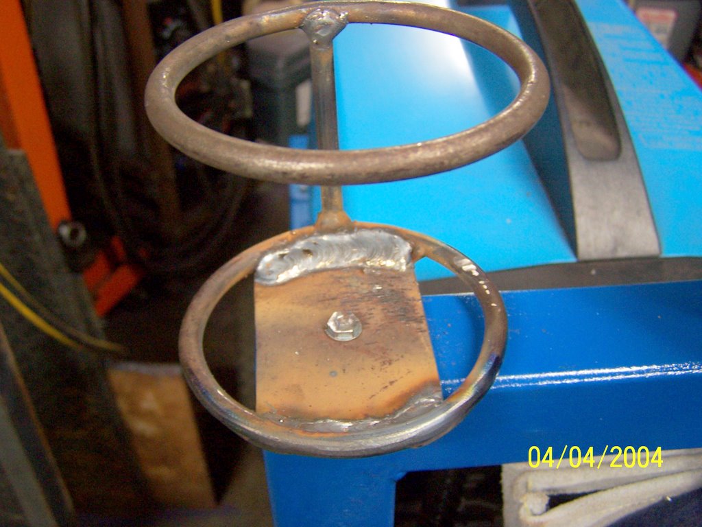

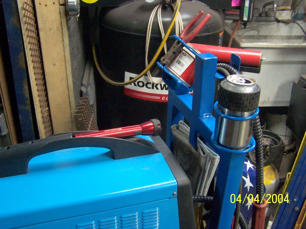

A beverage holder is really worthwhile. Here's a pix of it unfinished, then painted and the little jig used to bend the 1/4 rod. This little jig has been one of the most useful things I've done. (This picture is not of mine though).
Another suggestion is to hang your chipping hammer outside. You use it a lot so you want it handy.
Finally, I also mount an electrical box on a vehicle such as this. I would set it up for four wire from the welding panel that way with the neutral there you can split 110 out for a grinding wheel receptacle.
Hope this gives you some additional thoughts on upgrades. After all while I"m building my copy of this you can be upgrading yours.....:D:D:D:thumbsup:
