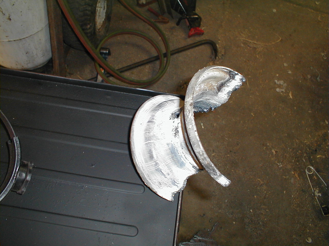

I love the headlights idea!! Especially because it's functional. Now I'm always going to be looking for a way to make that happen. There has to be a way.

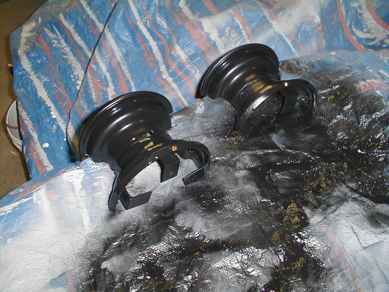

Regarding the idea to cut the wheel... I thought that was a great idea. See the attached picture. That's what I did last night before calling it quits. Don't mind the ugly glops of slag hanging from the crooked cuts. Have I mentioned that I suck with a blow torch?
All I can say is practice, practice, and more practice.:thumbsup:
Even so, I'm willing to bet that it looks better than it would have if I had tried.:D I've yet to ever put my hand to a torch.:laughing:

A slight change of plans. I decided to weld tabs onto the wheel halves and bolt them to the cart. I got them welded up tonight and painted. By tomorrow night the paint should be dry and I'll put it all together.
The end is near!!
Note to self: Buy 1/4" bolts at the hardware store before coming home tomorrow.

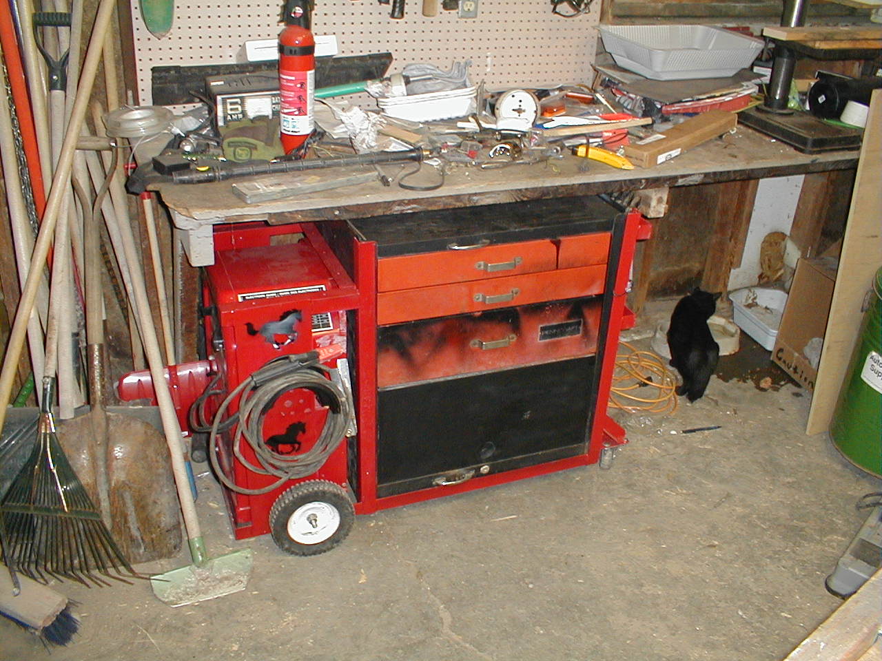

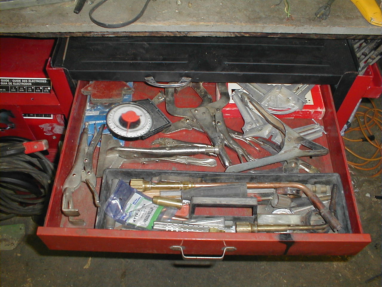

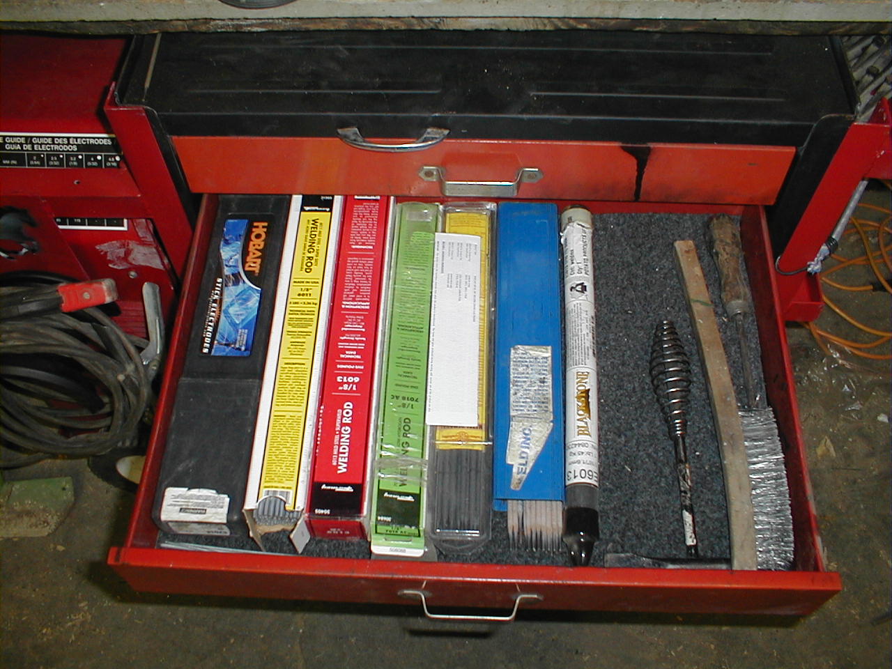

For all practical purposes, the welding cart is now finished. I still want to cut out a piece of wood to put over the welder, but I need to do some serious cleaning in the garage before I can do that. I also want to put a piece of Hardibacker on the top of the toolbox to make it easier to use as a welding platform.
I loaded up the toolbox this evening. It is really nice to have a place to put my welding stuff. I had it scattered all over the garage.
The first picture is of the cart under the workbench where it will stay.
The second picture is of the bottom compartment. I'm not sure what I'll do with that, but for now I have angle grinders down there.
The last two pictures are of the top two drawers. One holds my rods, the other holds all of my other welding stuff.

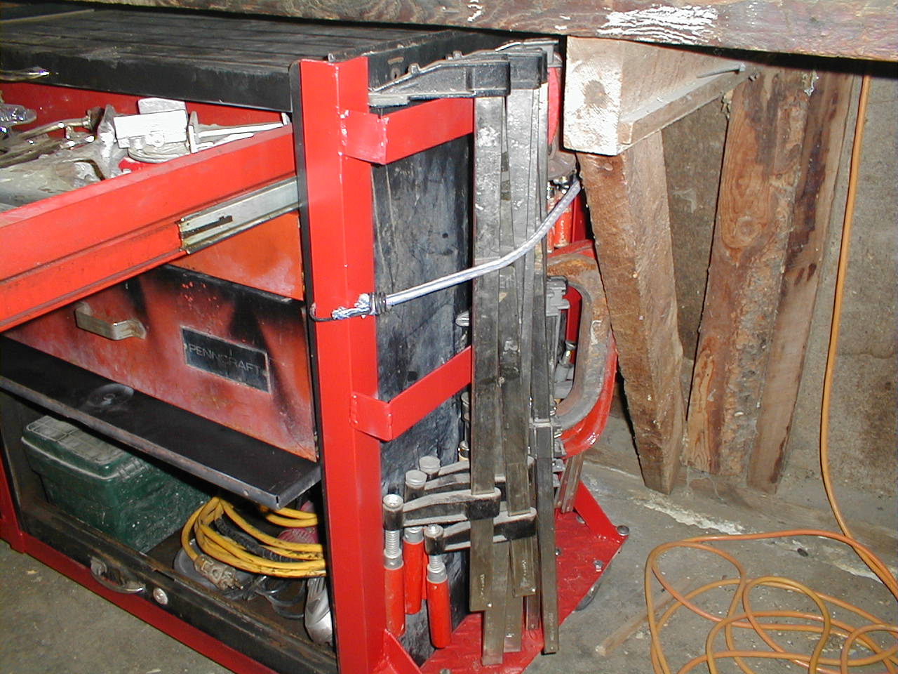

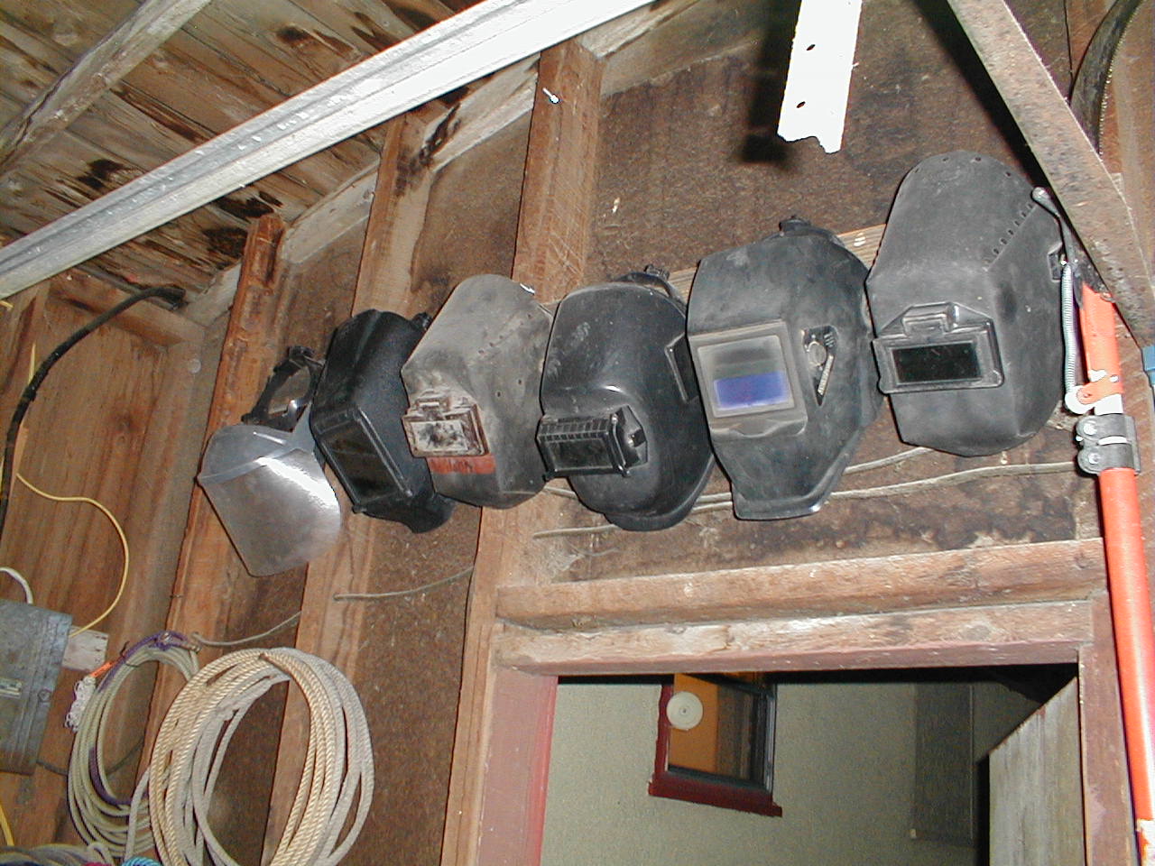

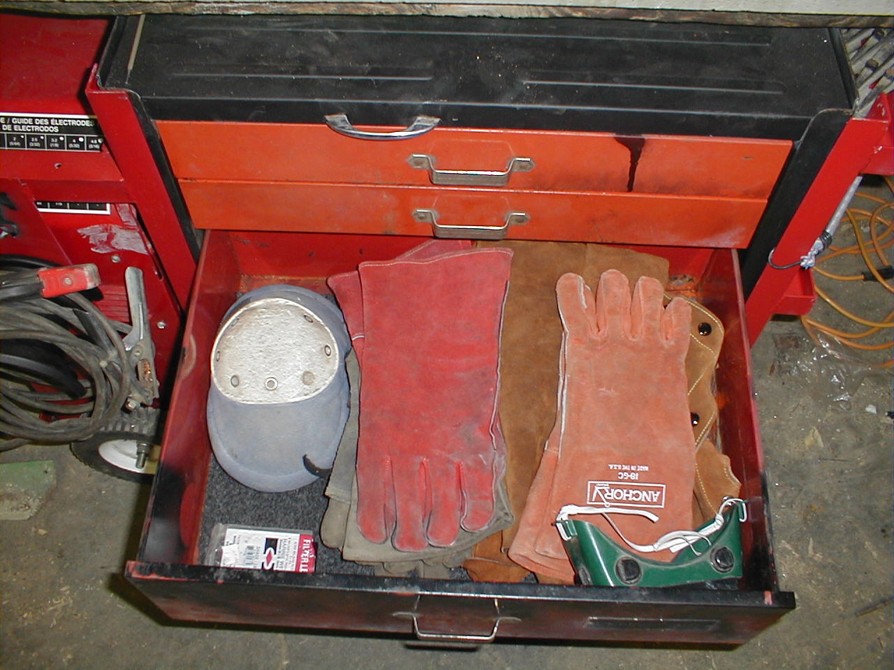

   / I'm Looking To Build A Welding Cart
#79
I'm throwing in a picture of the large drawer that will hold my sleeves and other protective gear, and a picture of my welding helmet collection that hangs over the door to the garage. There's also a shot of the clamp collection hung on the side of the cart. I have room for a few more.
I'm eager to hear any suggestions from the brain trust for better ways to organize the cart.
