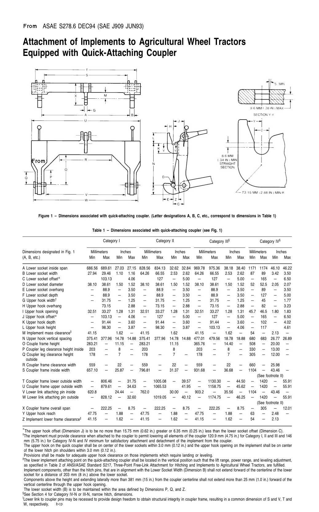

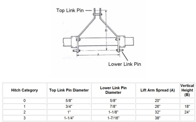

Hopefully these diagrams/specifications will help below:
You may need to use a top link extender:

Hope you get this worked out and would add to keep the older IMatch and make everything fit it. To be "quick" you don't want to have to alter settings on any of the implements each time you decide to use them.
/ iMatch/Quick Hitch Questions
It has been an incredibly frustrating day. The Woods manual sux!!! After looking at the diagrams listed above and measuring again I find the iMatch is just a hair over 14.75" (right where it should be). As the dealer put the Woods mower together it appears configured for a Cat 2 machine Quick hitch. There are 3 holes in the yoke at the top of the mast and according to the manual and schematic, the attachment point for the top hook on the QH is a sleeved 5/8" grade 5 bolt in the 2nd hole. The manual doesn't show it but there are 3 holes in the mast. The lowest hole is is a 5/8" hole (too small for a Cat 1 7/8" pin). Because the schematic showed that the attachment point was a 5/8" sleeved bolt I attempted to remove the bolt that the dealer mounted in the 2nd hole to move it to the lower hole.. They must employ gorillas because nothing that I did could get the bolt off that nut. I tried hitting it, used a "cheater" and fired up the pneumatic impact wrench, all w/o success. Having given up on budging the attachment point, I found a 5/8" hitch pin and put it through the lowest hole. That put me close to the right measurements but when I hooked the iMatch up, the bottom pins were not making full contact with the bottom hooks. I had a couple of CAT 2 to Cat 3 bushings that I slipped on the bottom pins and every seemed to line up.

From what I read in your post I should clarify that 3/4" is the correct top link size for a cat 1 hitch, 7/8" is the correct size for the lower links cat 1 hitch. If it were me and everything else fits correctly except the 5/8" bolt size I would drill it out to 3/4" and use a standard 3/4" top link pin. Add the 1 to 2 and 2 to 3 bushings to get to the cat 3 size.
The other choice is to weld in a piece of cat 3 top link pin properly centered in place of the 5/8" bolt. I have used this method on a few implements that needed the extra strength in the design. If you do this make sure everything is in alignment first as it will be frozen in place so to speak.

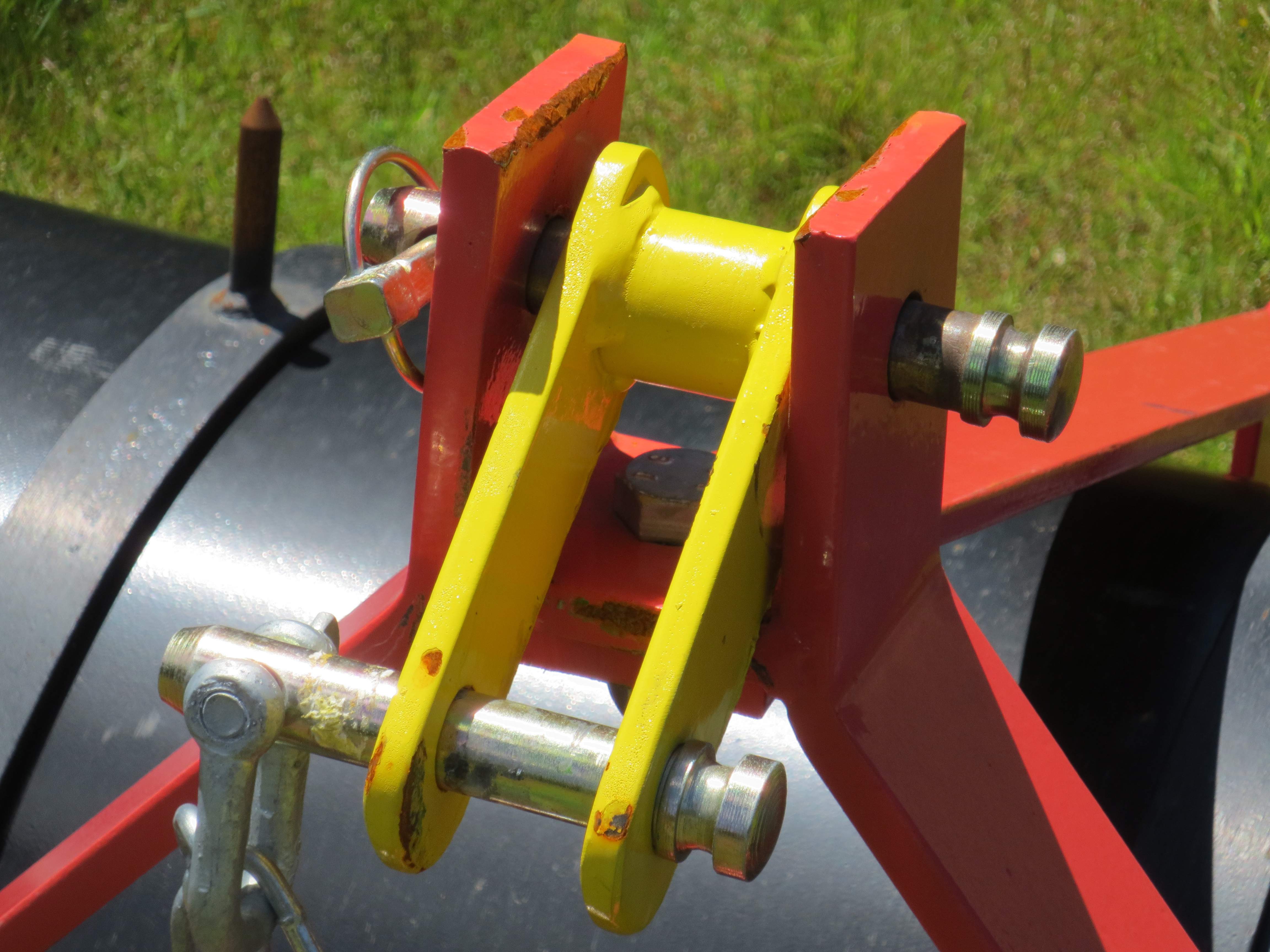

For what it is worth, I did take a picture of my CAT2 quick hitch set-up today.
#14
You have your top link where mine needs to go. Right now it is in the hole above and I am "making do with a 5/8" hitch pin. Are your lower bushings "pinned". I assume they are Cat2 to Cat3 bushings? I had a box end wrench on with a piece of 4ft 2" steel pipe as a cheater and the only movement I got was feeling the box end wrench start to bend.
/ iMatch/Quick Hitch Questions #15
One of my wrenches was a snap-on, while the other was a Northern tool. I wedged one wrench against the deck and leaned on the other wrench to break stuff loose.
My lower bushings are cat 2 to cat 3 but are not pinned.
