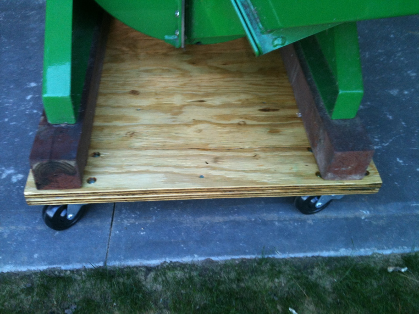

4,061
South Central Iowa
TYM 330 HST with FEL
I am in process of making dollies for all my implements. I went to HF and bought bunch of casters on sale. My shed is too low to get tractor in without folding ROP so now I just stick the implement in, lower it on the dolly, unhook it and pull it in its parking space.

/ Implement dollies. #4
<img src="http://www.tractorbynet.com/forums/attachment.php?attachmentid=333492"/>

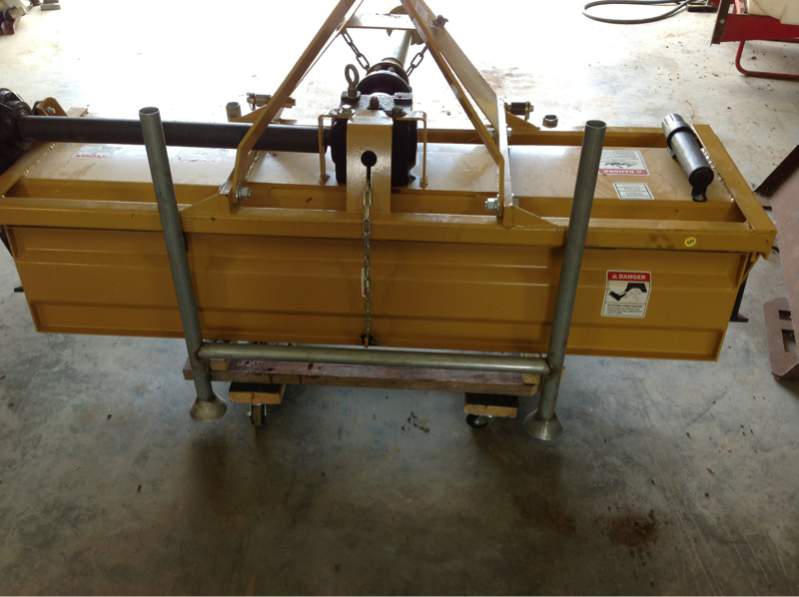

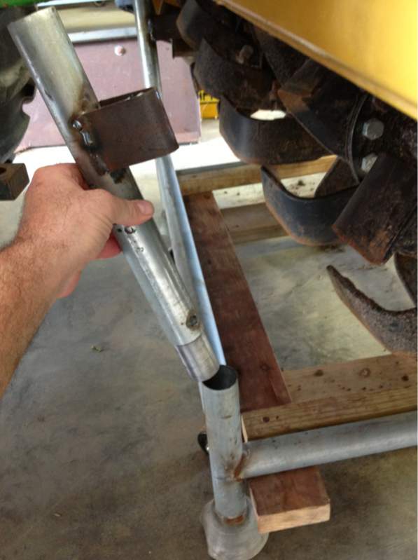

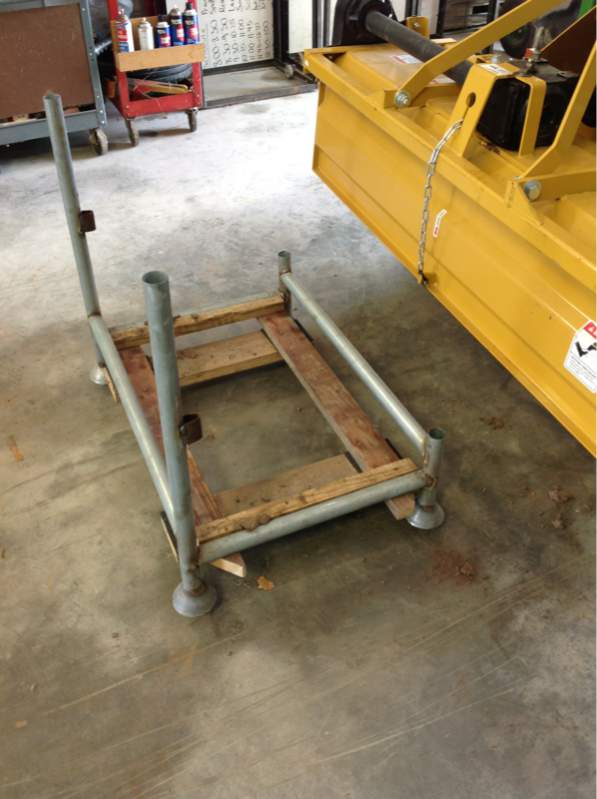

Nice job. You didn't mention safety. Less likely to hurt your back.
My county line tiller came with a freight forklift cradle. The 3pt lift was not enough to clear the cradle. I trimmed the uprights, cut 2and added pins and casters. Now I back the quick hitch up to the tiller and lift, remove the front dolly supports.
Anything you can do to keep an implement indoors is worthwhile.
Changing two bolt to longer, and a piece of chain hold the PTO shaft at correct height for backing in.
After the pictures were taken I removed the boards and welded casters to the cradle.

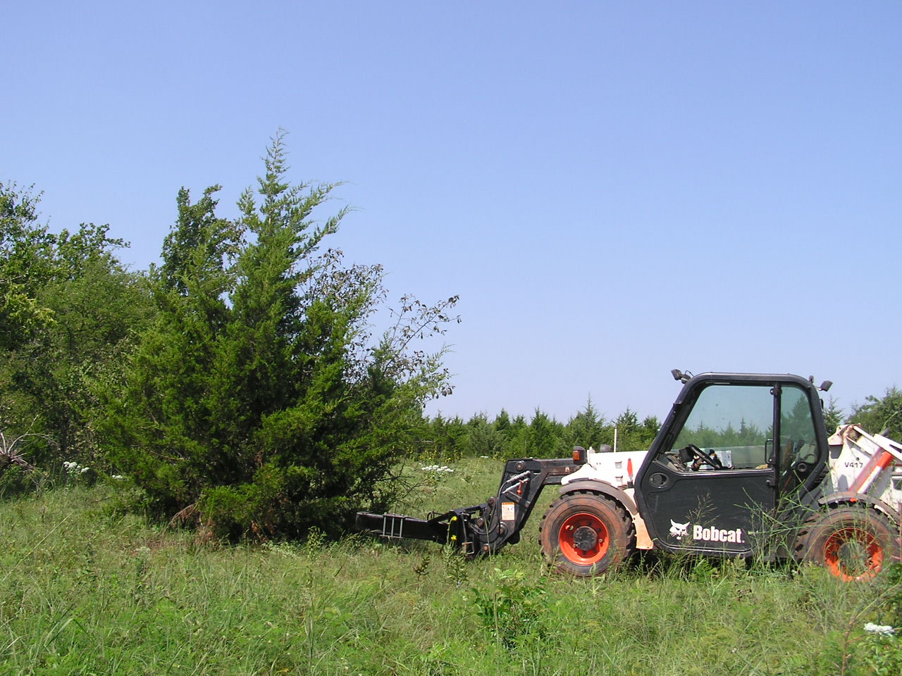

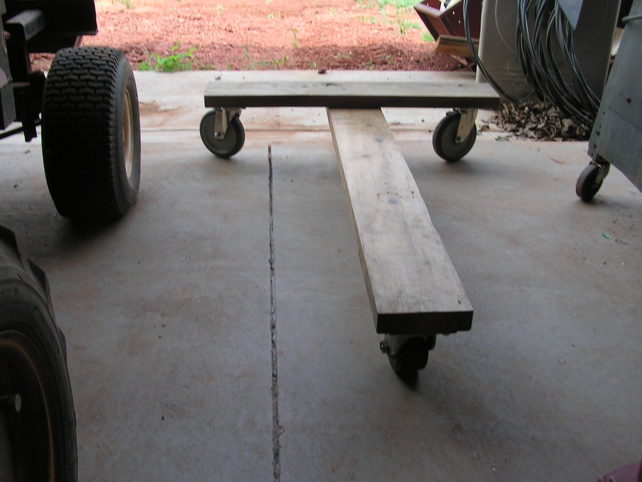

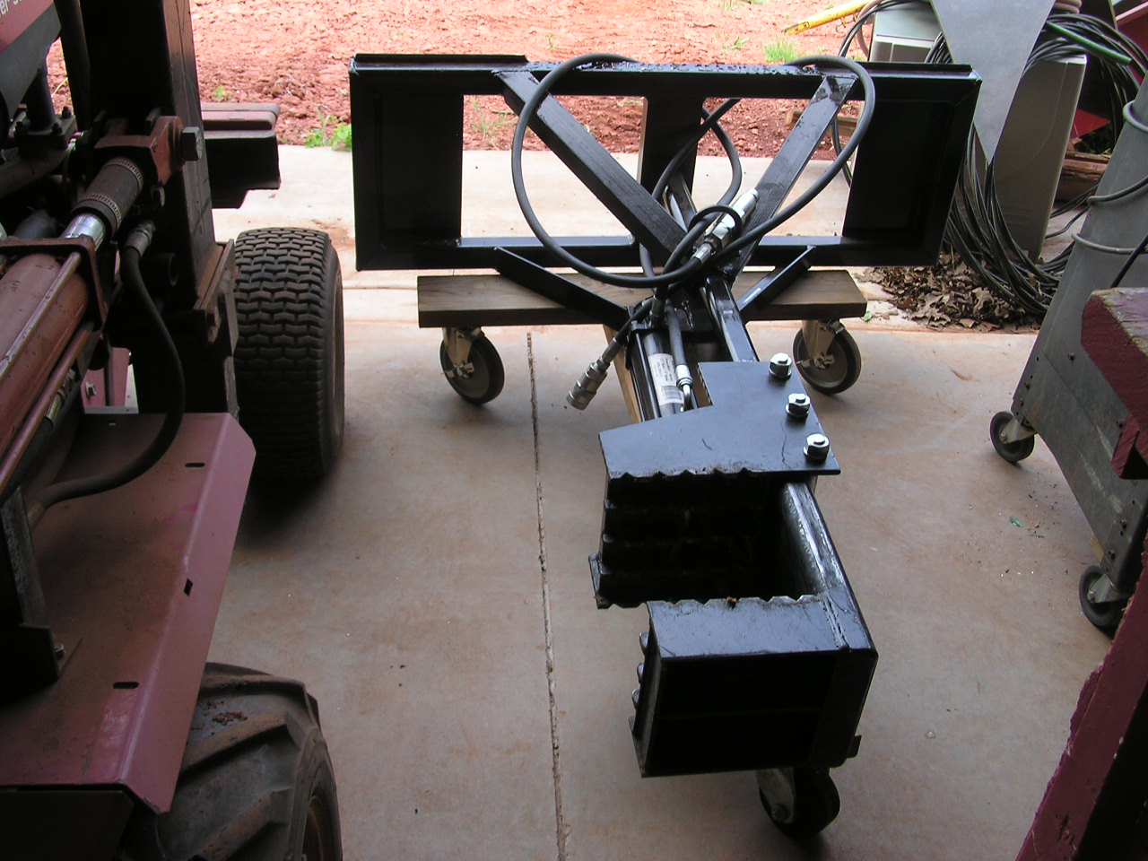

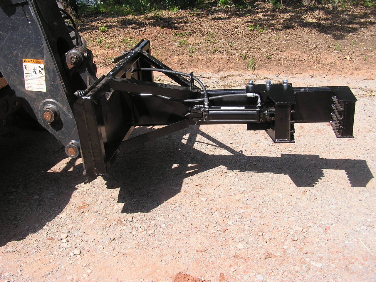

The long arm tree puller.

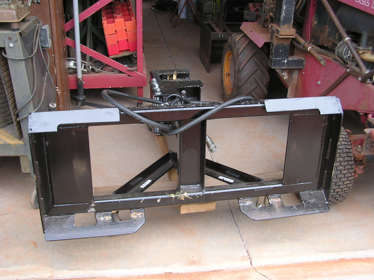

The three wheel dollie.
Wood works! :)

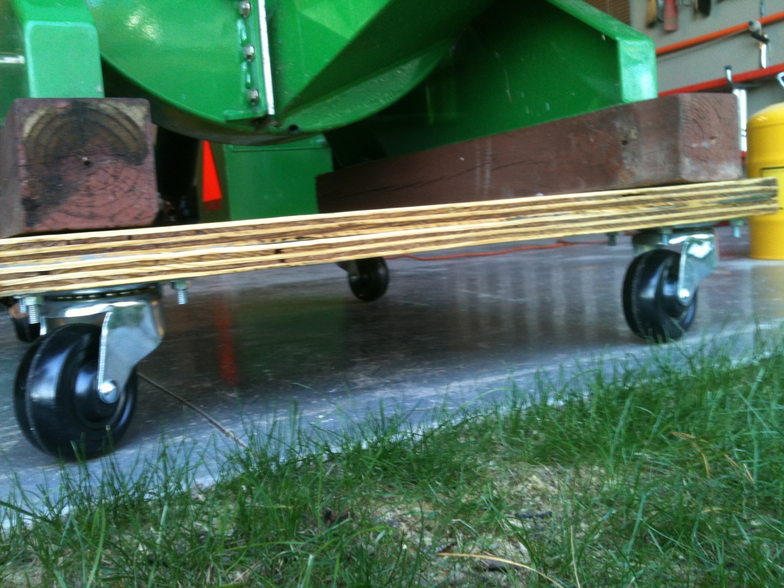

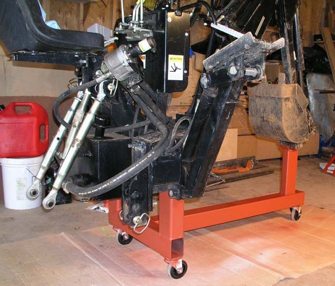

Best idea I ever got from the guys on this site. It's great to be able to ease heavy attachments around with little effort.

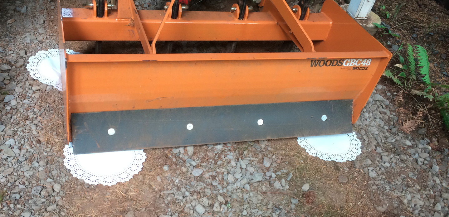

/ Implement dollies. #14

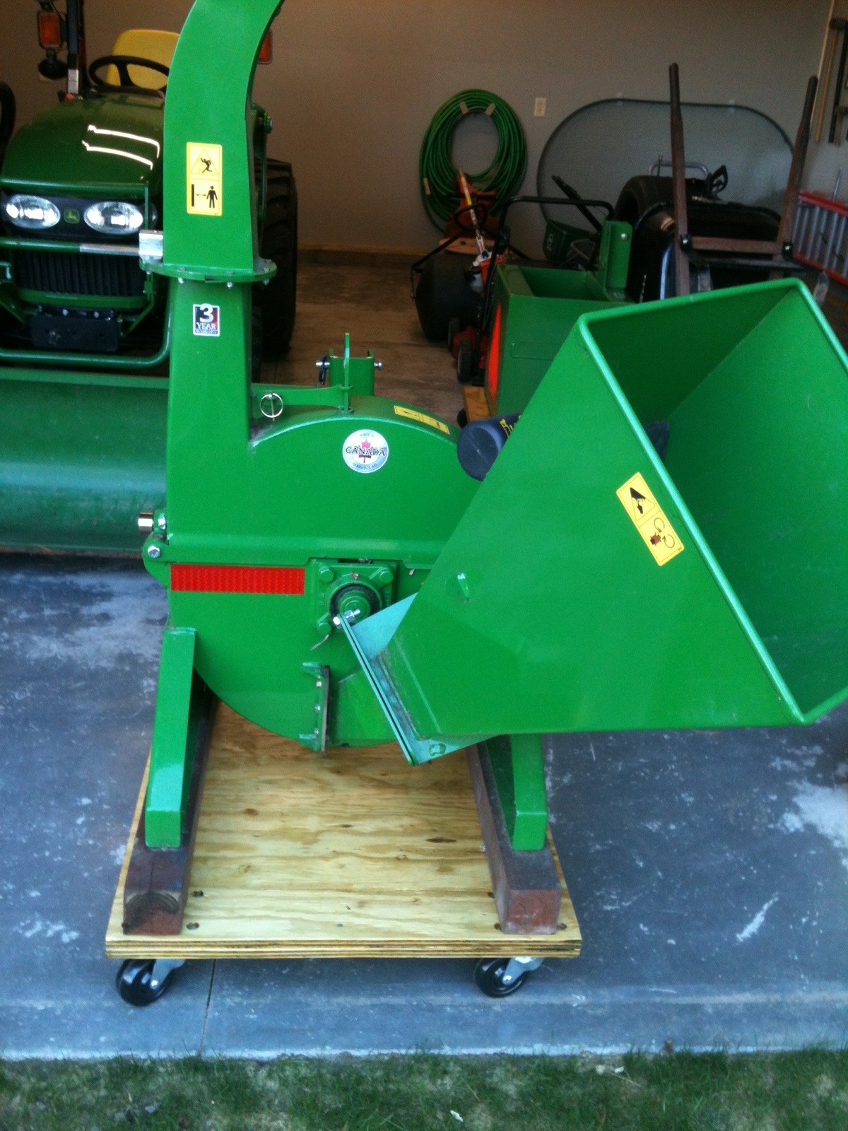

i didn't find that it made implements easier to move on either on gravel or concrete.
Bruce

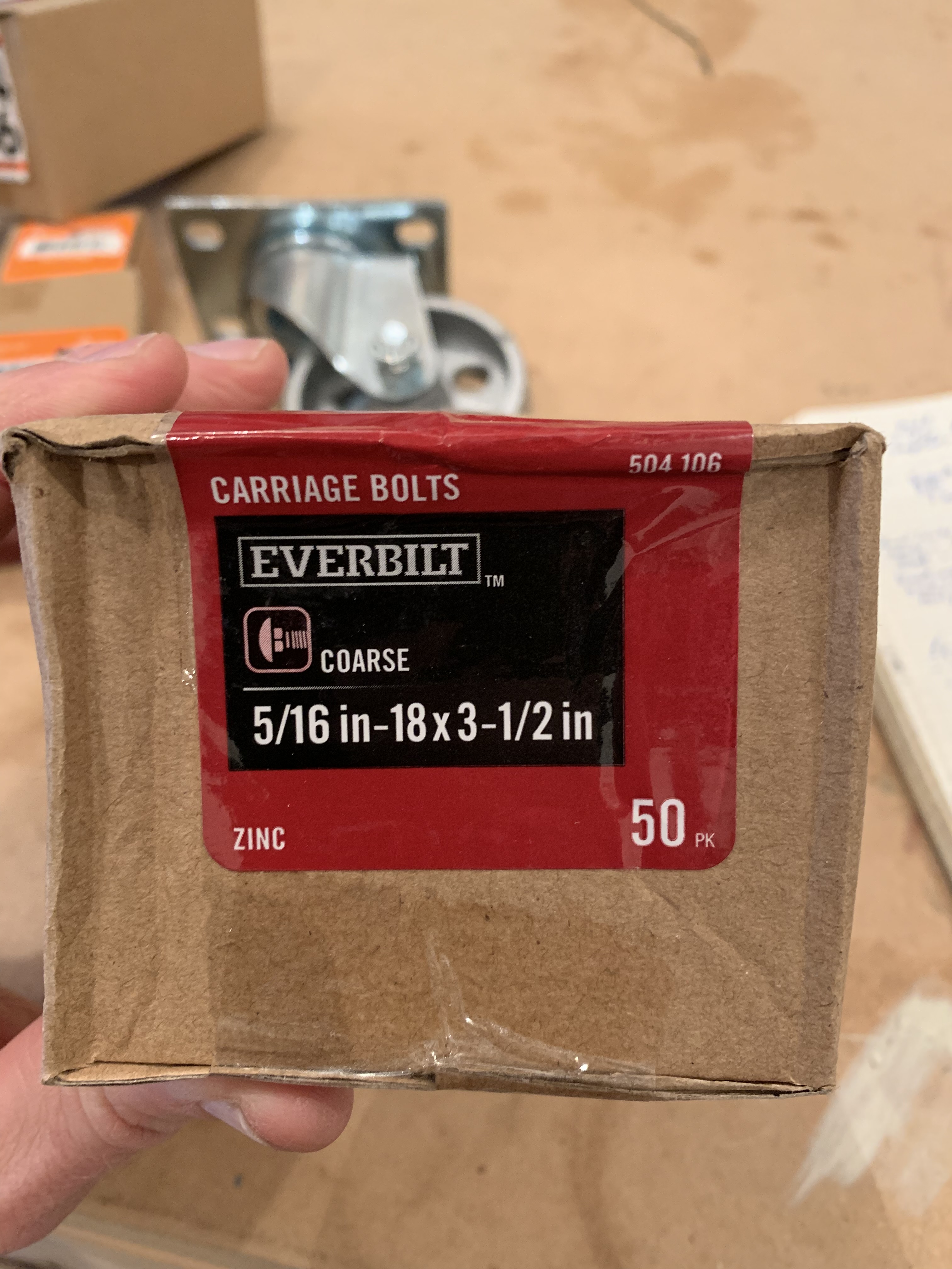

/ Implement dollies. #18

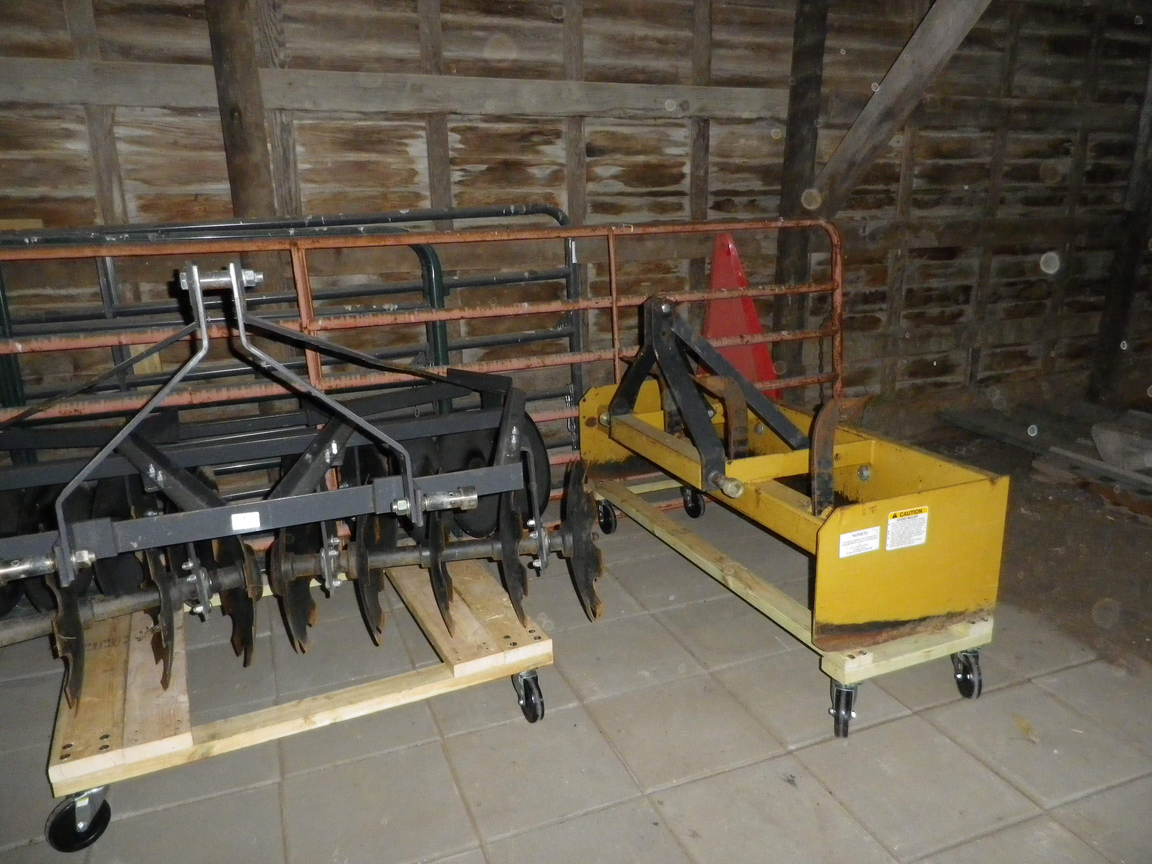

IMG_0156.jpgIMG_0157.jpgIMG_0158.jpgIMG_0159.jpgIMG_0160.jpgIMG_0161.jpgIMG_0162.jpgIMG_0163.jpgIMG_0164.jpg

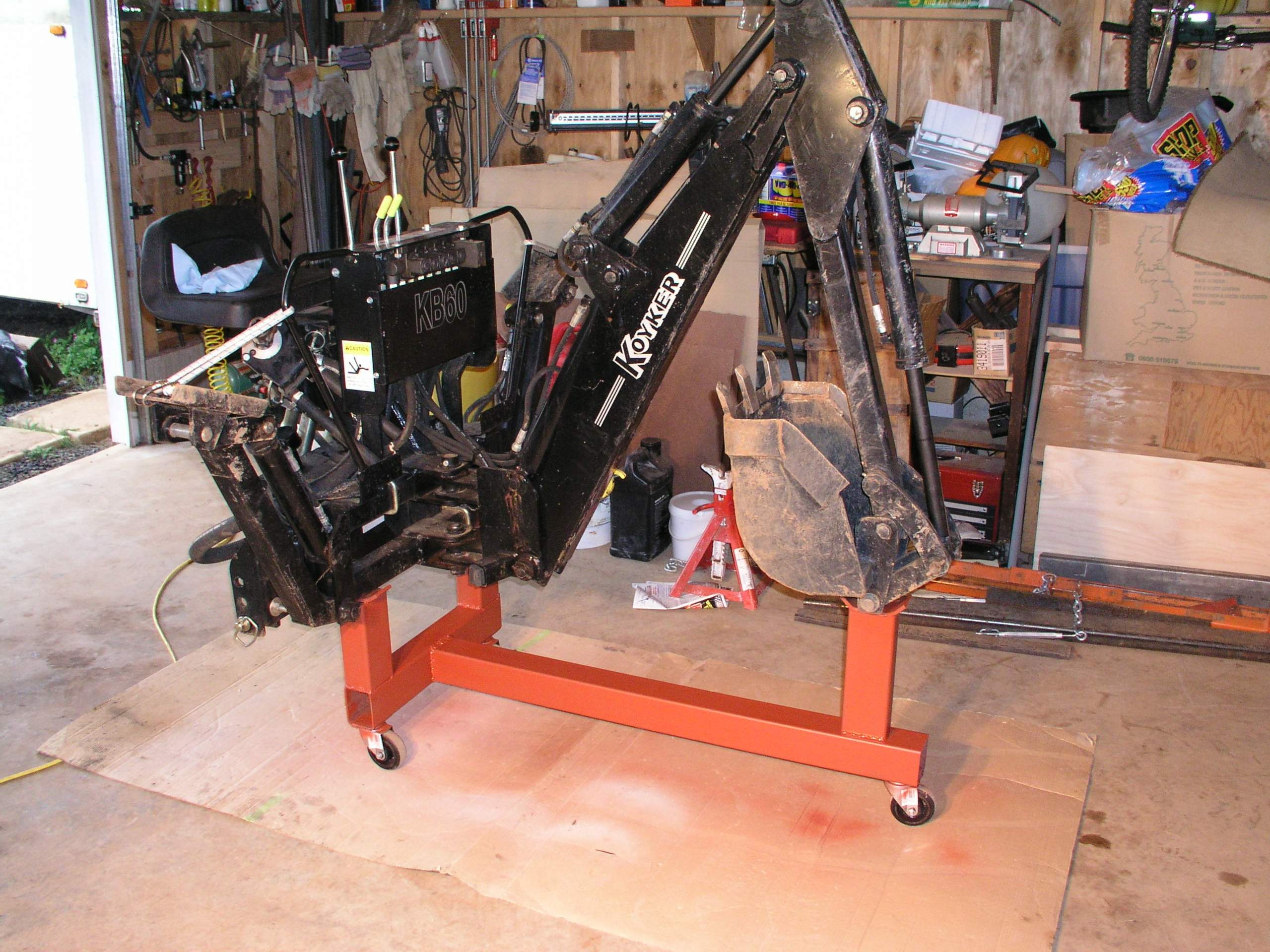

Here is what I used. From Home Depot:
3" steel wheel casters 300 lb each.
5/16 carriage bolts at 3.5"
5/16 nuts and locking washers.
2x6 lumber
I may end up adding plywood to the top, we will see.
The largest dolly is for my Grapple (920#) ..it is 6 wheels. The "T" shaped one is for my rear blade (700 #). The smallest one is for whichever of the bucket or PFs are not on the tractor. I know...pallet forks really? Probably didn't even need the last one, but thought it might have other uses as well.
I used the 4 carriage bolts to secure each caster. I had to cut a few of them to ensure the wheel rotated fully.
I am considering one for my Backhoe, but at 2200# it seems a bit much to have to wheel around. We will see how it goes over the next year.
