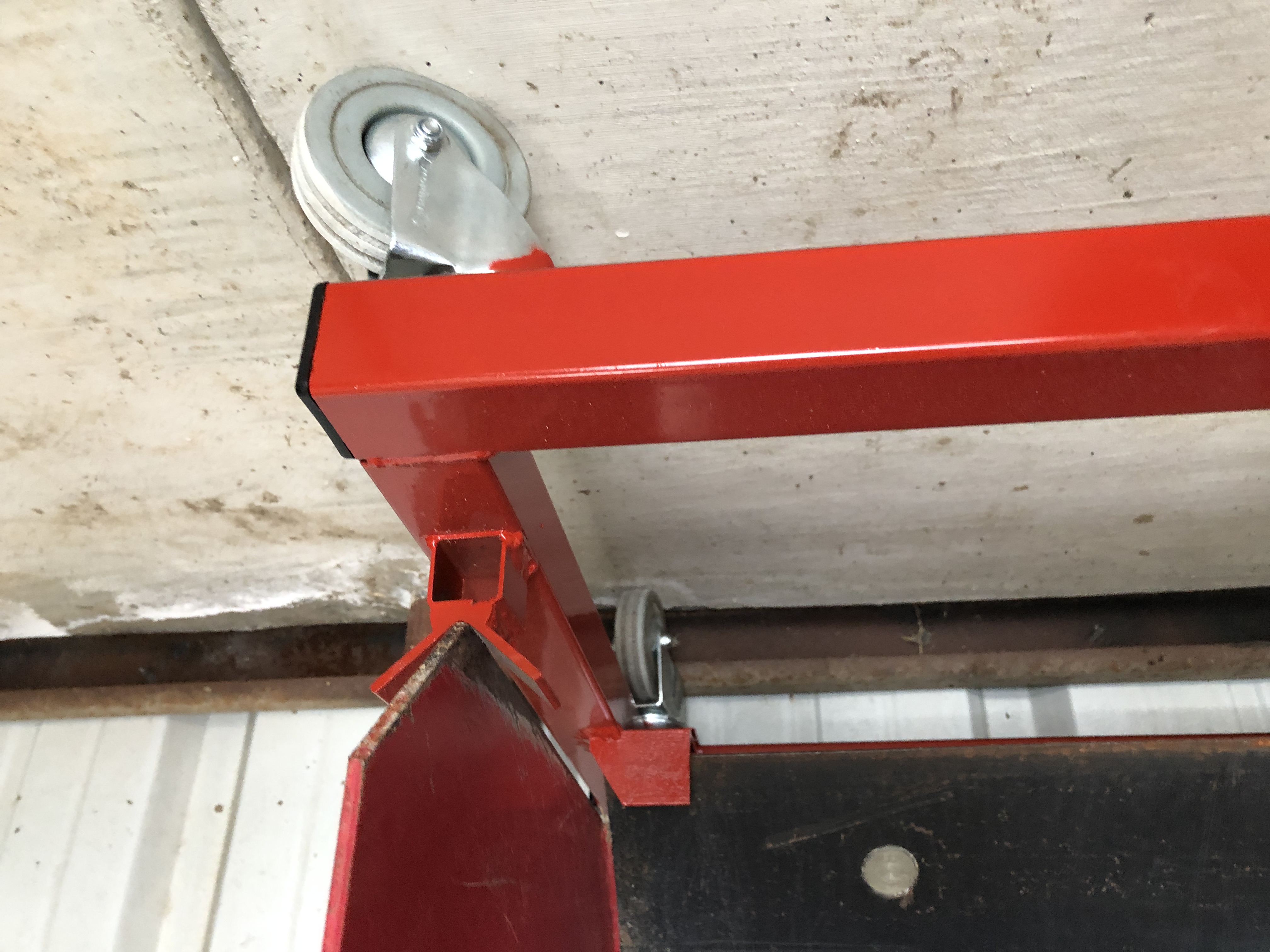

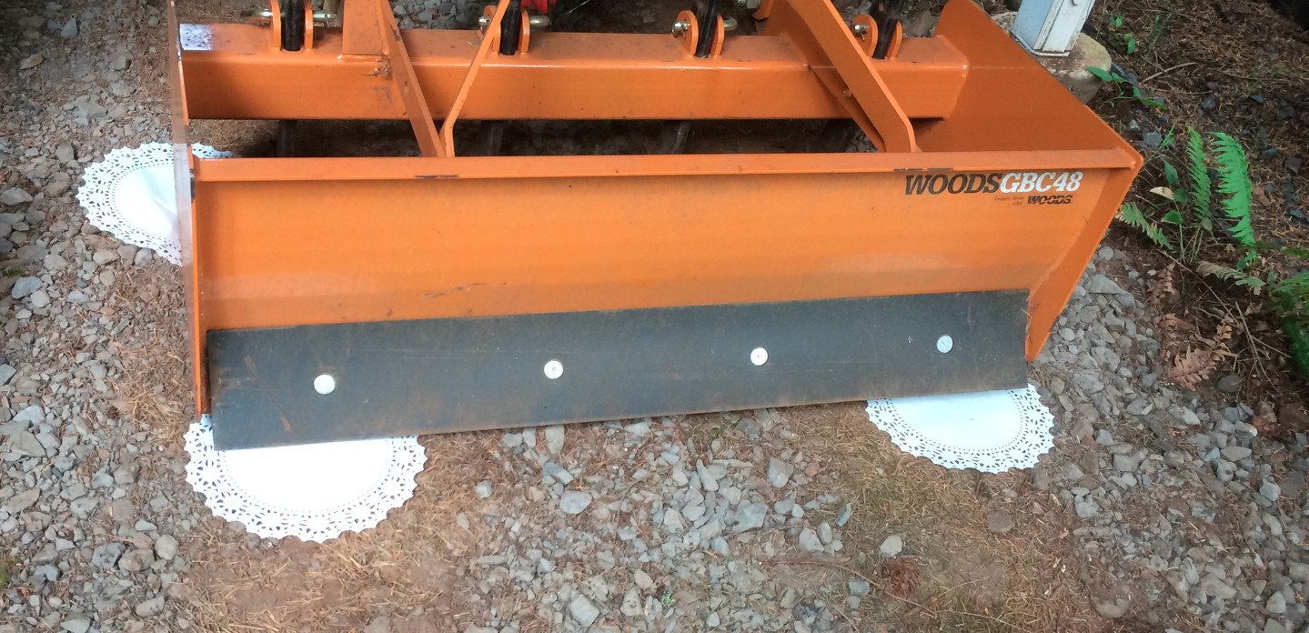

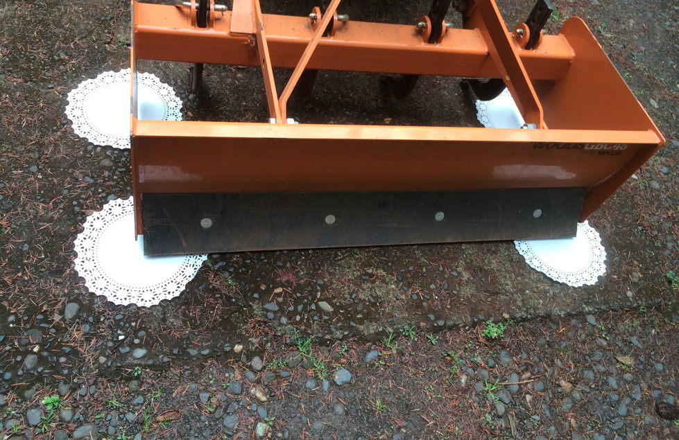

I havent really felt a strong need for a series of dollies but this one is pretty cool. Maybe all the matching OEM paint is just too convincing.
Is it top heavy?
Seems to be stable in all directions, pushing or pulling.
/ Implement dollies. #42
bmontini, my compliments for setting the bar high.
Thanks for the compliments guys..... I haven't fabricated too many items, yet, these are like items 10 thru 14 since I got my welder a few years back. One trick? Dri-Cut Carbide tipped low-rpm metal cutting chop saw. Makes them cuts square and smooth! Not OEM match unfortunately, just some Krylon 2-in-1 Gloss Red...

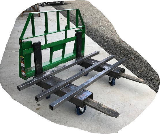

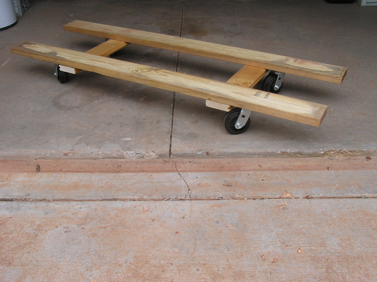

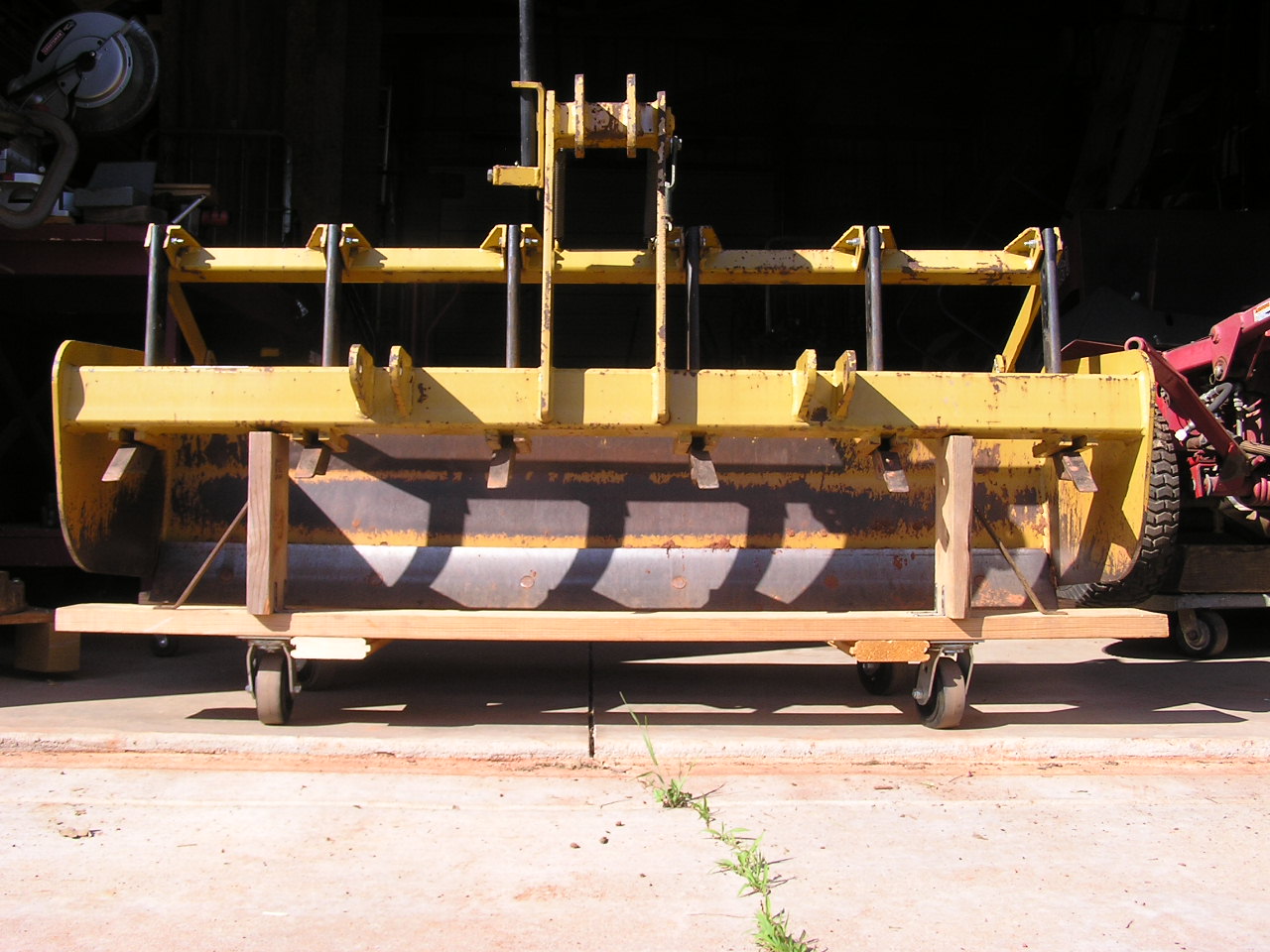

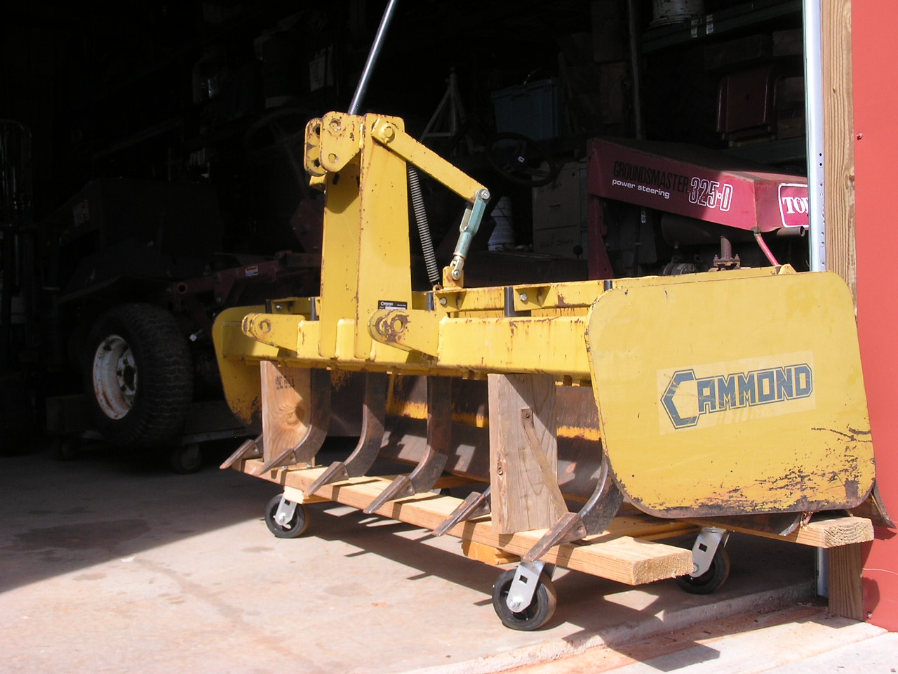

Have a B2320 so the implements aren't really that heavy. I bought 4 furniture dollies (not doilies) and configure them to use for the implements. I thing they were about $7 a piece. If you need just the casters you may be better off buying these since it's hard to find casters cheaper than $1.75 that will handle any weight.
/ Implement dollies. #46

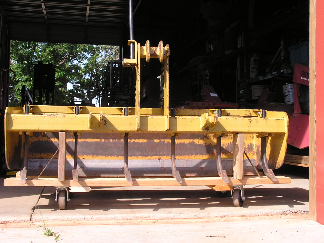

Did it after the first time when I just dropped my bush hog on the ground.
Now park them either in carriage house or garage with dollies under most. One similar to a furniture dolly is good enough for the Mac chipper/shredder. Just castors underneath the carryall do. Use a 2x6 with 3 METAL castors underneath both ends of it for the front end of the bush hog. The back blade is light enough to manage without anything. Prop it up against the garage wall in front of the Tacoma until bad weather is forecast.
Ralph

I've built a number of dollies. All have used poly wheels. Every time I buy a set I wonder about the steels wheels. I see most photos are poly. Anyone have both types and do they prefer one over the other?
I don't need to move things often when it's cold, but do enough that the biggest issue I have in Minnesota right now is the grease in them (when purchased) gets very stiff when at below freezing temps, My barn is not heated. Is there a way to condition them in the warmer months to get them to turn a bit easier in the winter months? I was wondering if I could add graphite powder or something to them and try to work that in.

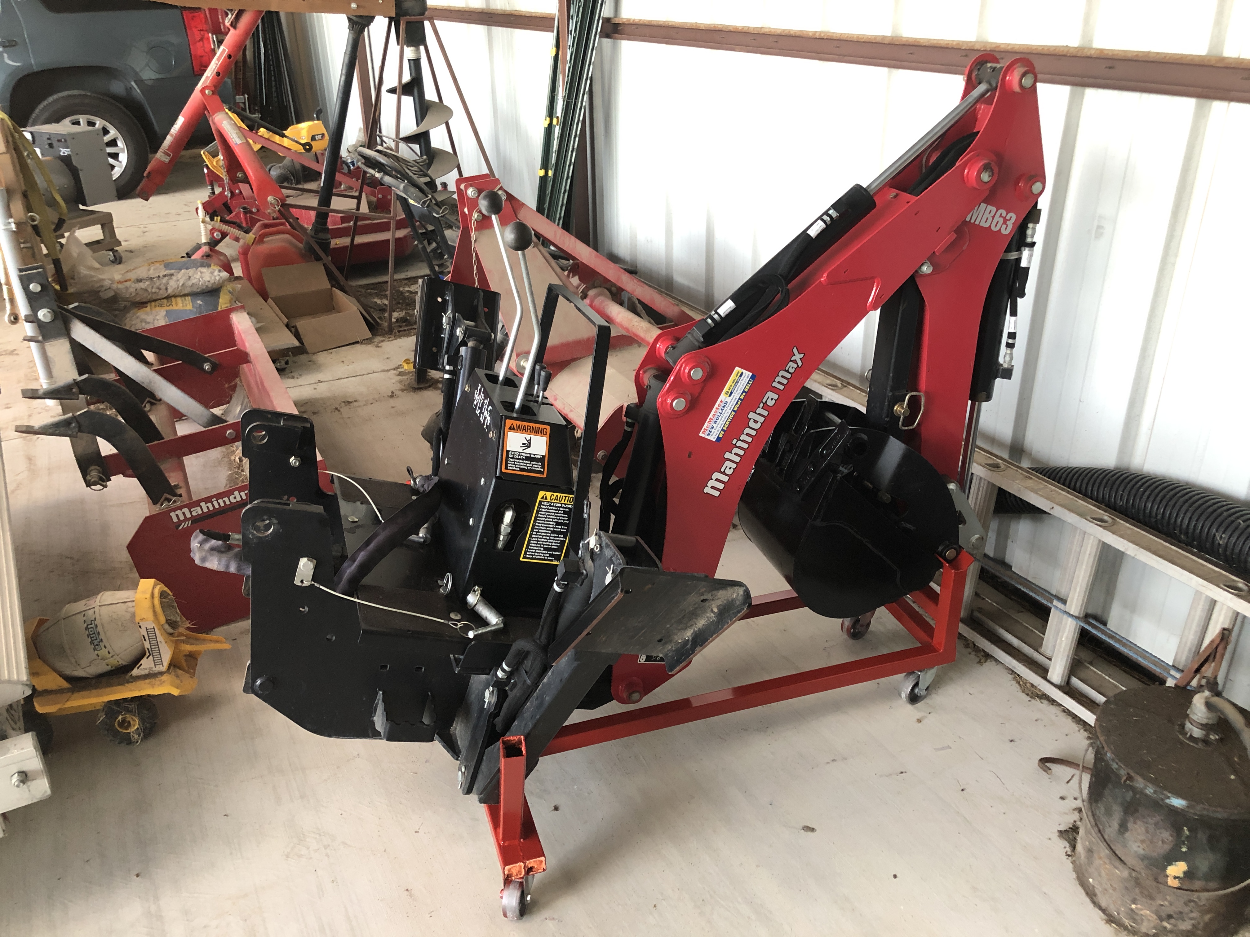

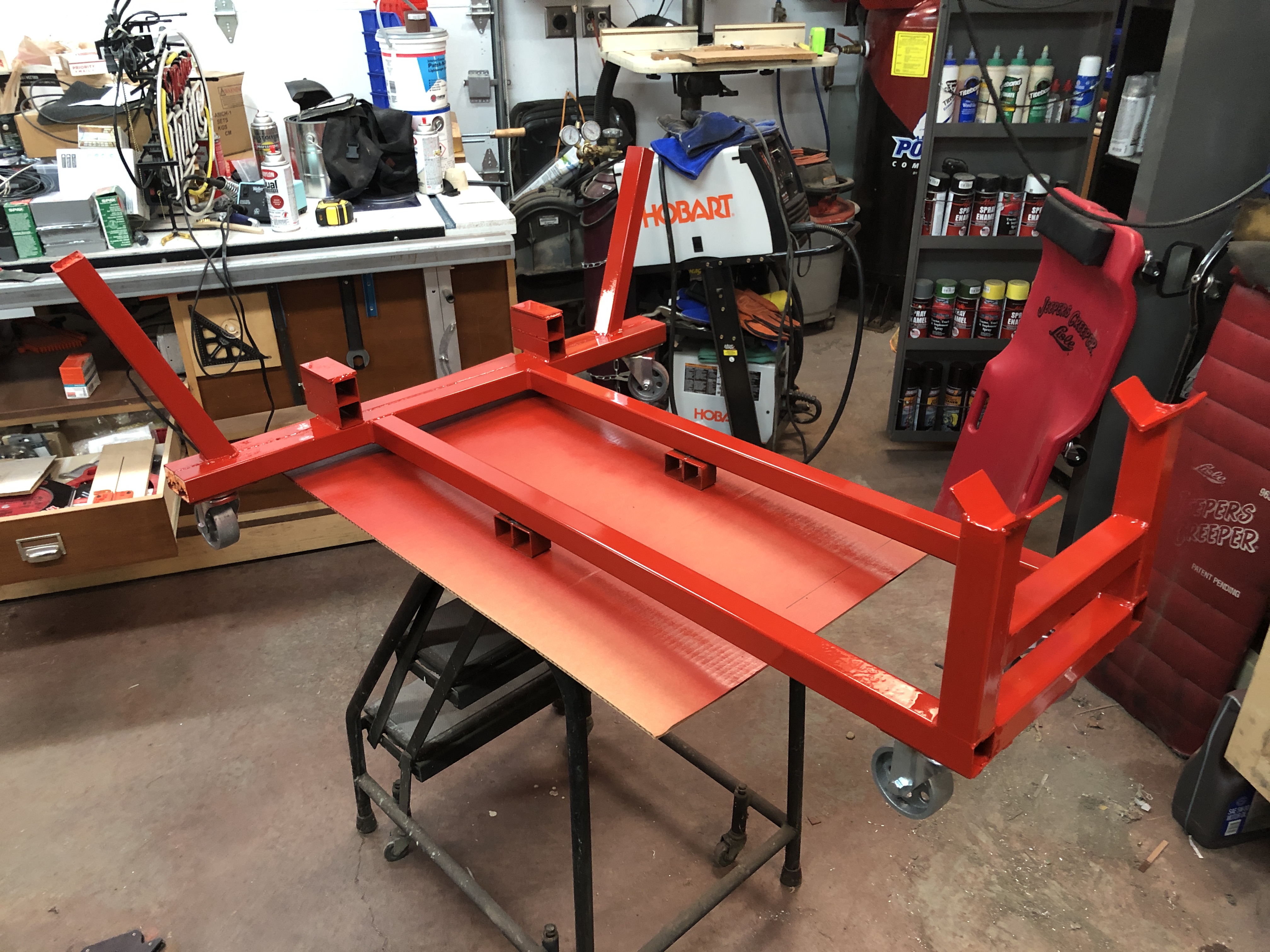

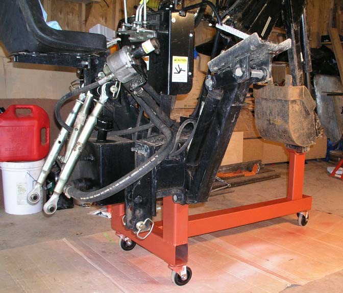

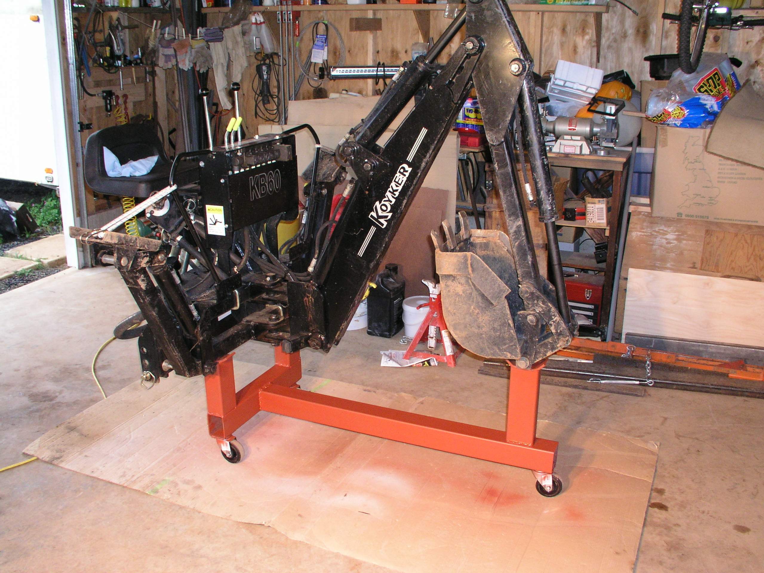

New Tractor & Backhoe means a NEW DOLLY! Based on my original design posed back on page 3, and some mild changes... No bucket pins I could "grab" with some basic angle iron, so a more complex "landing pad" had to be designed. New backhoe is 1100lbs.
Roll it right up to the tractor, not top-heavy at all.. rolls well...
Front view
where a bulk of the weight sits.
Fun stuff!
