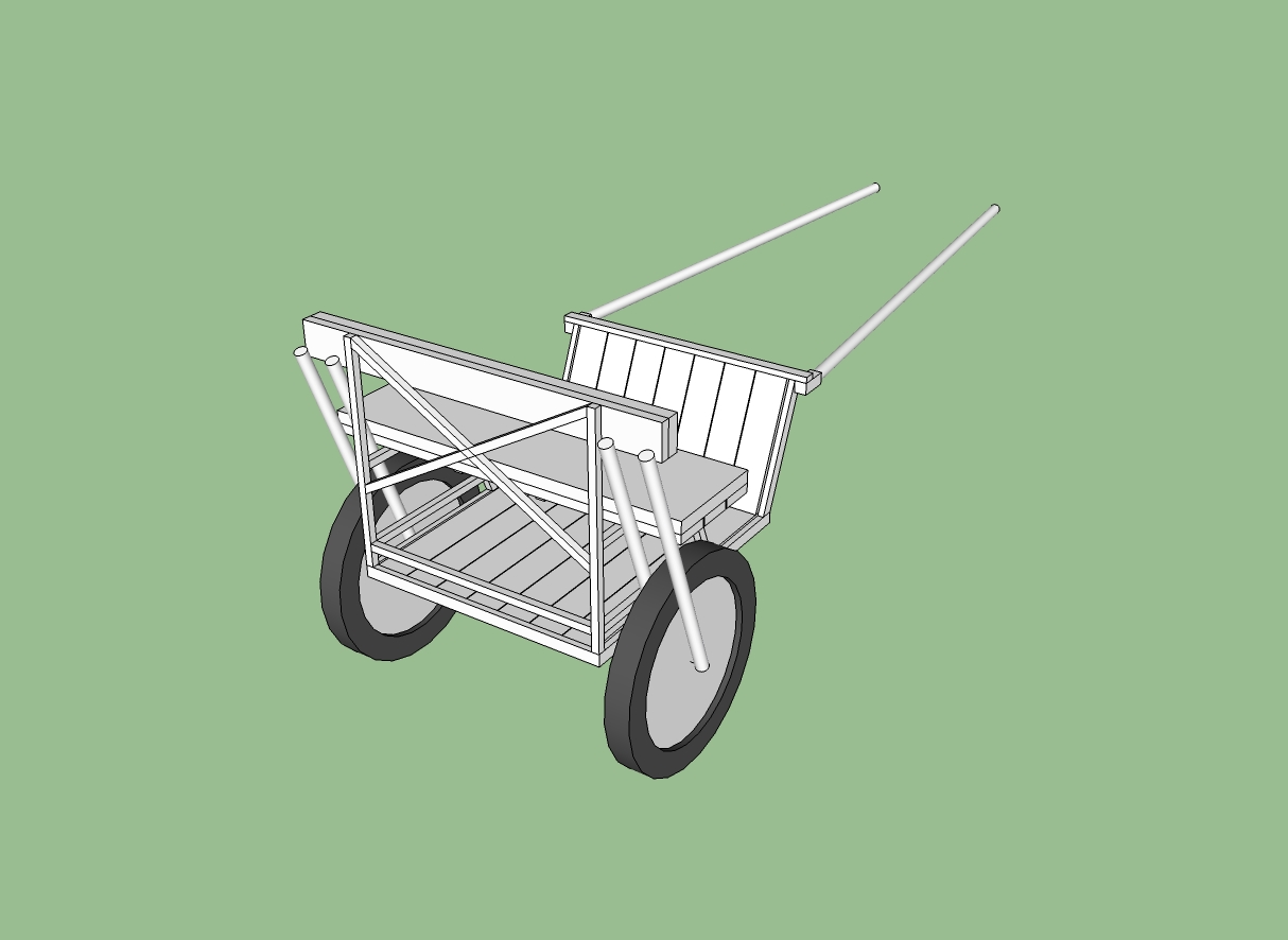

I'm planning another build. I invited my dad and brothers to come on the day after Christmas to have a project party and build a two wheeled horse cart. Between us there are a half dozen horses or so that we'd like to train to pull. Dad has a NICE carriage, but we don't want to hitch the young ones to the high dollar carriage. The goal of this project is to spend time together more than anything, but if luck holds out we'll end up with a nice cart to share between us.
I have most of the materials laying around from various projects. The Wheels will be from motorcycle forks I got when I traded an old parts bike that was my youngest brother's. The frame steel is from some ATV shipping racks that another brother got when he worked at a dealership. The wood is left over from my porch railing. I bought some foam rubber and some vinyl to do the seats, and I bought a few sticks of steel for the shafts and braces, etc.
Since you all have been so helpful on other projects I've done, I thought I'd post the plans here for critique and feedback. If the basic build goes well, I may end up adding a receiver hitch on the back and hydraulic brakes. The shafts are designed to be removeable. This will make the cart easy to transport in the back of a pickup truck. We'll also likely build a tongue someday to allow hitching a team.

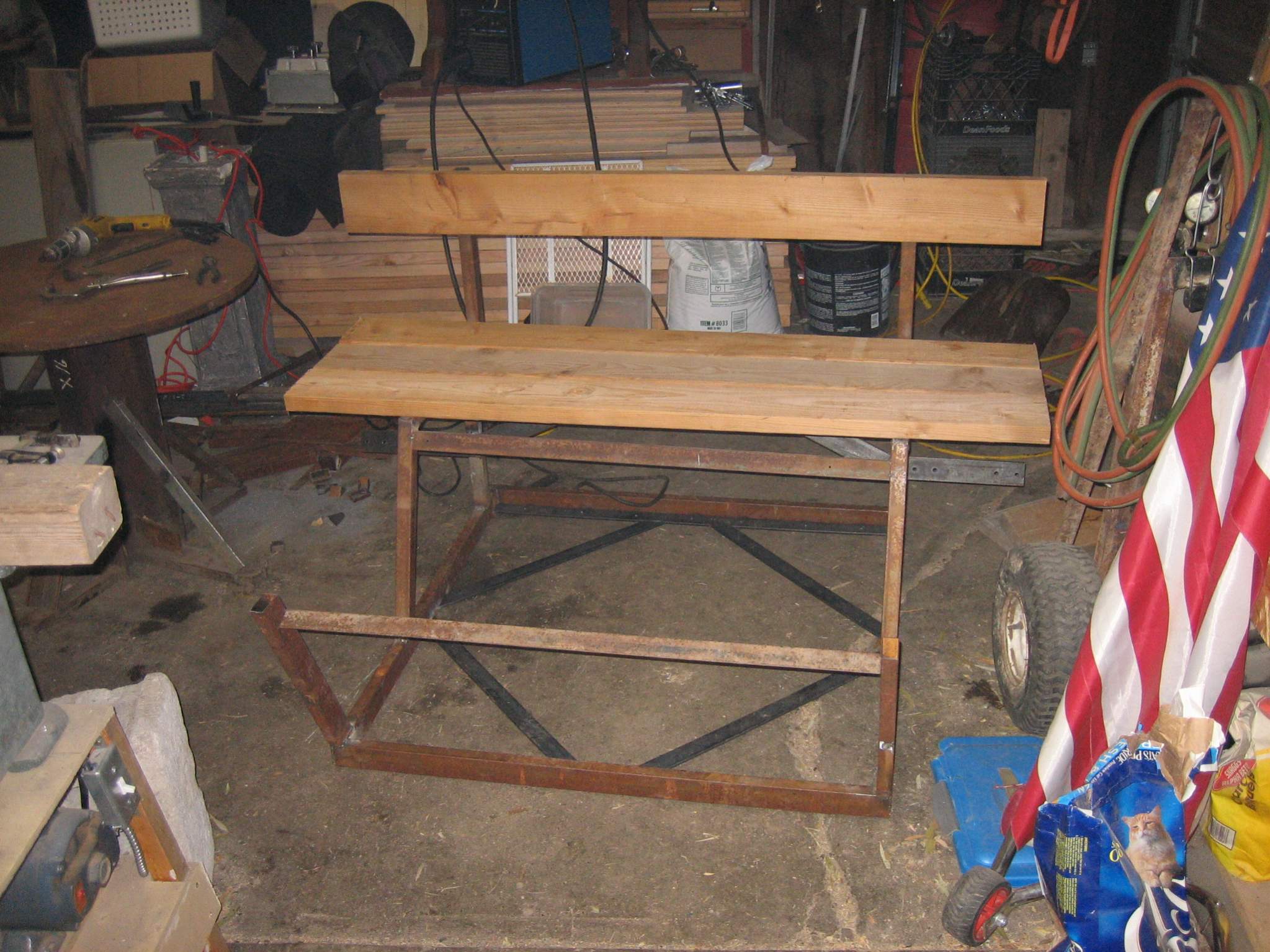

True to predictions, we started building today. I think my dad and brothers were a little frustrated that we didn't make more progress than we did. We got a great head start, though, and I think I can finish the rest in good time on my own.
There were four of us working. Cutting pieces was the bottle neck. There were times when three of us would be waiting for the next pieces to be cut so we could drill, weld, etc. We were making cuts according to the angles needed rather than in the order we needed them. The result was that I have a bunch of pieces already cut for the next time I get a chance to work on this project.
Here are some pictures of what we got done so far. The first picture is of the completed mounting frame for the wheels. The second picture is the pile of some of the parts we got cut.

Another note about the welder in case it helps someone else out...
Toward the end of the day my Millermatic 135 wire feed welder started developing a mind of its own. It would not always shut off when I let off the trigger. After dinner when all of my crew had left, I took some time to tear it apart and figure out the problem. I found that the connections to the trigger switch had frayed a bit. I'm assuming that some of the frayed ends were making contact with the other terminal and activating the welder. I taped the frayed ends and put the gun back together. I haven't welded with it yet, but it's not feeding wire unless I press the trigger.
