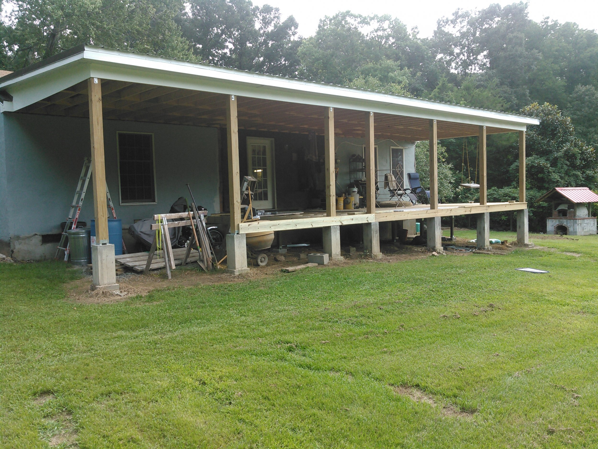

I built an implement shed that is 100’ long. Over that 100’ it drops about a foot. I built the shed level. I built the columns for the shed the exact same length and used sono tubes for the footings. On one end they are almost flush with the ground and on the other they are sticking out of the ground a foot. I used a rotary laser level to set the sono tubes at the same height.
That's how I did my porch - but I used square wooden forms.
