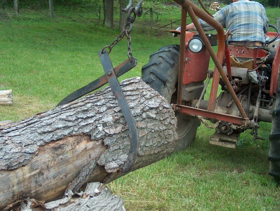

How do you attach the sling to the tires? I was looking at pictures of the wheels and they have no holes in them other than for the lug nuts and center hub. You could put the chain through the middle and pick it up but you can't hold it up this way and slide it on the hub because the chain would be in the way.
   / Implements narrower than tractor #15

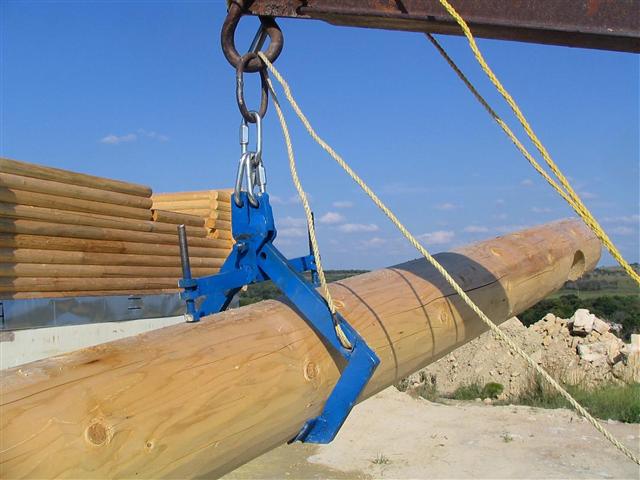

Are there any bolt holes for wheel weights? You could bolt a chain over the tire to the other side of the wheel.
Or use some tongs.
