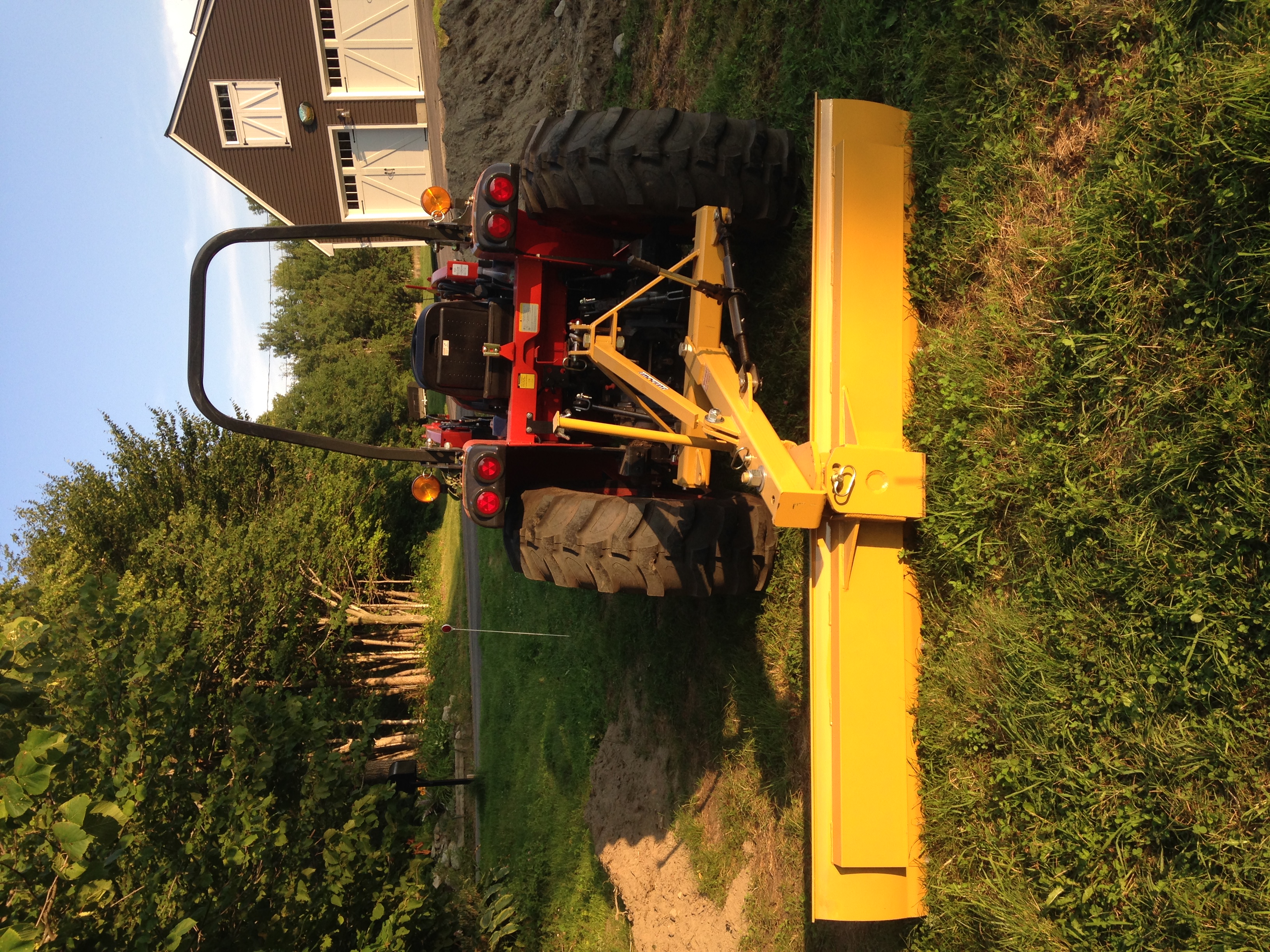

So far my northern tool quick hitch has only sat in the shed - won't fit the finish mower or counterweight barrel, and I rarely use my back blade which I never use lately.
Matter of fact, I haven't used my back blade since my summer project year before last, seems like overkill for my little driveway in the winter too.
Maybe it's time to sell em? Anyone looking for a quick hitch or a 84" heavy duty back blade?
