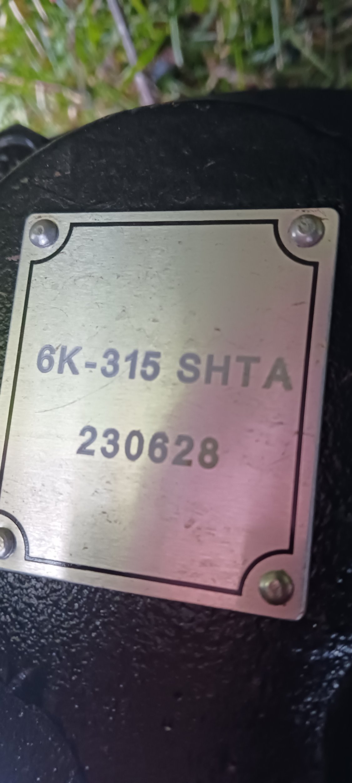

I too have noticed my L12 does not seem to runaway downhill. when on the ramp of my trailer it lost hyd pressure and would not move. I shut it off and moved the sticks around to relieve any pressure and tried to pull it off with the Gator. wouldn't budge. Got my lil old Kubota hooked up and drug it off the ramp. maybe upgraded wheel motors on the L12??? 20231125_165118.jpg

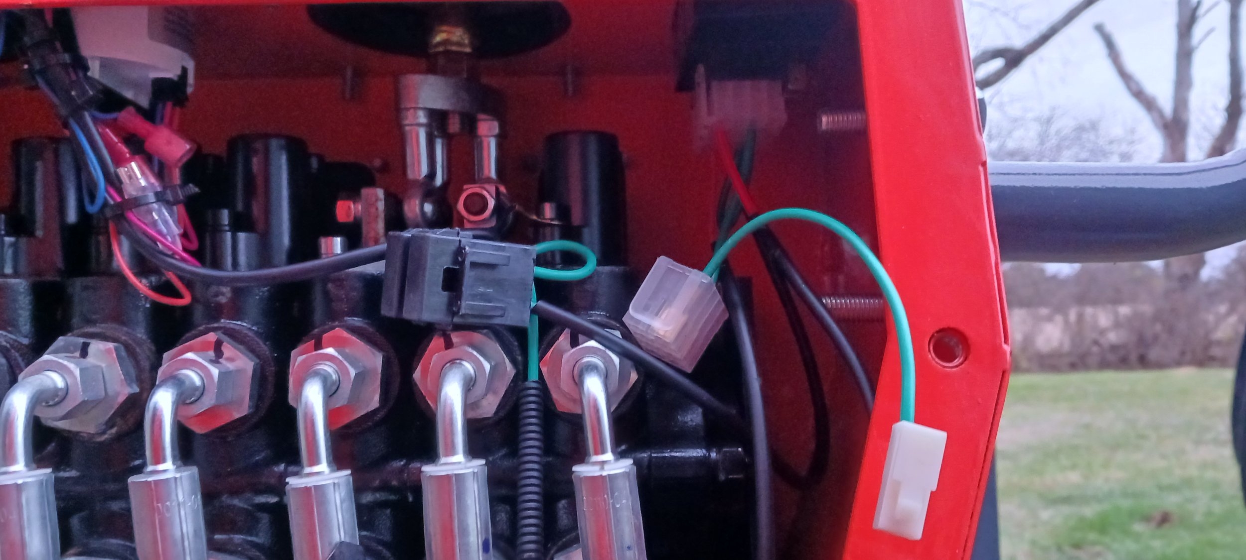

It may be possible to add another valve to the stack. I think there are 8 valves on the stack now. if you remove the 8
-12mm bolts on the access panel, you can see your stack and how much room is available. I didnt know you needed 2 aux valves for the hammer
