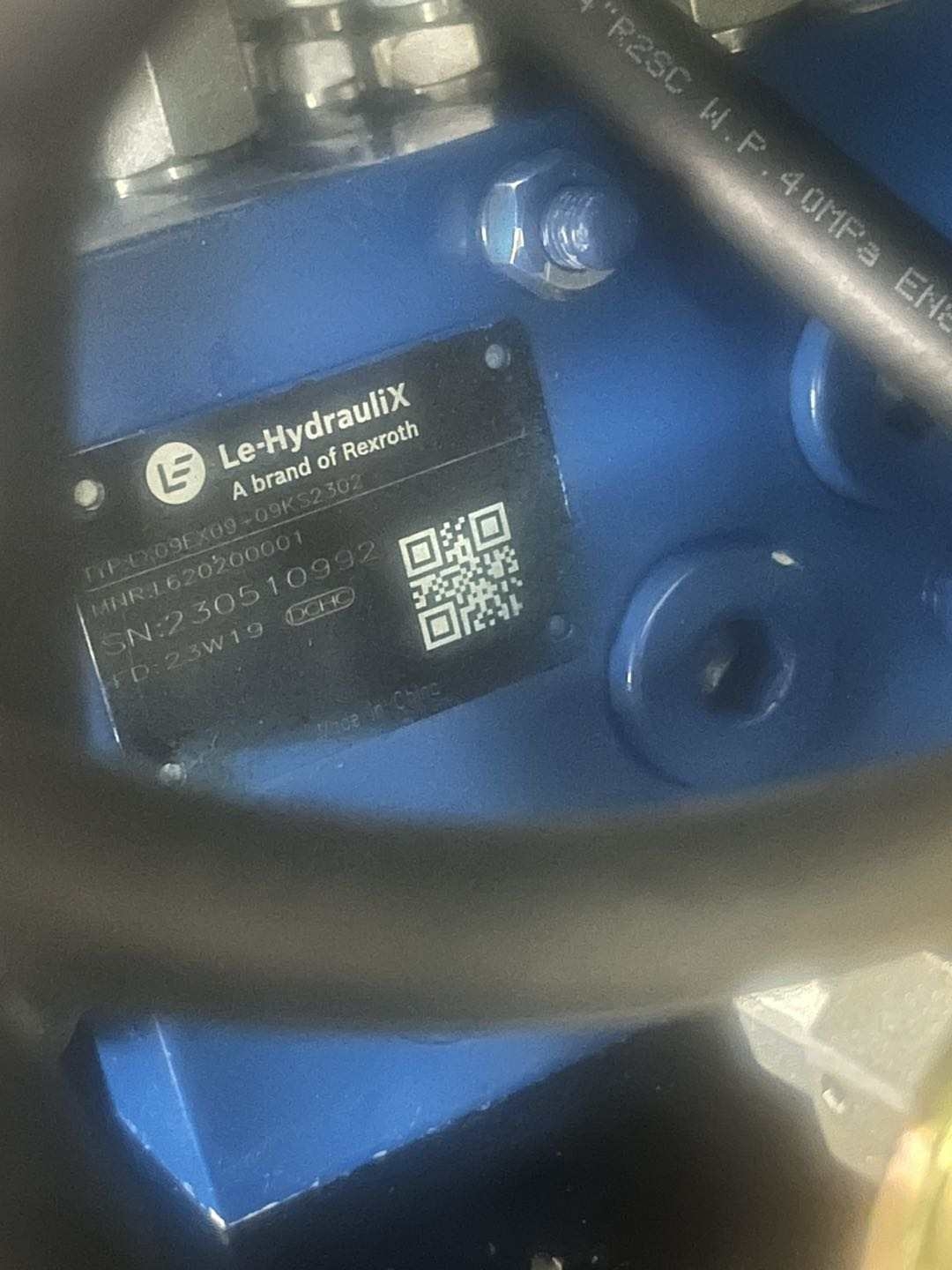

Hey Fredrik, couldn't figure how to attach pdfs so just posting here.
Leking pricing fob unless noted:
kv13p. briggs, pilot, 1100kg. 4200$. (~6600 ddp)
kv18. add d722, 1200kg. 40lpm flow. 6800$
kv18p. 1500kg. Slightly larger tracks/base 7500$
kv18p. add 2 speed, d902, 8140$
Kv20. add yanmar 3TNV80F, 2 speed, rexroth 60lpm flow (piston). 12,200$. Would be about +4400 for DDP is my guess. No attachments!!!
The others like ltmg and leite were pretty comparable.
12k ddp sounds awesome. I would hazard a guess it might be closer spec'd in real life to leking kv18p?
Compare measurements, weights, hydro info?
Personally, I look 'gift horses' in the mouth hahah there aint no such thing as free.
As far as DDP, it's highly unlikely the would (or could) add any new change/charge once they've commited so I'd feel good about that with alibaba protection.
More reach and weight, faster travel, and diesel power would be nice but nah for now I'm sticking with this kv13 plus. The mods and adjustments have made it super usable and pretty dam capable.
kv20 rexroth pump 60lpm. Couldn't find a trace of it online though. Behind language barrier wall on WWW probably.
