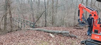

It seems like I will be doing more cleanup on the trails with the baby digger than I thought. Will be pulling a lot of logs out of ravines before they cause problems to culverts and bridges. I would like to weld a hook or a D-ring on the bucket, but I need to ask,, Is the bucket strong enough to handle the hook? I am leaning towards a d-ring, what's your preference 20231222_135200.jpg?
This photo shows what I use: a slotted piece of 1/2" steel, welded on. It is the same as the one I installed on my homemade bucket, which I showed in my Modifications thread.
I use these on my other buckets, including loader buckets. The idea is that chain fits in the slot securely, and allows pulling in multiple directions. It even allows me to detach it without getting out of the operator's seat.
For the mini, I also use straps in the slot for pulling logs or rocks. The bkt carcass is only 1/8" thick, so install any hook on the thicker sections, and/or add a base plate.

It seems like I will be doing more cleanup on the trails with the baby digger than I thought. Will be pulling a lot of logs out of ravines before they cause problems to culverts and bridges. I would like to weld a hook or a D-ring on the bucket, but I need to ask,, Is the bucket strong enough to handle the hook? I am leaning towards a d-ring, what's your preference?
Hmm.. gives me a thought. For those of us a quick hitch constructing a lifting ring welded to a base plate that would have pin arrangement like a pin on standard attachment. Should not be that hard to build. This would allow a distributed load at the boom end versus a chain hook on a bucket.
Not sure if I will build one but thanks for the inspiration.
Very nice.. I like the self-detaching bonus. My bucket seems a little thin so I will beef it up a little. I don't imagine my little machine can put too much stress on anything, but I like things that are over-built. I am going to go back and reread your entire post. it has been a month since I read it and I obviously forgot a lot of the info in it. Thanks again for making this thread, and thanks to Mattb4 for his thread.. Merry Christmas to all who read this..
