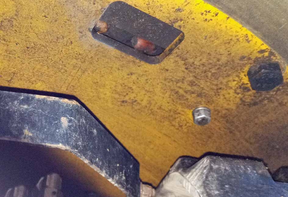

Well, it's time for an engine oil change, and Rhinoceros was nice enough to provide this drain hole in the base of the house. Looks like I have rats. Nuts. :-(
I think they get in around the hyd hoses entering the house from the boom. It is a good time to do some more inspection of hoses for rub wear, and protection.
Plus, I need to get underneath to replace a leaky blade hose.

Interesting,, My L12 has what appears to be the exact same drain hole. The drain for the engine oil misses the cutout by a few inches so I may install a flexible extension hose. I had oil running everywhere when I changed it.

You can try my tipping trick. I tip the whole machine on a slope, then open the drain plug, insert a hose, then tilt it back up to drain.
I fantasized about installing a drain valve, like you see on some riding mowers. But I just could not get it to fit. So my machine has had some spills inside the house. At least that makes it less attractive to rats.....

I remember seeing your method in pics. I think I have a place with a similar slope that maybe ideal, thanks for the reminder.!
