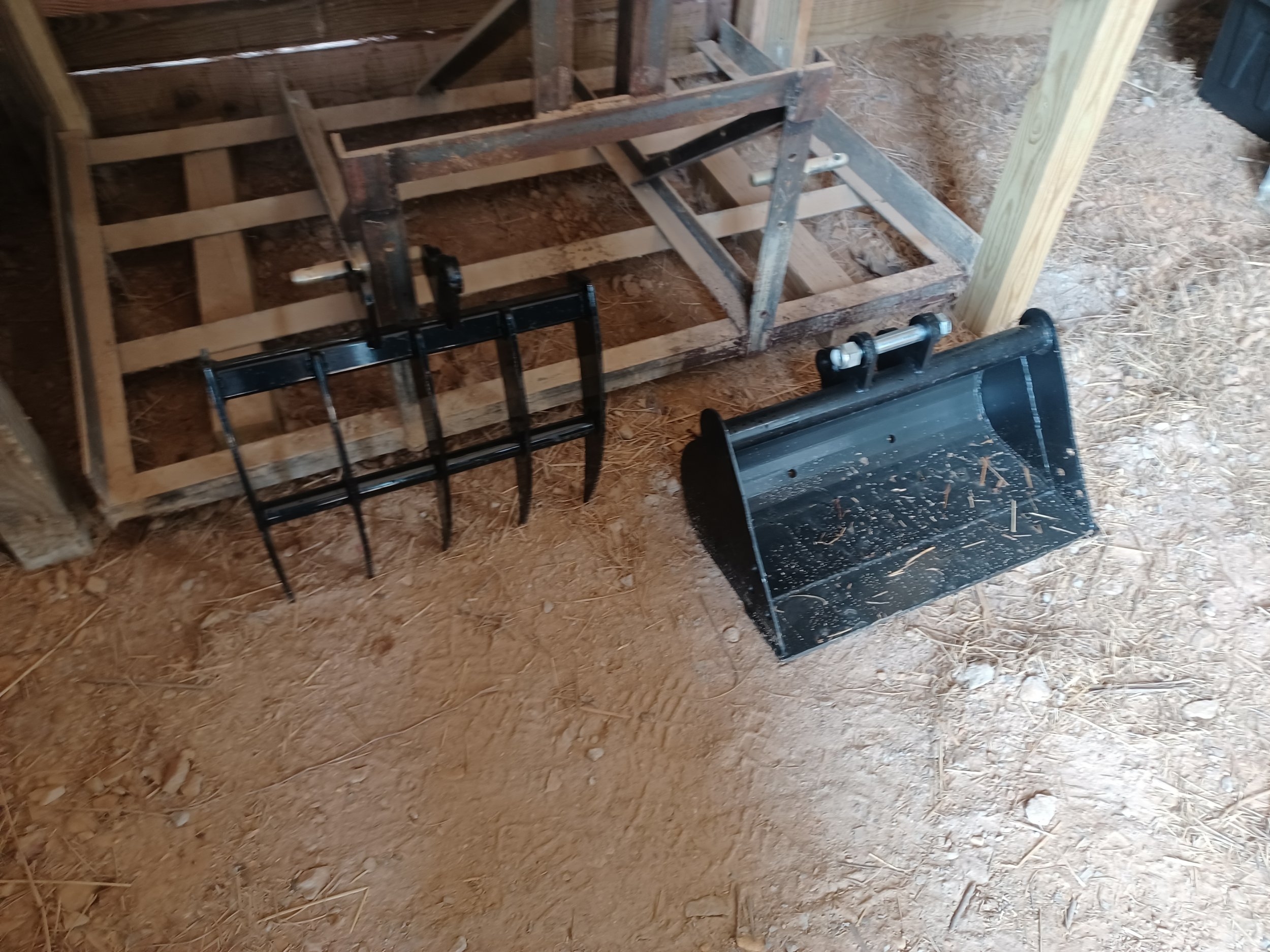

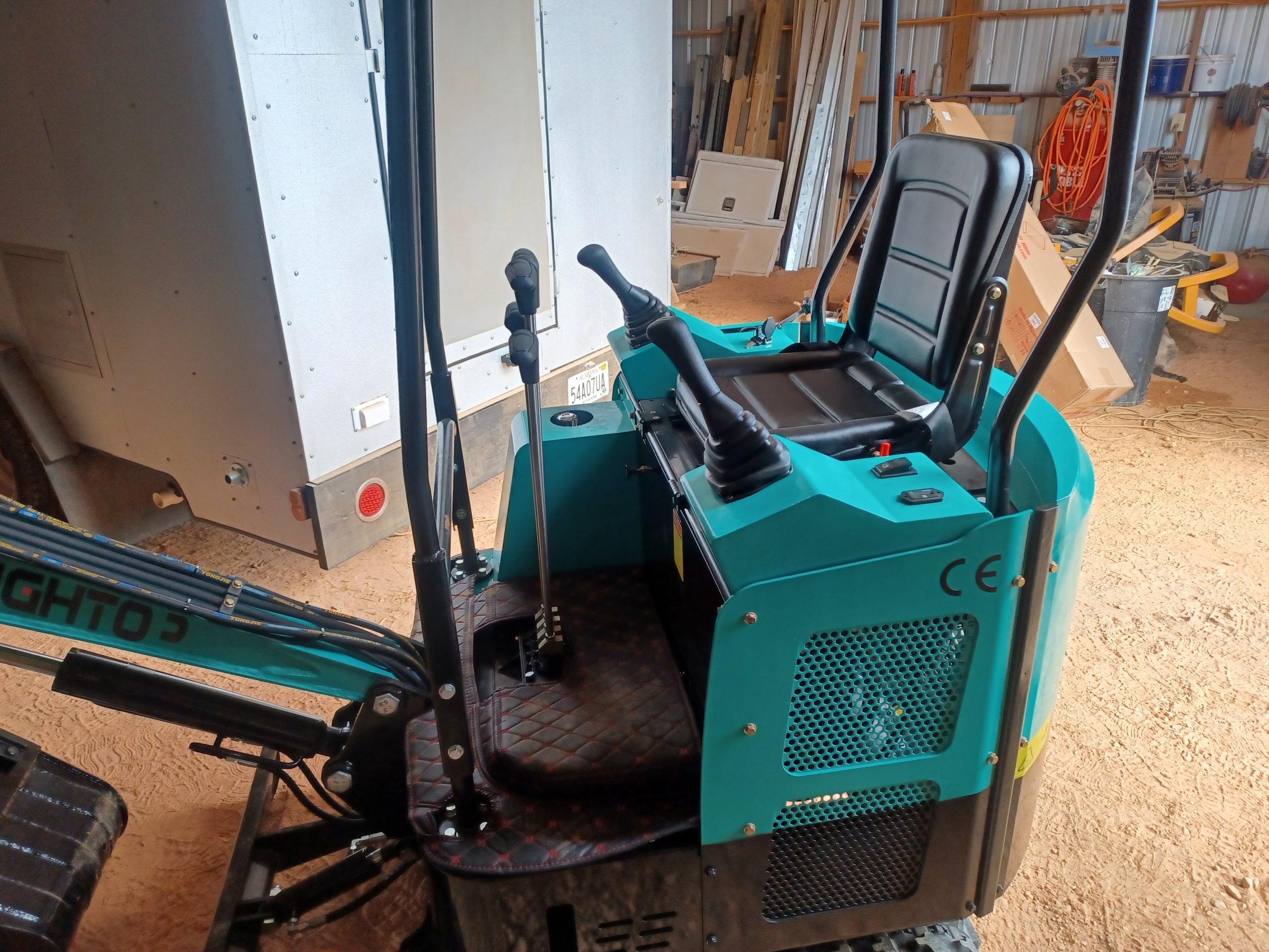

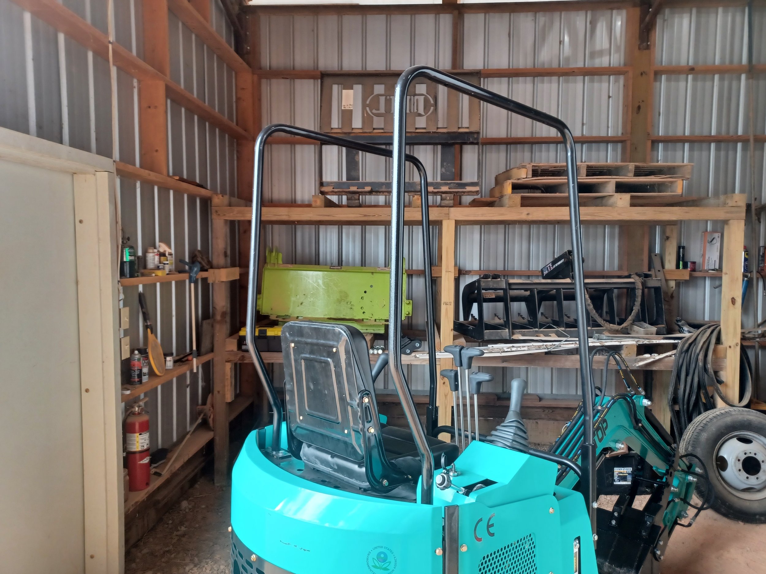

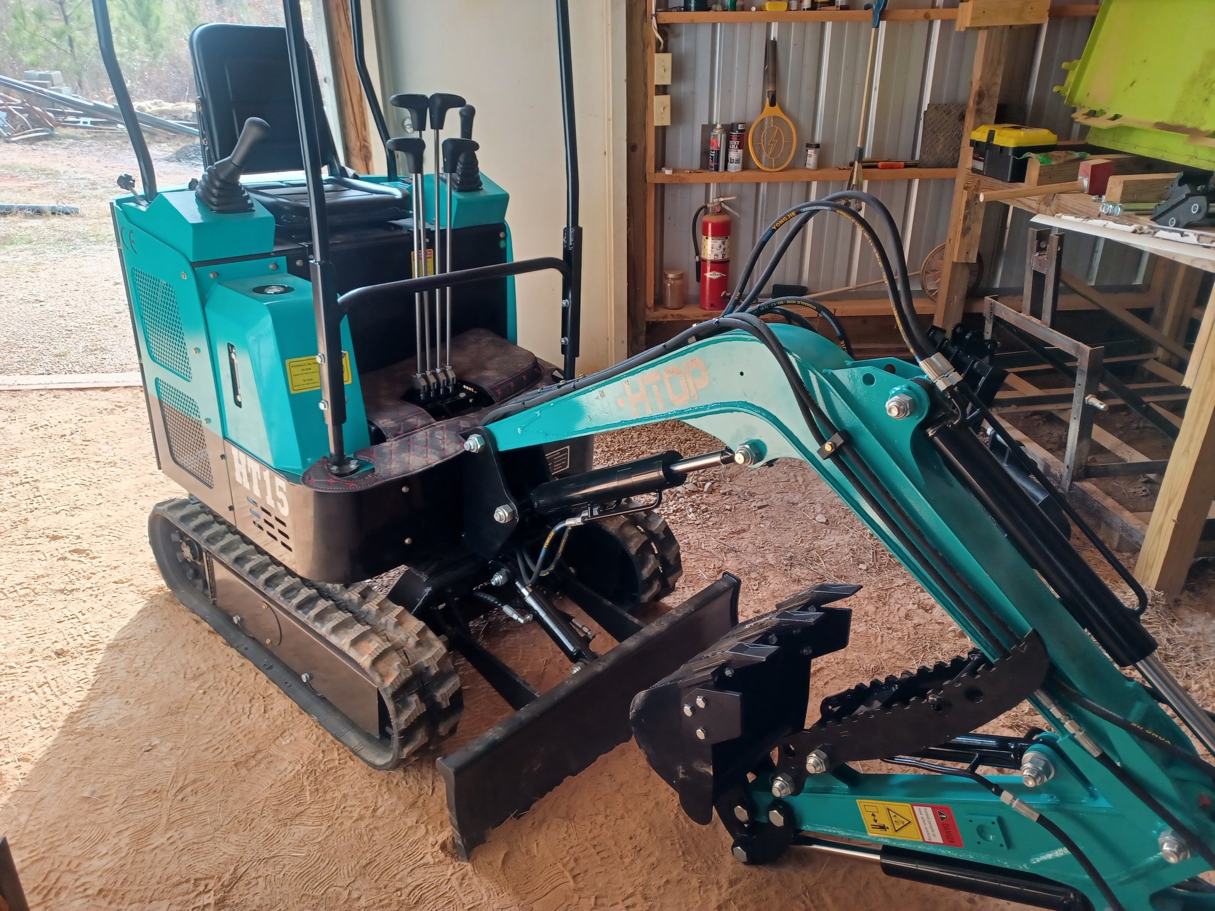

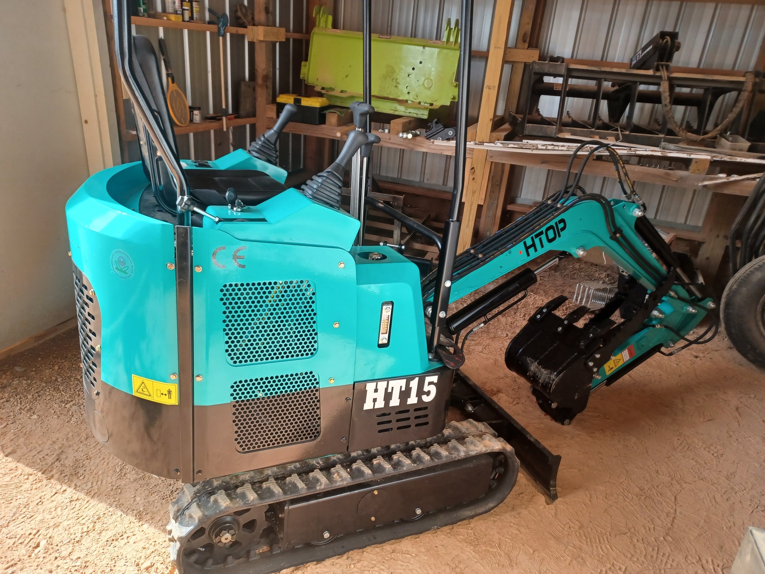

I just received a new Hightop HT15 from a guy out of Memphis. He was very quick to respond to questions and had the best prices I could find anywhere.
The machine is the 1.5 ton version ( I think we all know it aint nowhere near that heavy). None the less it is a larger machine as far as the body goes. Some sites that have these listed show around 2200 pounds actual weight. I am quite happy with the purchase. I got the machine, hydraulic thumb, 16" bucket, 24" smooth bucket, quick attach and rake all delivered a couple hundred miles the next day away for $8200 total. He was very accomidating and says he can get any parts needed. He is from China so he may have better connections or at least better communication with them than some. The canopy blew off on the way down but he said he will order and ship anew one to me along with any other attachments I may want in the future.

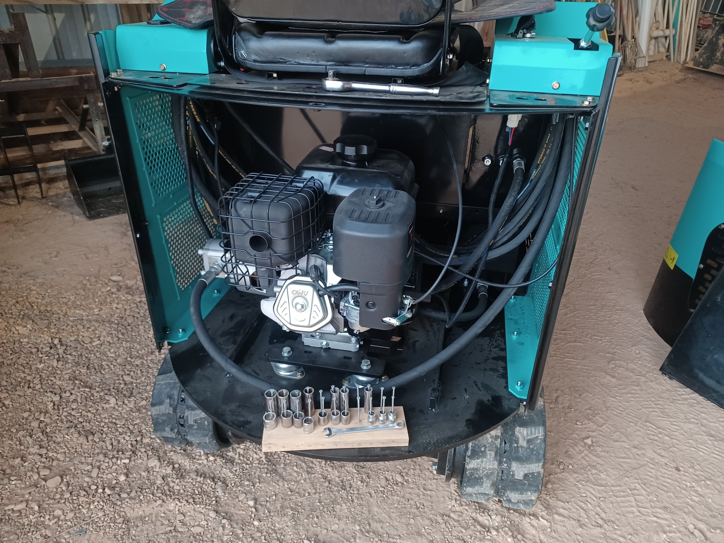

There doesn't seem to be a counterwight but there is an abundance of space in the engine bay for some of the improvements listed here.
Nice.
HighTop seems to be a reseller, selling product from different factories.
I see you have the pilot controls. Are you going to open up the house to check bolt tightness and if you have oil cooling and oil filtration?
Your hyd pump looks like a larger (greater than the usual 6.8cc) single-chamber pump. That means you have flow a divider, probably on main valve stack.
I will be checking bolts, changing fluids, adding fan and filters.
Tell me where to look and I'll take some more pictures.

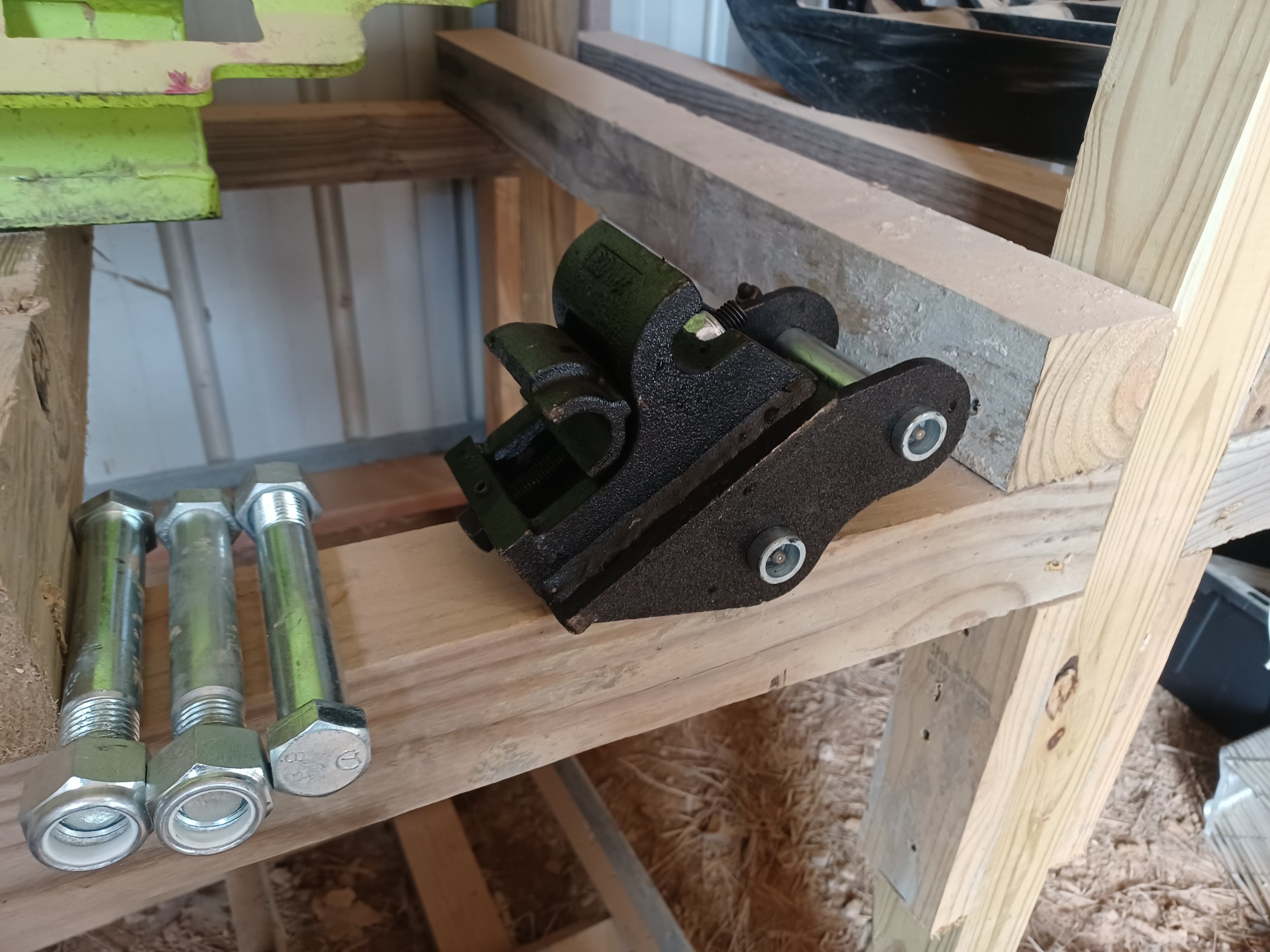

I'd like to hear some opinions on adding a counter weight. The rear panel is just sheet metal and doesn't seem like it could hold much added weight.
There is lots of room in the rear of the engine bay. Maybe atttach some weight to the rounded base in the pic?
Your machine probably has the longer house, with 41 track links instead of 37. You could add some weights inside like my early mini has (3 25# steel plates). If your local recycler sells lead ingots, those are even better.
One more thing to check is track tightness. Minis will spit their tracks off in a heart beat if not tight. Tighten very tight. Dog house looks nice and open so should be easy to do your mods.
   / Importing and modifying a new mini excavator from China #1,080
So don't leave any play in the tracks? On a Bobcat I had there was supposed to be some play. I know these are different types of machines that have their own quirks though, I'll take your adivice knowing you have experience. I don't want to mess with a track out in the field.
I checked the track links, mine has 37.
