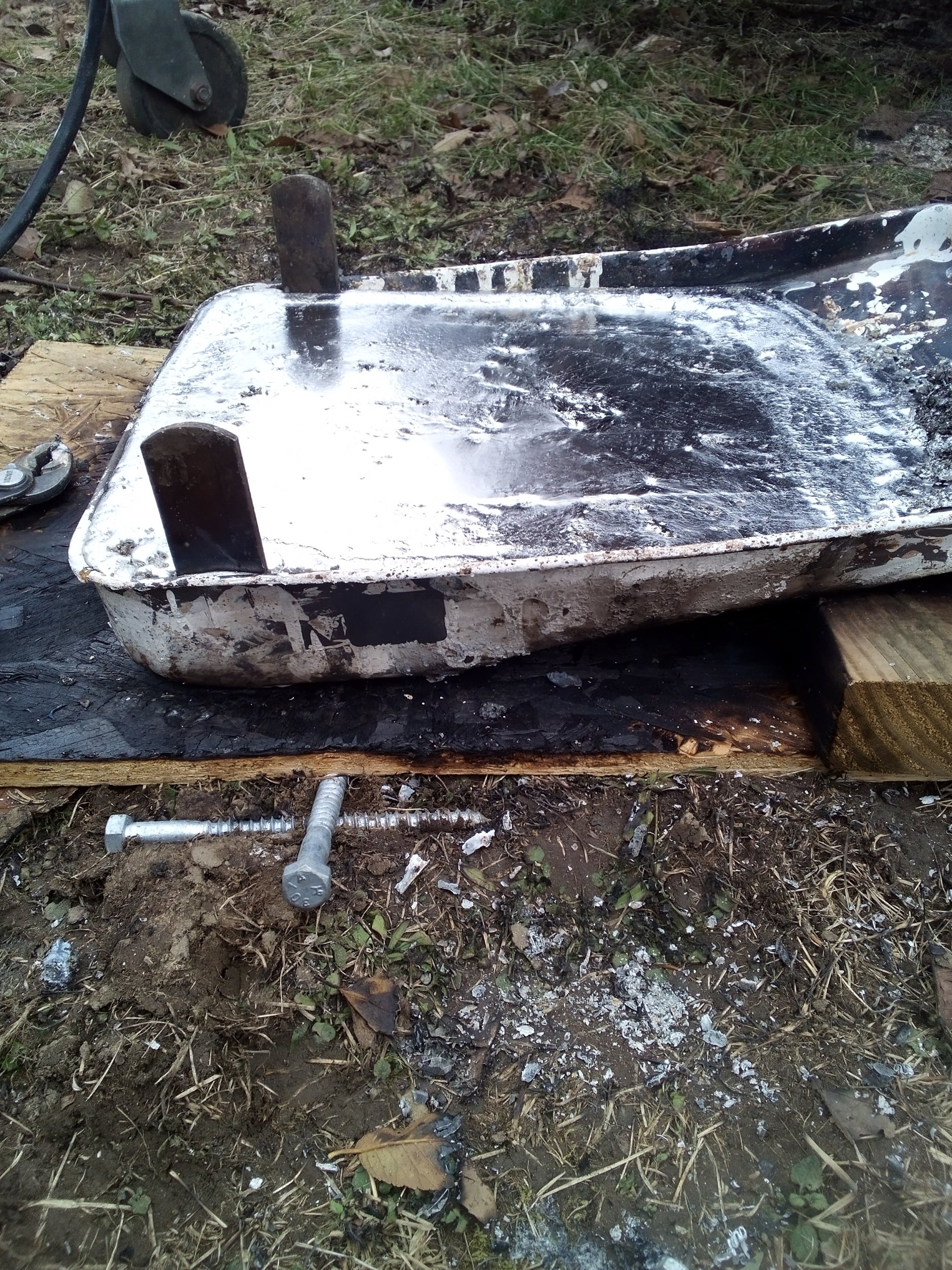

I guess they act like a check valve when there isn't enough driven hydro pressure to open them. Gravity alone can't open them.

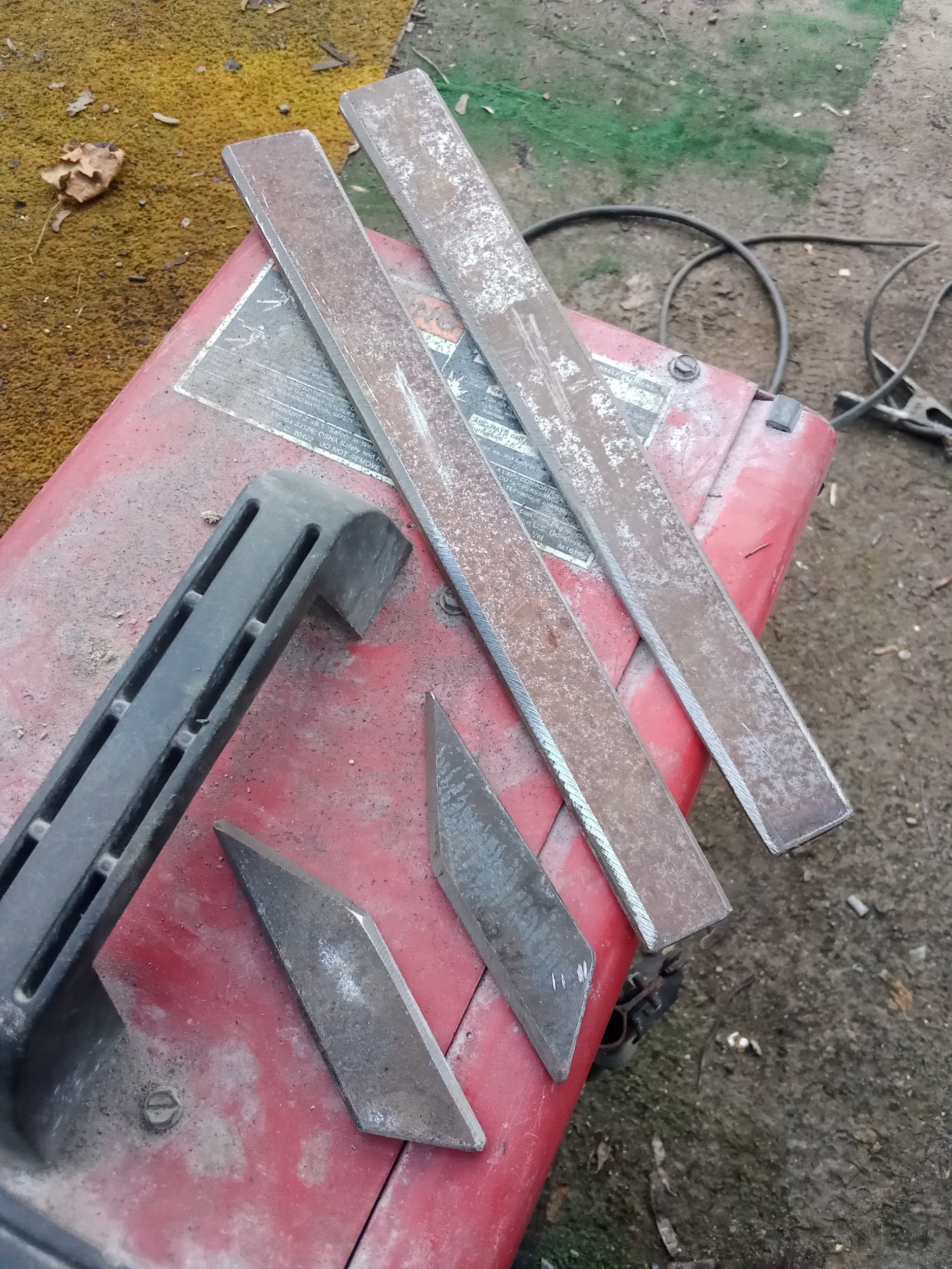

Almost a necessity sometimes. The sinkers and thin stuff are super easy to get melted compared to a 50lb ingot but it all melts long before steel/tin in open air.

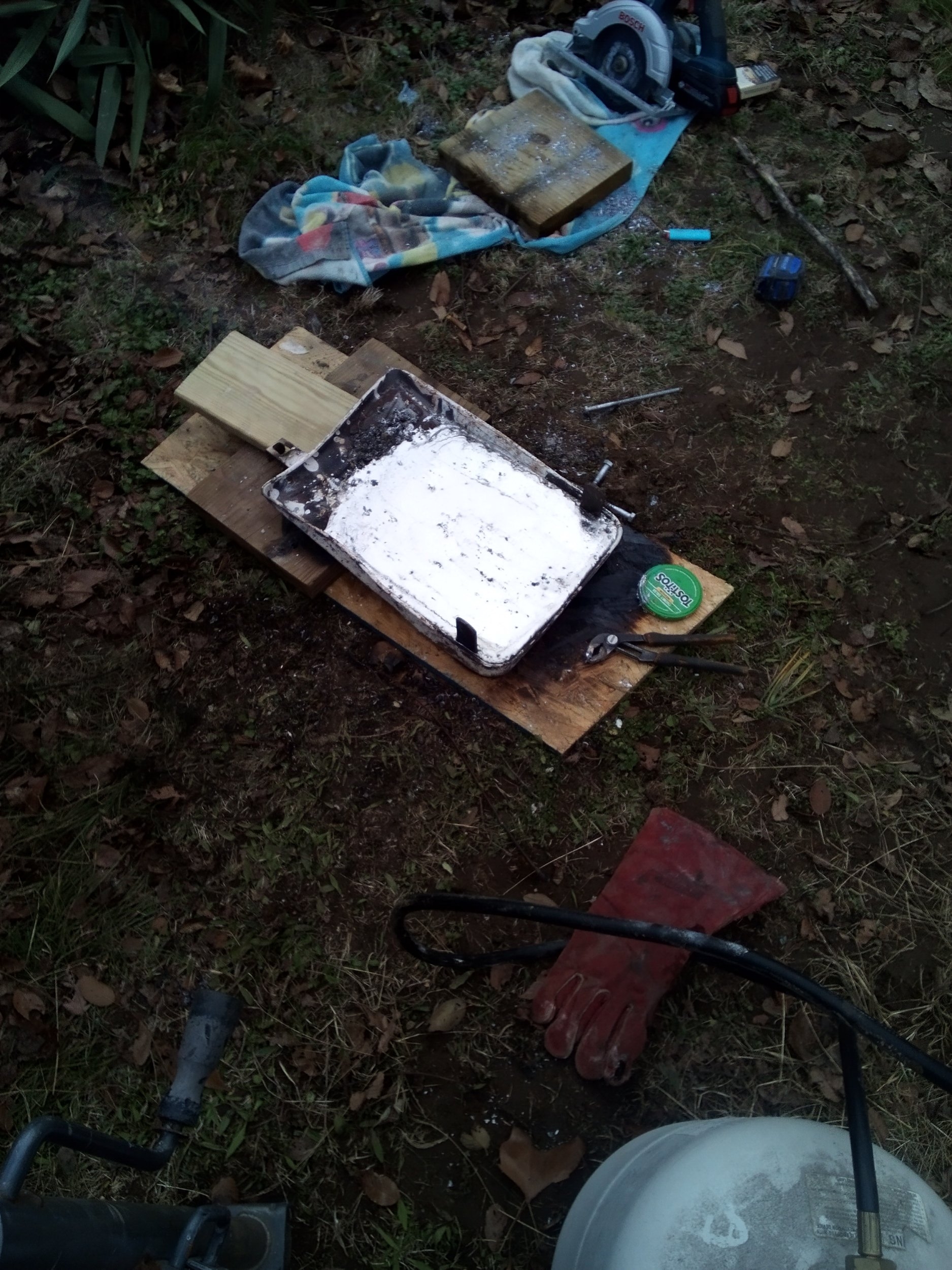

The biggest challenge was finding an appropriate mould without fabbing one. Pics of an old paint tray below that worked good for a wedge shape. Very easily trimmed the result with a circ saw.
Since drilling for me tended to melt the lead and seize the bits I just added the posts when liquid on the last one.

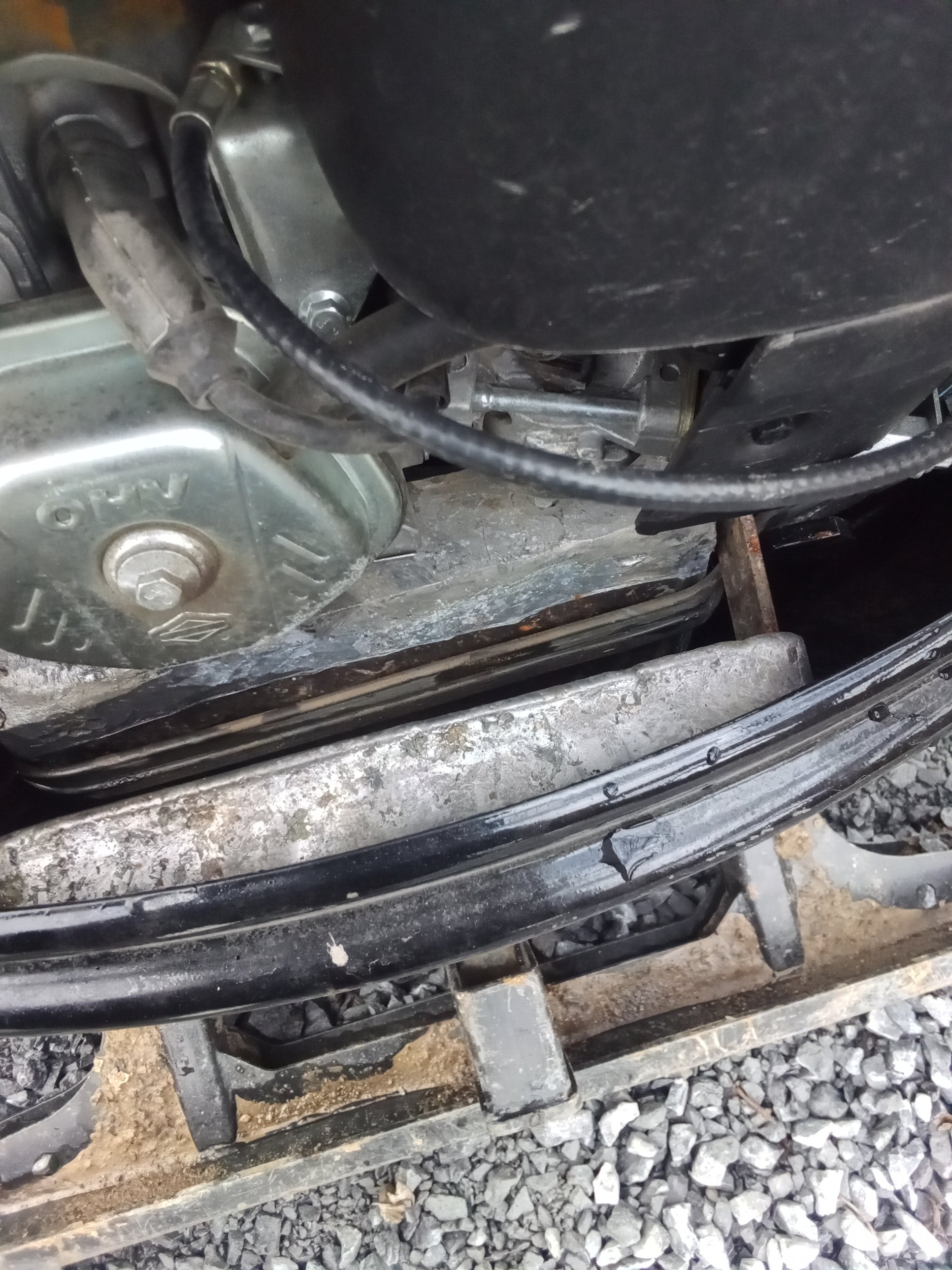

View attachment 846811View attachment 846810
View attachment 846809View attachment 846808

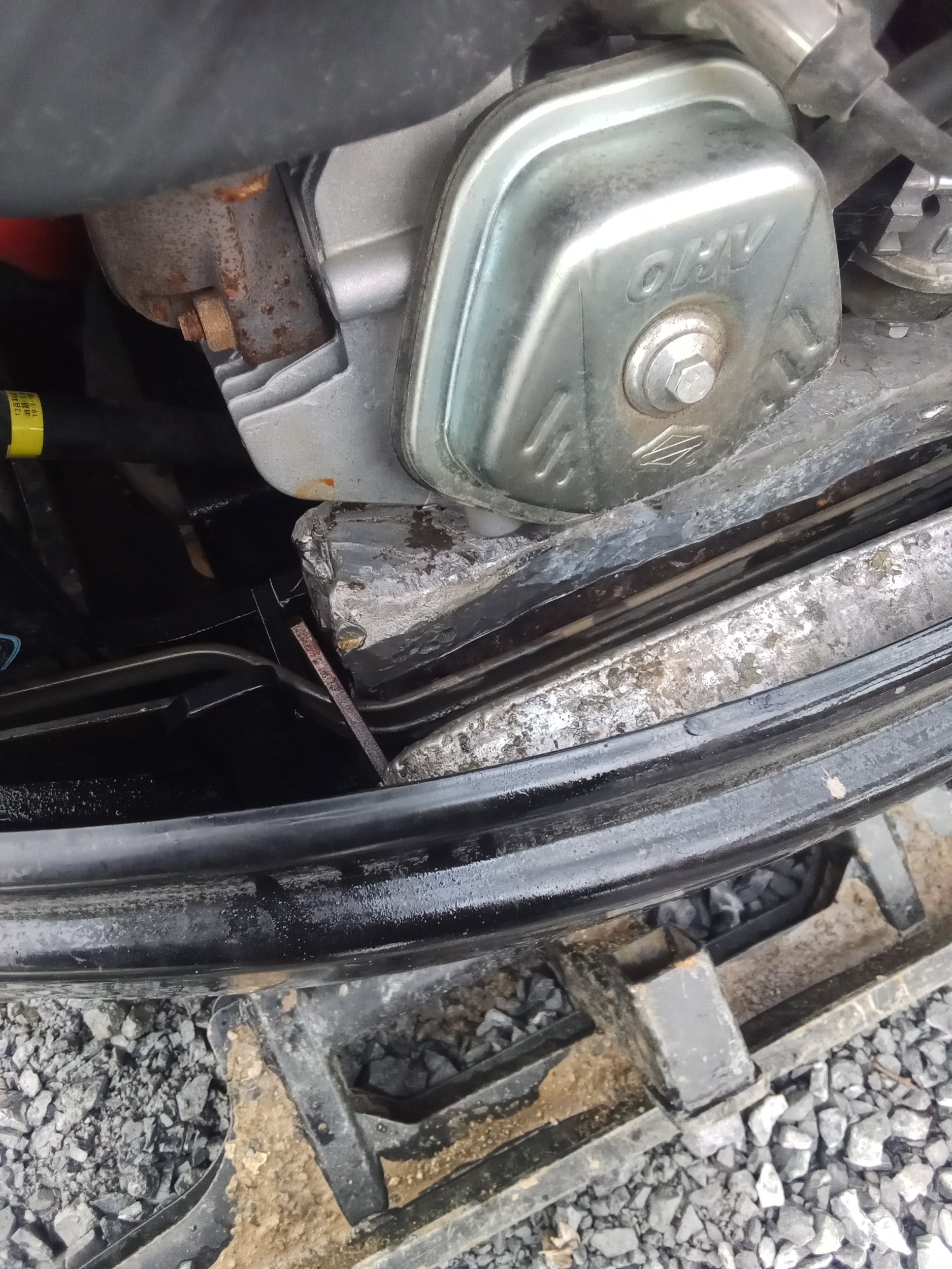

There's about 200lb on center and rear of house floor and 150lb more easily seen in pics centered on the back.
It made a huge improvement dampening the inertia from fast and or fully loaded main boom movement that used to rock or tip the 2200 lb machine.
The HT looks like it has alot less steel at the rear than mine, but also quite a bit more room to play with. Just using the thing and starting to add weight I'm sure you'll get a feel for it. You went too heavy (or main RV pressure too low!) if you can't easily track with the extra weight or the blade can no longer lift machine.

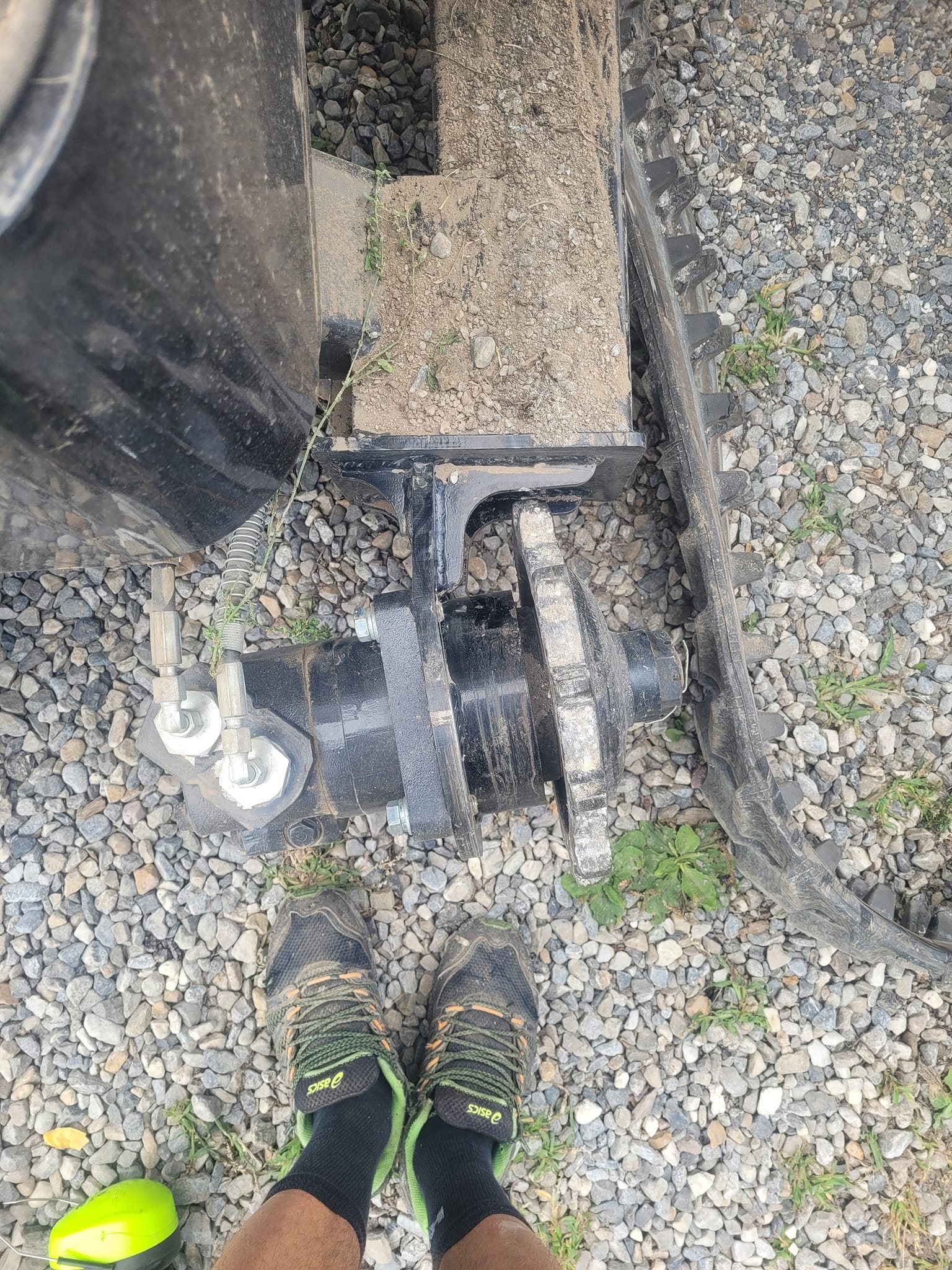

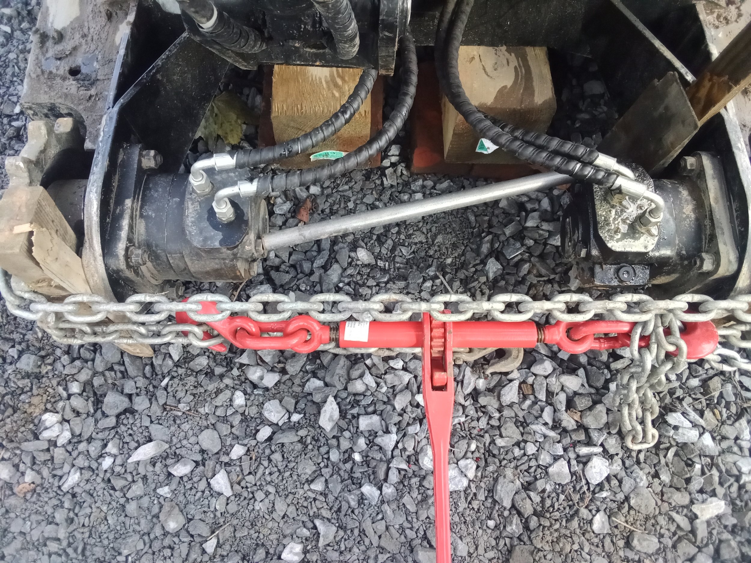

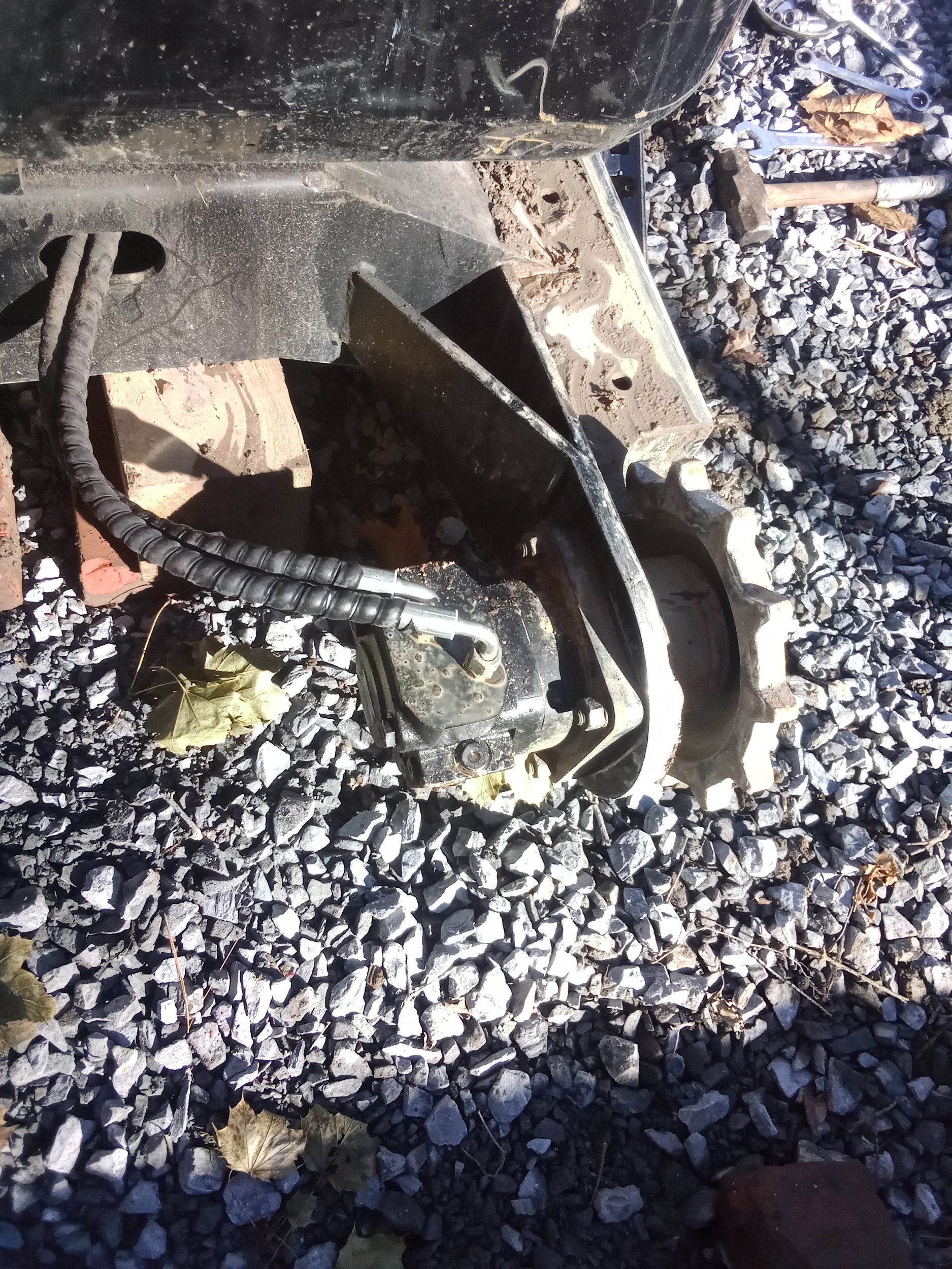

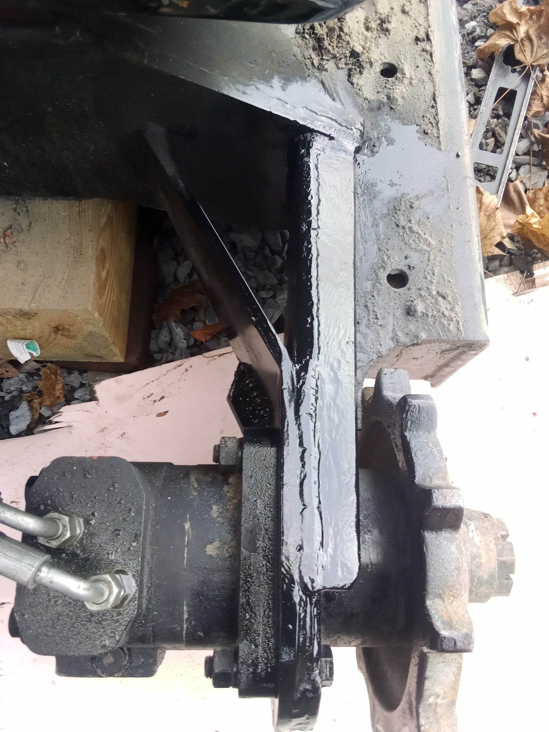

Straightening frame tails. They both consistently had bent a few degrees outward- I'm beginning to wonder if it wasn't from something like hard jump turns due to the consistent force they exert VS the inconsistency of binding the tracks up many times at random in both directions of travel.
Also, during removal and install of the tracks for this repair I had some trouble with binding the tracks again in both directions and to full stop, even at the newest high pressure setting of 2900psi 19.99bar.
There wasn't really any apparent side forces at play when binding/bound.
View attachment 846807View attachment 846805
Either way a 4t chain binder pulled the frame in easily, and I added some 3/8" flat stock gussets top and bottom for now. Could be much more heavily gusseted but it was cold and windy and not close to any power for tools/welder.

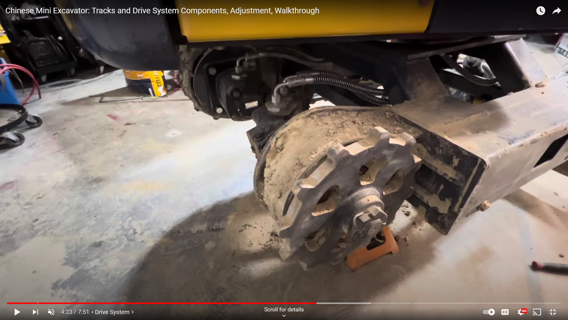

I've noticed that the newer machine have a redesigned sprocket section, it apperas to be much more robust. See attached pics. Do you think it would still be wise to add bracing accross the rear to keep the spacing.
My 6yo sprocket has no holes and weighs 21#. Seems more robust than the new ones. What does yours weigh?
I bought spares of most things I thought could break and not be fixable locally. The frame bracing I have is on the outside and is not very stout, due to interference with the sprocket. Small rocks easily get in there. Adding some inboard bracing seems a good idea.

I meant the metal that the sprocket mounts to. The sprockets themselves definitely look worse on the newer ones.

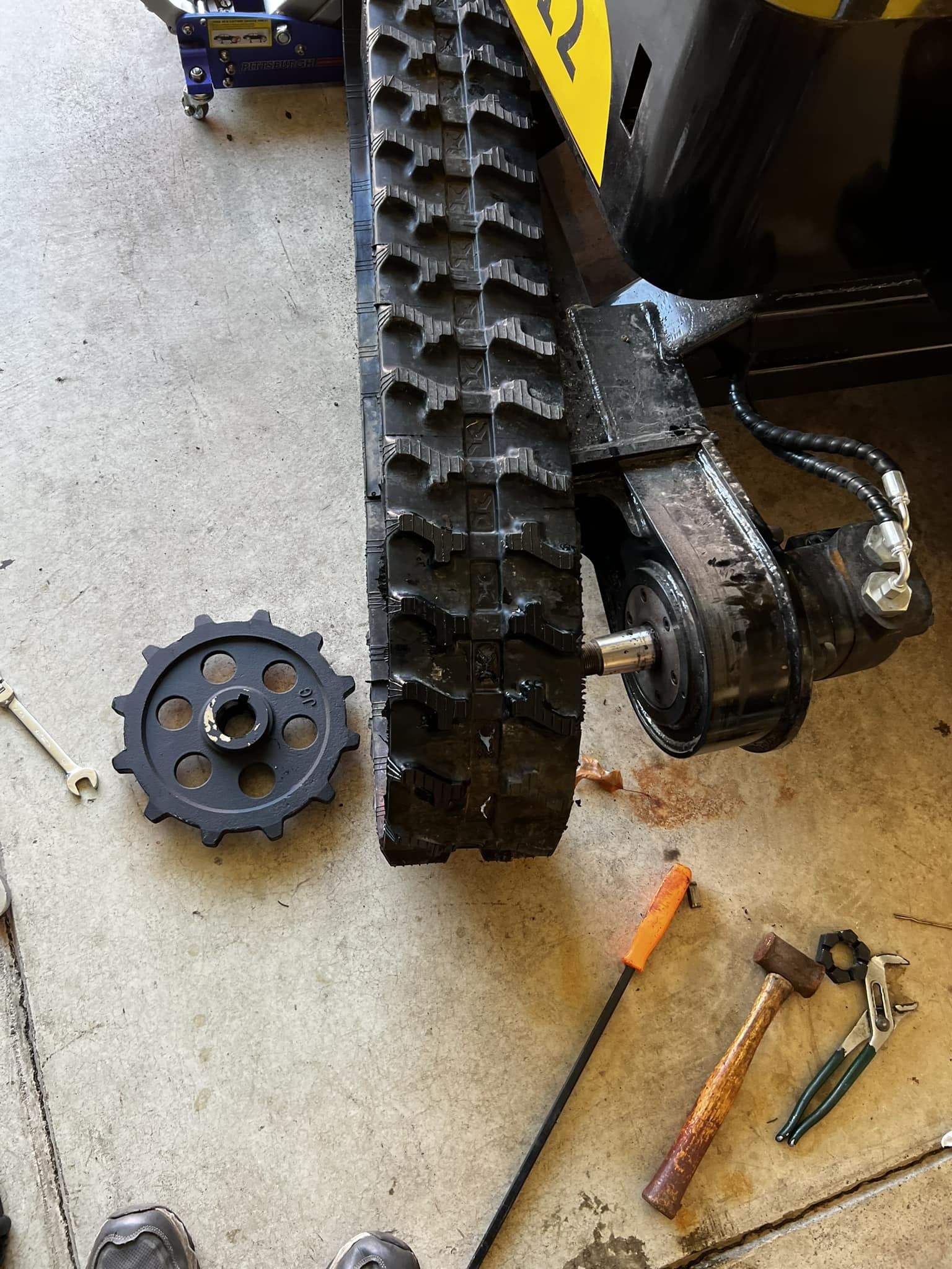

The pic with the bent metal is an older machine. The new ones have to pieces joined by a piece that wraps all the way around.
