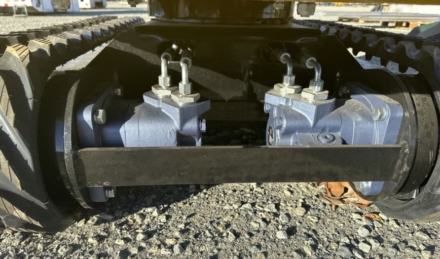

I've noticed that the newer machine have a redesigned sprocket section, it apperas to be much more robust. See attached pics. Do you think it would still be wise to add bracing accross the rear to keep the spacing.
Definitely. I find its much easier to weld in reinforcements when something is straight, before it gets bent and twisted. Often its impossible for me to get something back to perfect. Besides, most people want to add weight to their machine, so I can add it 1lb at a time!! :)

The MachPro Mini Ex have a bar welded between the drive motors.
Good find. Thanks for posting.
I have been working on tying my rear hose protection into a lower plate. I was going to use some stainless steel plate, but now I think I will go with a thicker bar like in the photo. Esp after seeing pix of that bent frame.
I wonder why the MachPro folks did not do anything about protecting the hoses.

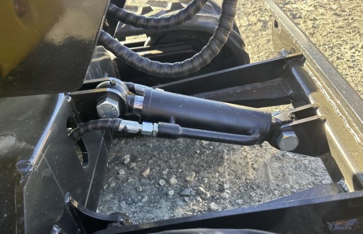

I also really like the improved blade cylinder with hardlines to protect the vulnerable hoses and fittings. Also note the tie-down holes in the blade. Nice.
Tiedowns in the rear sure would be nice, too.

Connecting the frame tails / motors with steel member seems like an ok balance of strength/ease/aesthetics/function.
I opted not to do that yet. Aesthetics
jodieadiar: thanks for the pic of yours - that setup is substantially more stout with the 3 dimensional shape, I wouldn't expect any issues.
Wow I wonder the age/make of the bent one in your other pic- really obviously a poor design (without some decent gusseting)
