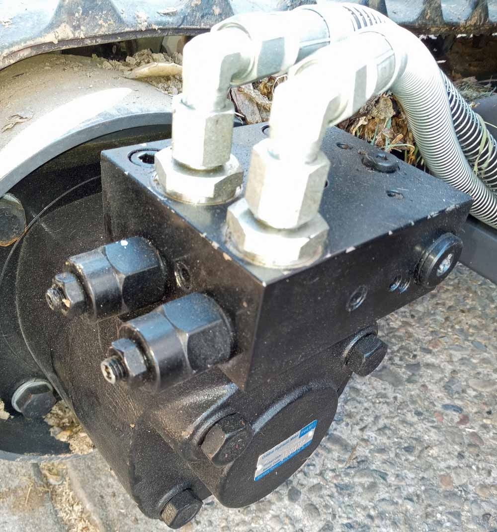

Of even more concern should be the wheel motors. You should look into adding cross-port RVs (counter-balance valves, or wheel braking valves) to the wheel motors. This was done by request to the maker by local importer Jason. It helps a lot with keeping the mini-X from going downhill too fast. A Big Problem.
Note that ports already exist on the motors, but there is no info on how they are connected. Have you looked into this? Photo shows a wheel motor with attached valve block with 2 RVs.

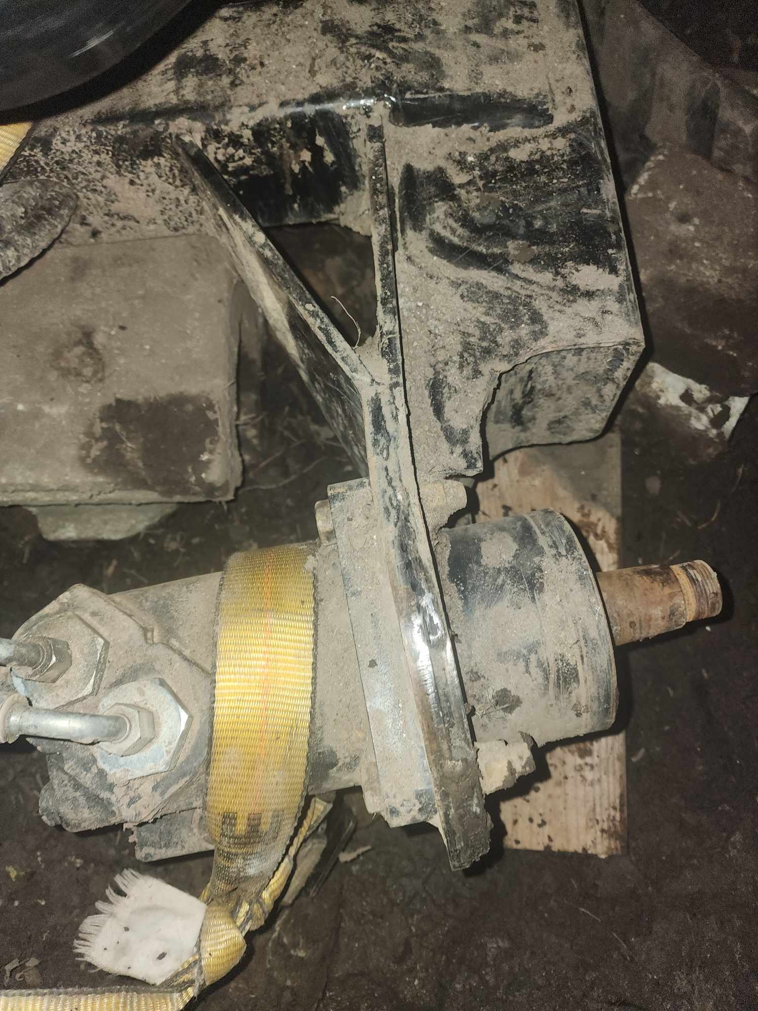

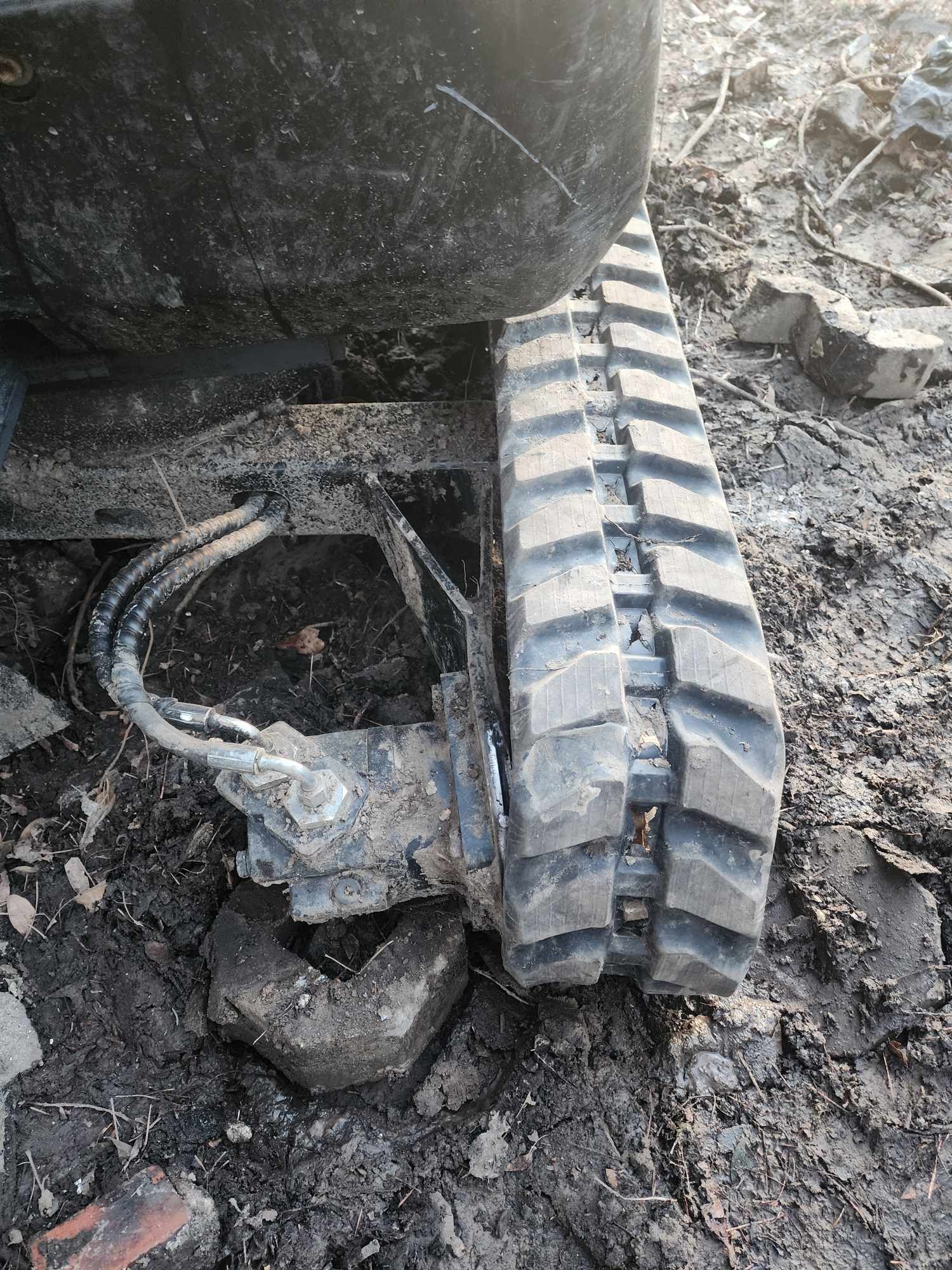

Hey guys. It seems like we just talked about this. The pics are from a Facebook group user. He rented his machine out and the customer bent the motor mount. I feel bad for him and he mostly got criticism instead of help. I figured I would ask you smart guys about any possible straightening solutions. I believe the machine is still in the field. It is a 1.8 ton AGT 18.
I know what I would try first. I would spin the house around so the bucket is in front of the wheel motors.
I would extend the bucket out and push it into the ground as far as possible. An anchor point is what I am trying to achieve. attach a 4 ton come-along to the bucket and then around the outboard side of the wheel motor. Be sure the bucket is positioned so the cable is pulling forward and slightly toward the opposite wheel motor. Heat can be applied if necessary. I think with possible fine-tuning this may work.

Great suggestion, I'll pass it along.
