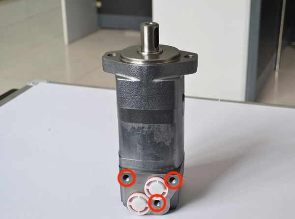

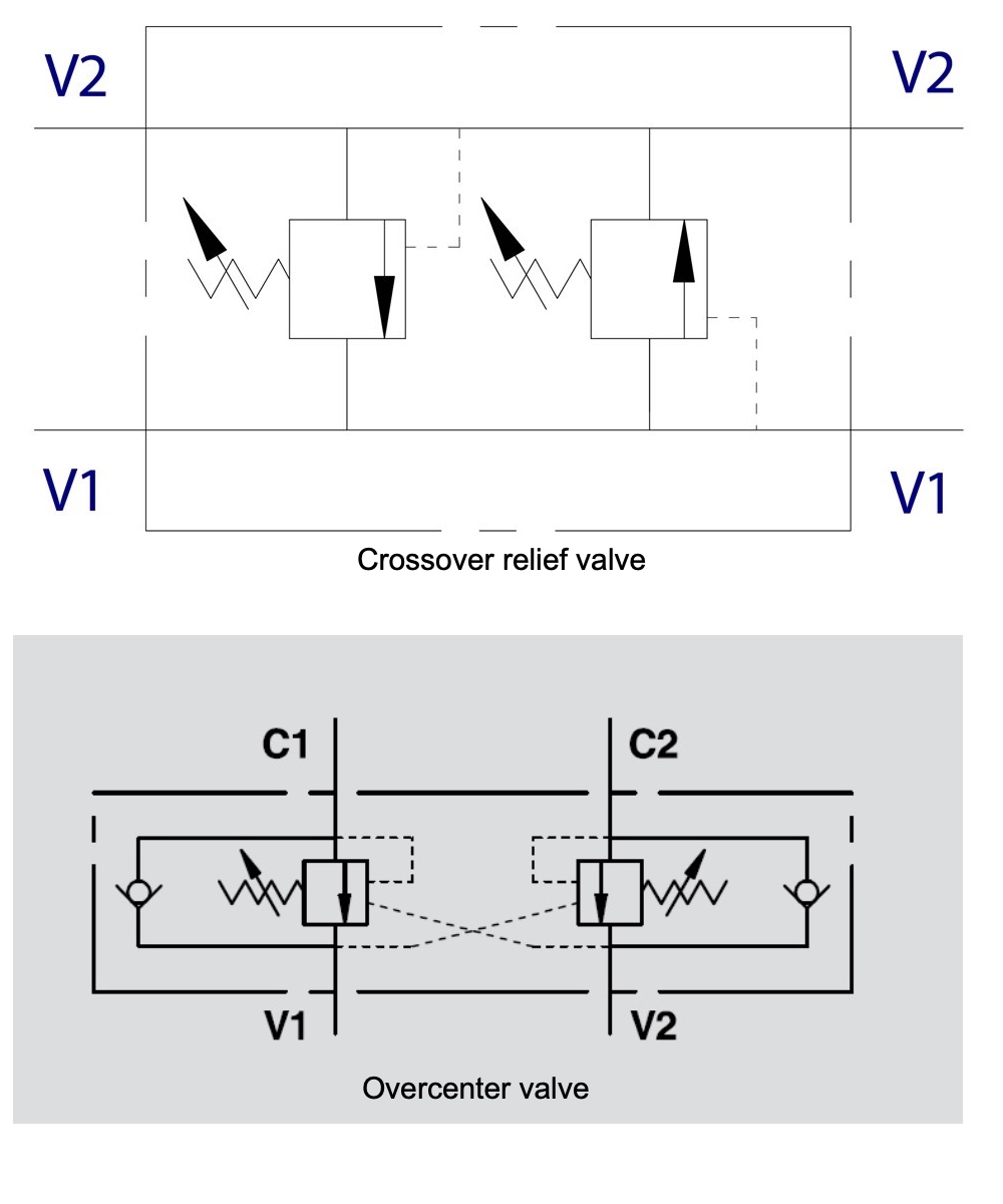

Interesting link. Thanks for posting. Different names for some of the same kinds of valves
Of even more concern should be the wheel motors. You should look into adding cross-port RVs (counter-balance valves, or wheel braking valves) to the wheel motors. This was done by request to the maker by local importer Jason. It helps a lot with keeping the mini-X from going downhill too fast. A Big Problem.
Note that ports already exist on the motors, but there is no info on how they are connected. Have you looked into this? Photo shows a wheel motor with attached valve block with 2 RVs.
It appears to be a flange-type counterbalance valve which have O-rings for sealing.
BM5 Series Orbit Hydraulic Motor Counter Balance Valve
Unfortunately, my drive motor doesn't have threaded holes, so installation would be difficult, and it seems like modification is necessary.
Freewheel of the motor can be dangerous, and it can also cause system damage due to cavitation. Depending on the operating environment, it may be necessary to install it.
I agree that a counterbalance valve (crossover RV with anti-cavitation check valves) is superior to a crossover RV alone. I asked HeChuang (thru our local importer who speaks Mandarin) to see if I could retrofit my wheel motors with the wheel-braking valve in my above photo. (Answer: no)
What about locating 2 crossover RVs or counterbalance valves inside the house to protect the wheel motors? Not ideal location on the motors, but there is room inside, and adapting to wheel motor near the valve is not hard.

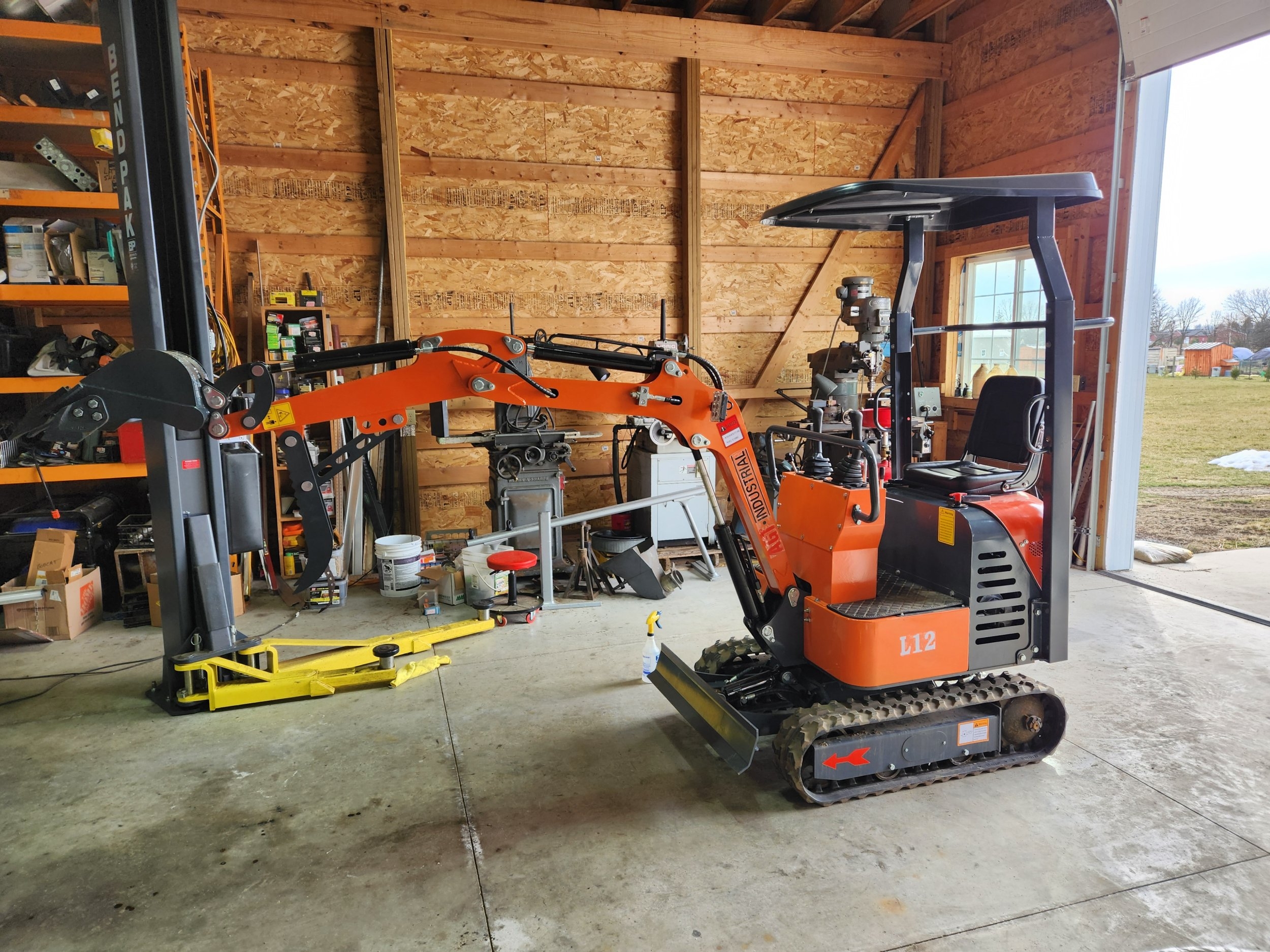

Hello All. I'm new to the group. I just finished reading the comments from start to finish and wished I had done so before picking up my AGT L12 at auction about a week ago. I paid $4225 plus auction fees and sales tax for a total of about $4925 out the door. There were 22 AGT units up for auction, only 2 L12's, a couple of H15's, and the rest split between H12's and QH12's. All of the units went for low $4000's except for the H15's which were low $5000's.
I liked the L12 because of its openable "hood" and that it comes with a hydraulic cooler. Sadly, no spin on hydraulic filter, which I plan on remedying asap. The lcd hour meter was full of water and no functional, since replaced with an electric/mechanical style. The digging force is very weak, I hope due to the relief valve being set too low. I cranked it up a bit and it seemed to help, but don't want to push it until I can get the adapter to get a gauge on it. I've already been ejected from the drivers seat, picking up a pretty good hunk of freshly cut firewood and pivoting sideways. She's a tippy one.
