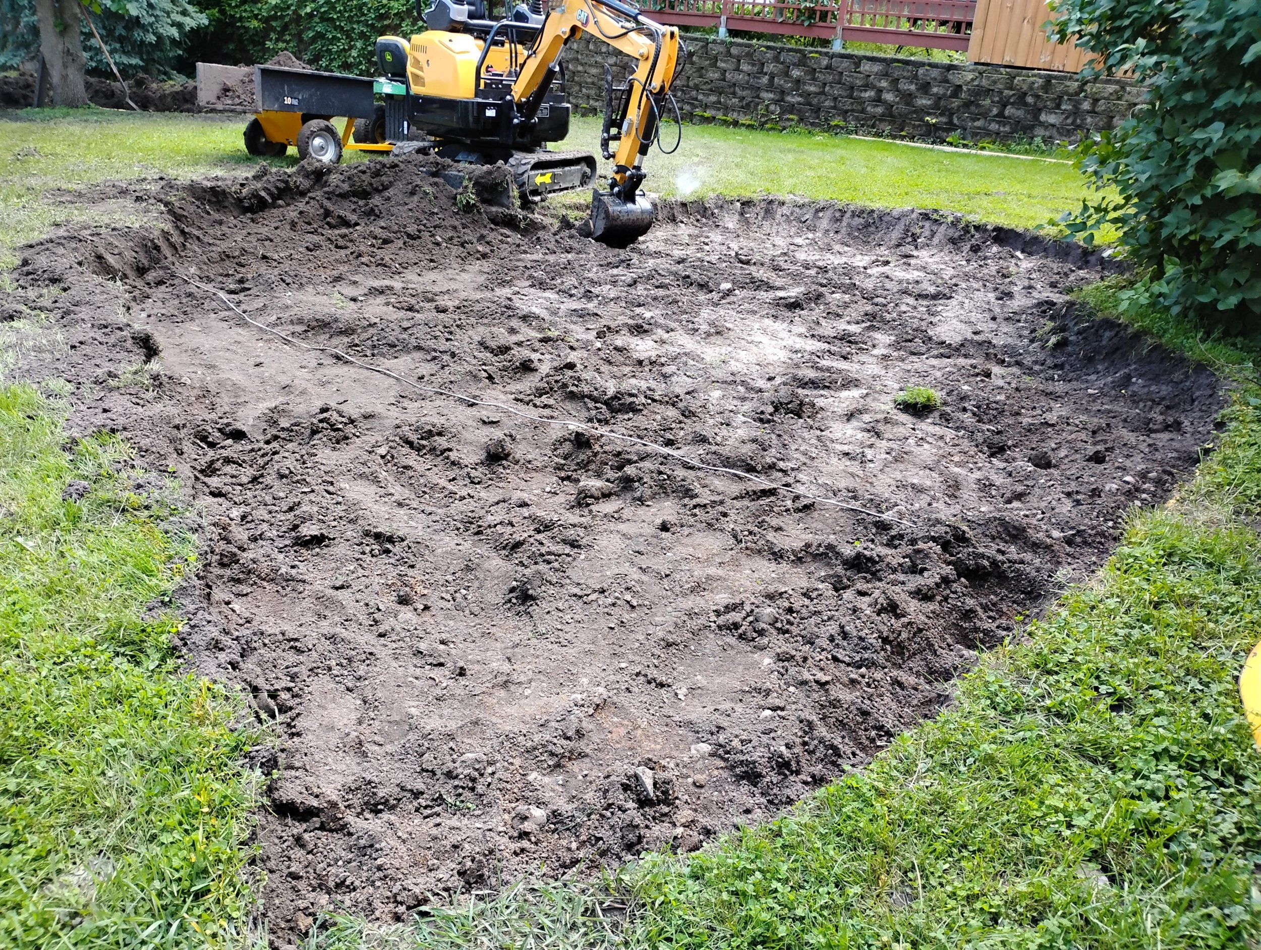

Thanks, that is some very good info. Mine looks the same only it's branded as a Miva VA15. I would love to get a part number for the return filter inside the reservoir. I do plan to change it to an external spin on in the future but that may be at the same time I install a new lower output pump. From the specs listed, it looks like the existing pump is 10.6GPM. I would love to have something around 8GPM.
I have about 13 hours on it so far and I'm very happy with it. As long as I run it just above idle it's very smooth. On to the next project!
