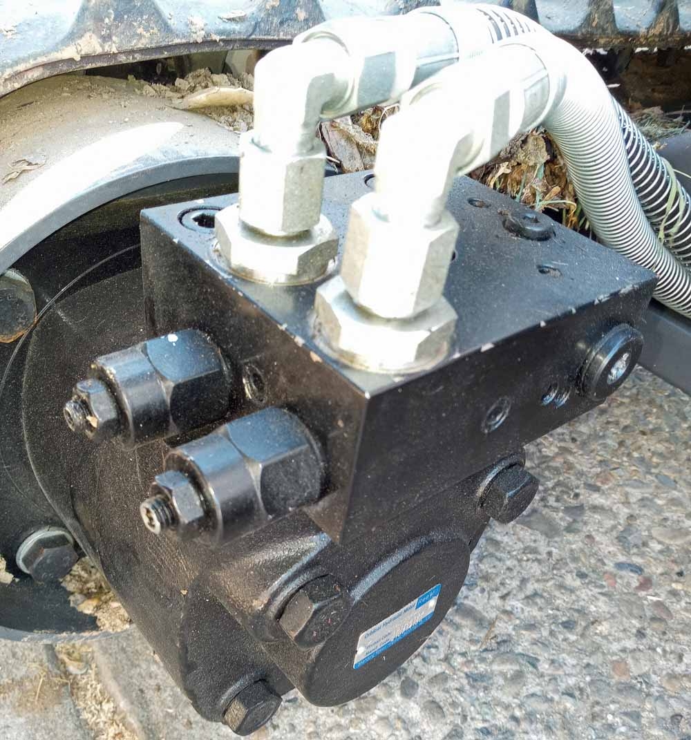

Interesting update on the runaway "feature" of the track drive motors on virtually all of the 1-2T Chinese mini-excavators.
It seems a few people have been successful getting their Chinese mini-X supplier to replace both drive motors with new ones that have have an added valve block with counterbalance valves. These are essentially hydraulic brakes.
Everyone who buys these machines from an importer like Agrotk or Kymron needs to request this very important safety upgrade. Auction buyers are kinda SOL, but direct requests to the factories in China is something to consider.
Any followers of Howard Kettner on Utube? He posts his upgraded motor replacement here:
Looks just like the upgrade I posted before:

The next Big Thing may be to get them to provide better drive motors with braking. Someone is gonna get hurt.
