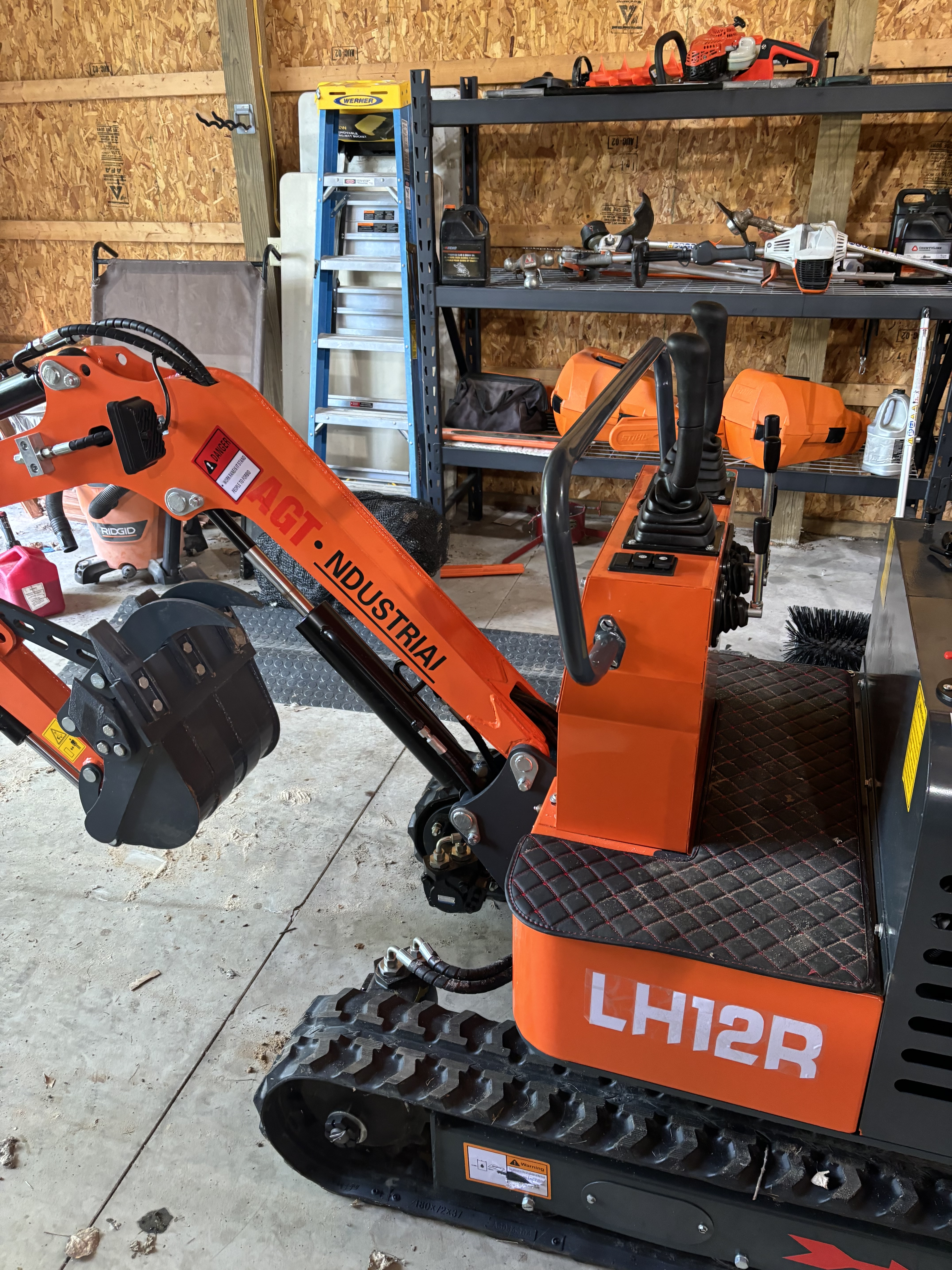

Hi everyone. I’m new to the site, and joined because of this thread. I’m grateful for finding it be a new owner of a agt lh12r. I’ve definitely already learned a lot after a few days of reading all the posts here. And hope to add some of my own as time goes on
Welcome Bill, congrats on the purchase, these little machines are impressive.

Thank you, I definitely have a lot of plans for it. Unfortunately winter is making them wait.
