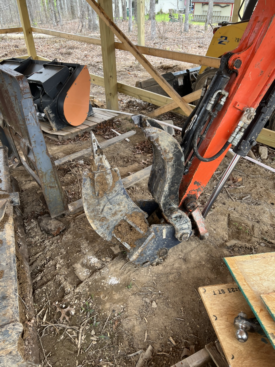

What is thickness of the stock used?
My ripper is up on my mountainside, not near me now. The business end
is an inch or more thick.
I suggest that you buy a good commercial tooth ($10-15) for larger excavator or backhoe, then cut/weld steel shank to fit. You can use multiple layers of steel bar if you can't easily cut or weld 1-in + stock.

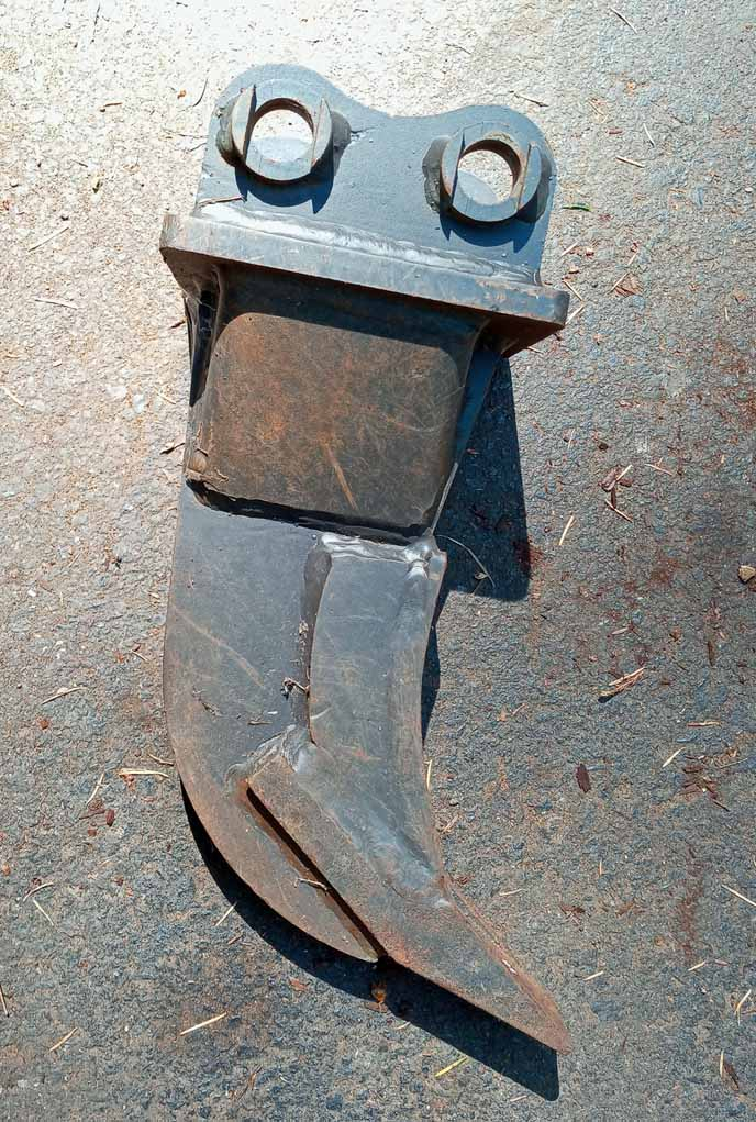

My ripper for my KX040 is 1” ar400. I’d think 1/2” hard plate would be enough for a small mini.
   / Importing and modifying a new mini excavator from China
#343
Here are the two I have had. They were sold by different factories, but made exactly the same way. They were about $50-60, FOB Qingdao.
Very strongly made. Weigh only 50# or so.

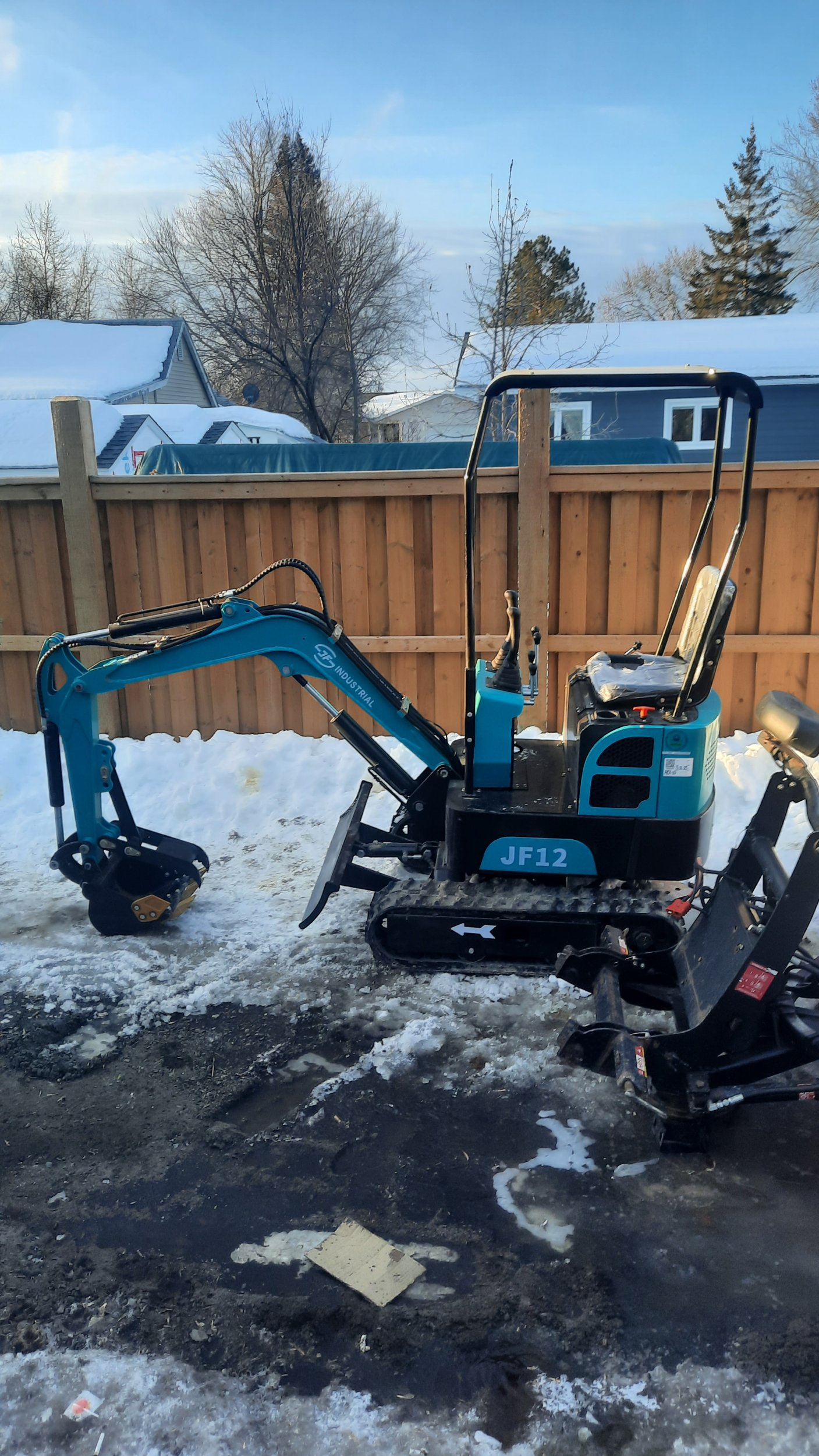

So I found a JF Industrial JF12 fairly close to my home in Ontario Canada. It was 1 of 3 that the Seller purchased at Auction, transported all 3 to his City and sold 2 of them to cover some costs.
I purchased it mainly for at my Cabin, to clean up after last years Flooding. 13hp B&S 420, no Oil Cooler but Filter.
So far I have changed the Zerks, Routed the Exhaust out of the Shield (as mentioned they get Hot), Moved the Mechanical Thumb to the top hole (it is just way to much in the way as was). Which is why I went back to Alibaba in search of a Hydraulic Cylinder and Hoses to Plumb a Hyd. version.
Last Night was quoted FOB Qingdao TE-12 with EPA Engine $3100US, Roof $80, Packaging $100, Free 400mm Bucket and Free Hyd, Rad. Hyd. Thumb $100 (as an extra) Logistics and China Port Free. So Shipping, Broker, any Tariffs and Canada Port Fee extra.
These machines are selling at auctions all over the US for $6500-$9000CDN ($4500-6500US$$) Landed and at a Auction near you.
So I am still looking for a Cylinder (closed @ 14"s) and Hoses to the Aux which I think are JIC thread. Do I need the Lock Out valve seen on some thumbs?
