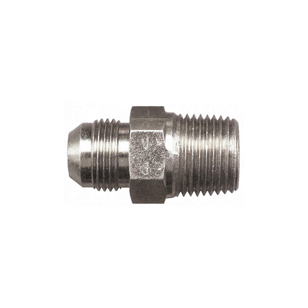

Pick your brain 1 more time?
The Aux Ports, I assume are JIC fittings or are they JIS? Looks like JIS is common in Japan, tough to see 30 vs 37 degrees. If it is JIS, what size? because JIC looks like 3/8"
   / Importing and modifying a new mini excavator from China
#354
They are neither. All 3 "brands" of Chinese excavators I have owned or seen up close use metric O-ring fittings, except on the pump.
