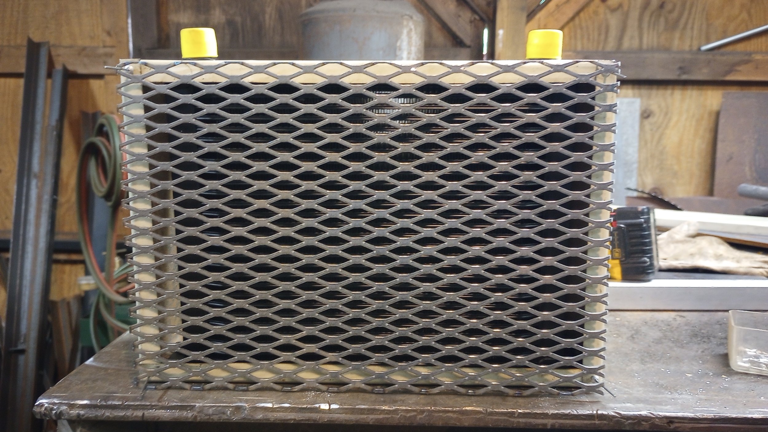

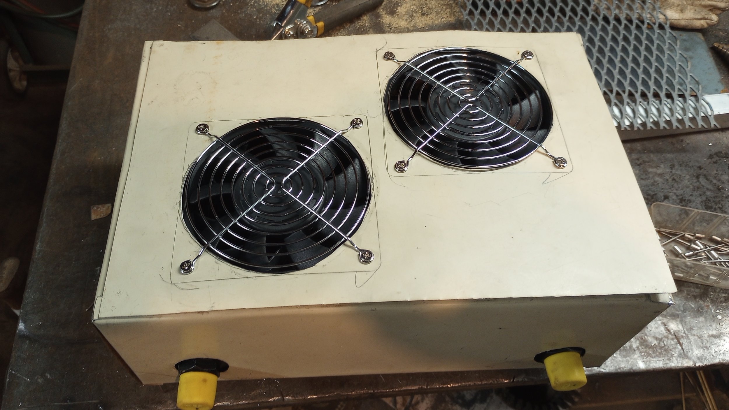

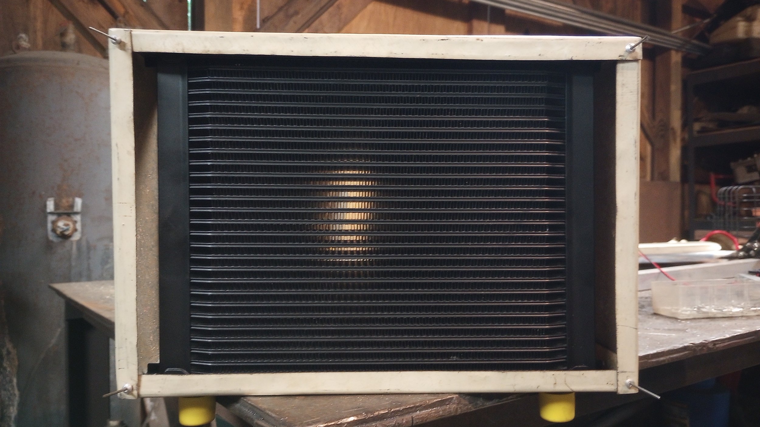

Had a couple hours to fab my oil cooler . Still needs to be painted, assembled and installed.

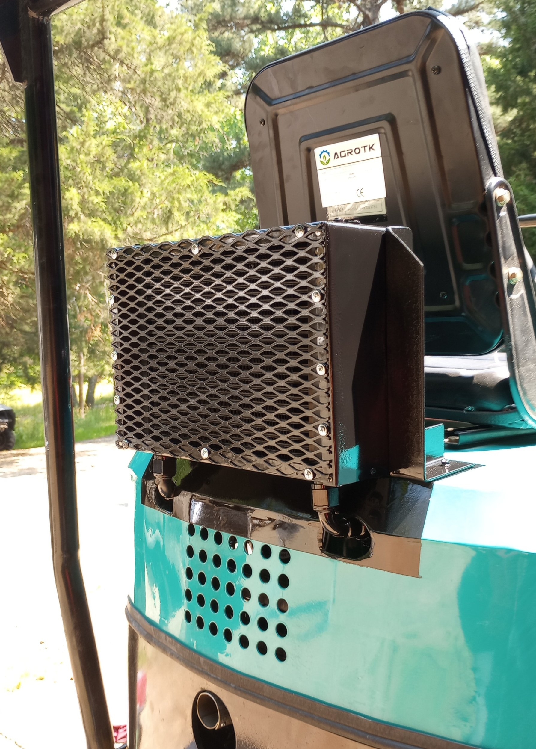

Where are you going to install the new oil cooler?
You know, no one is obligated to keep the sheet metal shell on the house. There are some versions of these 1-t minis made that have open houses. That way, the gas engines can breathe and run cooler.
   / Importing and modifying a new mini excavator from China #473
Oil cooler is mounted behind the seat . Only place there was room really. Hopefully will have pics some time later today to show my progress.
Still cutting openings to let the heat out but wanting to leave enough structure to keep it rigid.

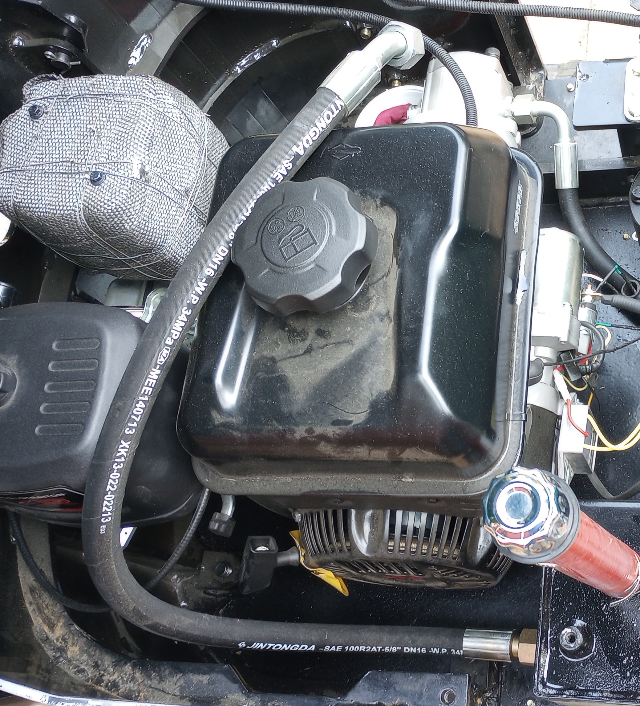

I've got some pics of what has been done so far.
First up is oil filter.

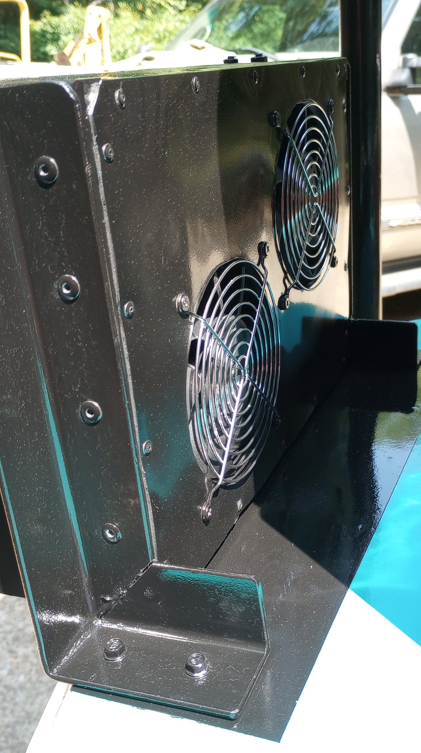

The small fans put out 300 cfm combined and only draw 1.5 amps combined.

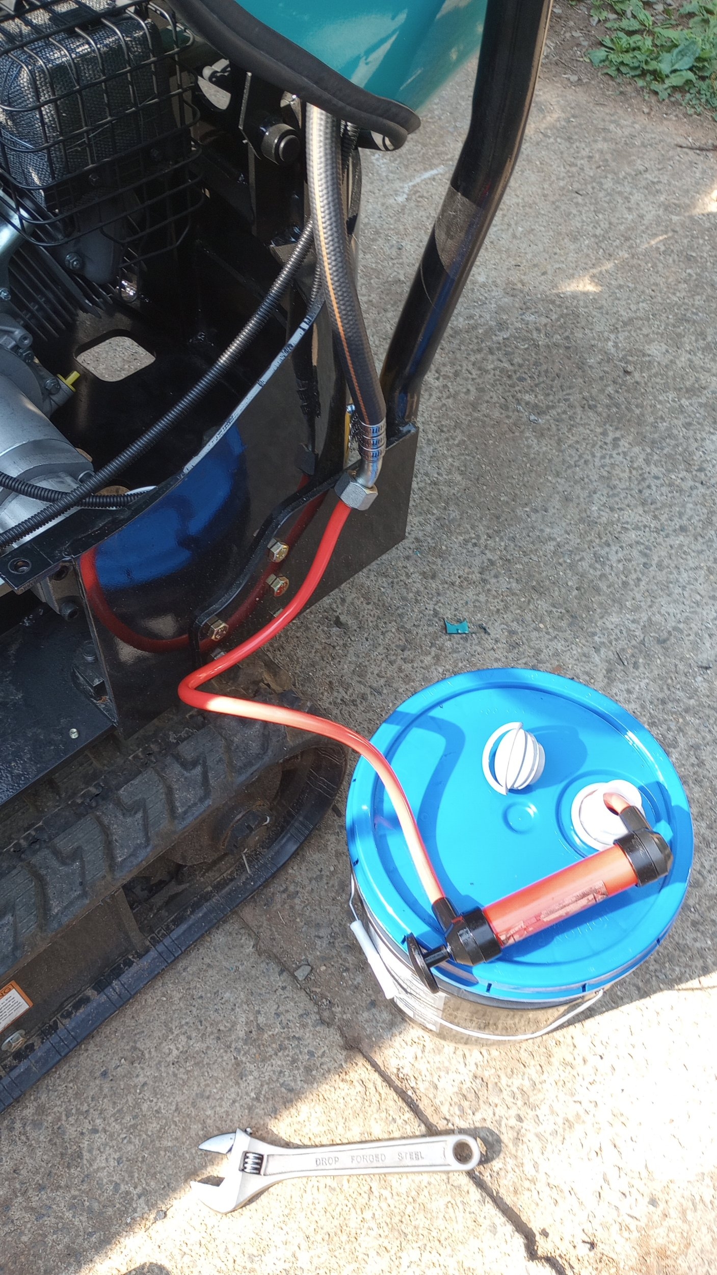

make sure to prime all your new oil filled stuff.

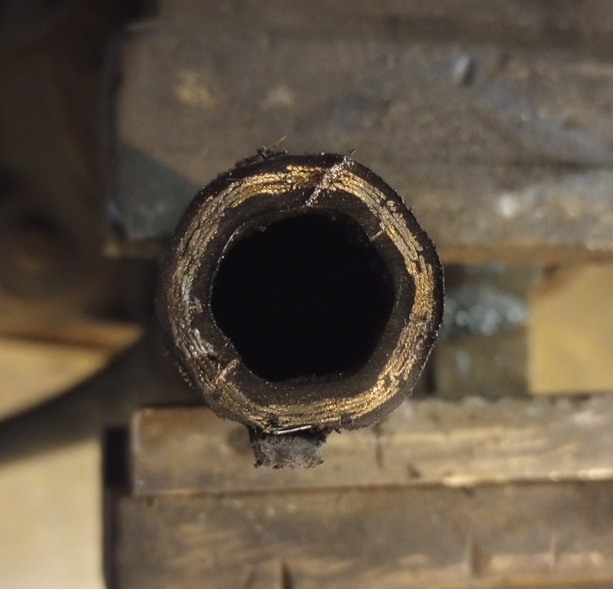

Here is the old suction line. Way over spec. Was able to reuse the old fittings , but it took some careful cut off wheel work.
Look at the cross section of " THAT! " hose . Hit it a couple times with an 8 # sledge and it kept its
original shape. Only way to cut it was with a grinder cut off wheel.
