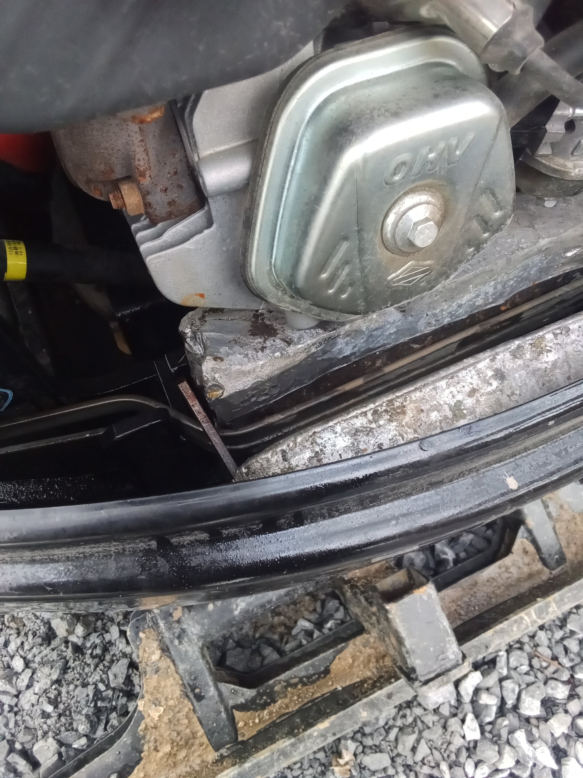

Just a note on this installation. The outlet line should be looped over the top of the cooler. Or the inlet and outlet mounted to one side with the outlet on top. Otherwise the oil takes the path of least resistance and possibly the cooler never runs full of oil.
It does make sense that the cooler should look more like a radiator with top and bottom inlet/outlet configuration.
From what i can tell all the small coolers are arranged like mine.
The coolers are small ( 11" x 12" ) and the plates are less than an 1/8" thick Od. I was more afraid that the interior volume was insufficient.
The volume of added oil was 20 oz. My oil temp went from 58c to 35c .
All this being said, if there was room to turn the cooler on it's side thus working more like a traditional radiator I would have done that.
The problem with this is the very limited room. you need to be able to access the inside of the dog house and running hoses that don"t become pinched , collapsed ,or fried by the engine or exhaust becomes a challenge.
None the less pmsmechanic you are correct.
