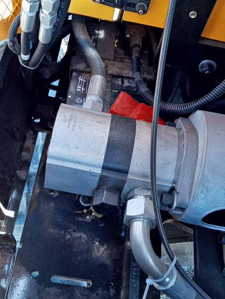

Straightening frame tails. They both consistently had bent a few degrees outward- I'm beginning to wonder if it wasn't from something like hard jump turns due to the consistent force they exert VS the inconsistency of binding the tracks up many times at random in both directions of travel.
Also, during removal and install of the tracks for this repair I had some trouble with binding the tracks again in both directions and to full stop, even at the newest high pressure setting of 2900psi 19.99bar.
There wasn't really any apparent side forces at play when binding/bound.
Either way a 4t chain binder pulled the frame in easily, and I added some 3/8" flat stock gussets top and bottom for now. Could be much more heavily gusseted but it was cold and windy and not close to any power for tools/welder.

Since you were able to bend the wheel motor tails back with just a come-along, my guess would be that you pre-loaded the track tension by getting debris under the sprocket teeth, then drove over something that pushed up on the bottom middle of the track, giving you increased tension. Looks like the moment arm between center line of the sprocket and motor mounting points is at least 2 inches. Gotta be hard on the motor bearings, too.

Thanks dkfrug, yes it could have been the binding coupled with machine weight coming into play.
I think this frame being a little longer and wider must be designed differently enough from most to have a weak area in design there.
The only other occasion I've seen of the frame bending at all was on another 'diggette' like mine. (I think I've just formally named the 'lil lass.)
One thing I will say is the frame was fairly stubborn- my first try was backing (travel motor first) into a tree about a dozen times. The momentum and travel power was expected to at least start flexing the frame back in but I couldn't even notice it move at all.
After that was a 20 ton jack and 40 ton sling strap to that same tree- nothing also, (due mostly to 5" jack travel VS strap stretch).
I skipped a comealong (have used them for mild autobody and frame pulling in past) right to the binder - no cable to stretch and I think it offers much superior reduction to go towards it's 4ton rating - guessing 10 to 1 over a comealong. First time ever using one and was impressed.
