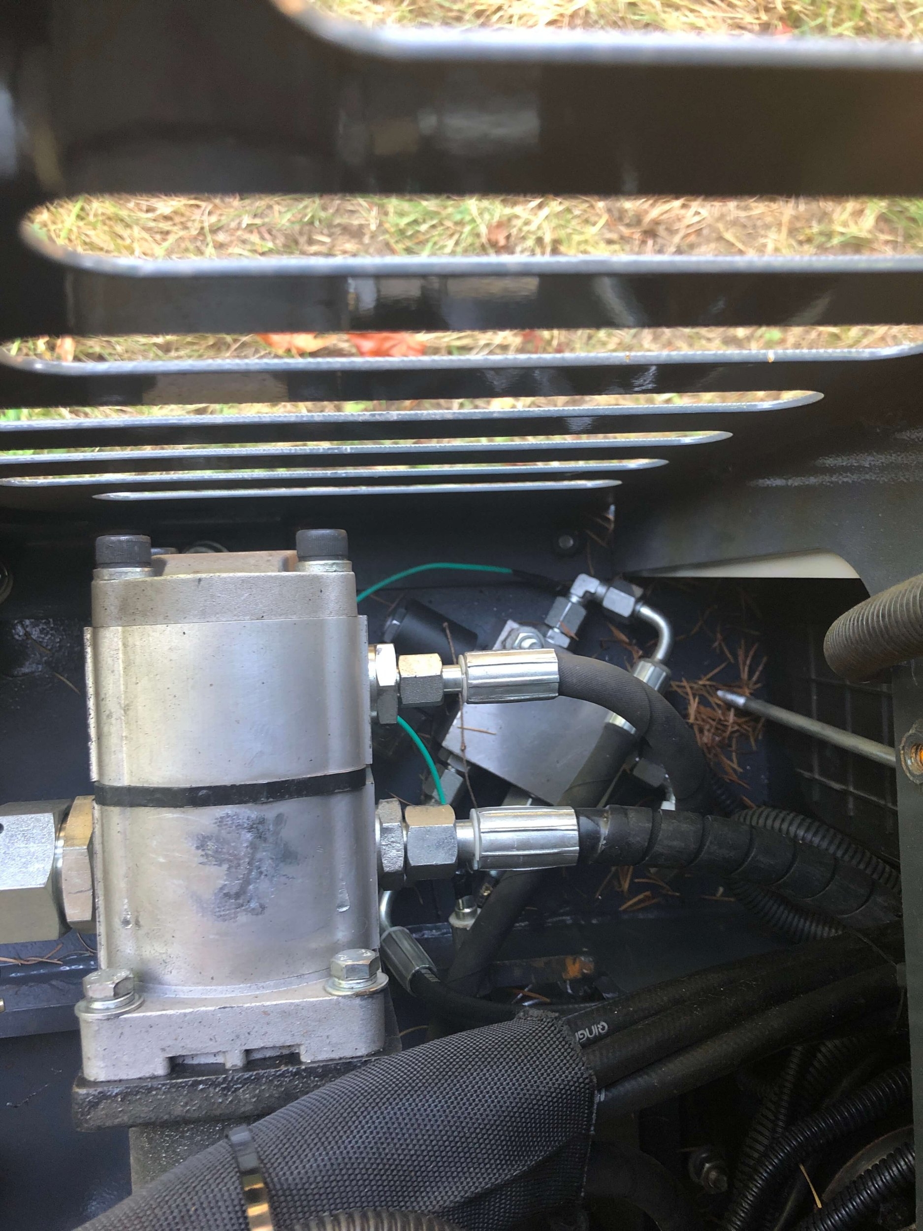

Hmm. Does your pump look like a 2-stage pump as in the EM15? With just one outlet?

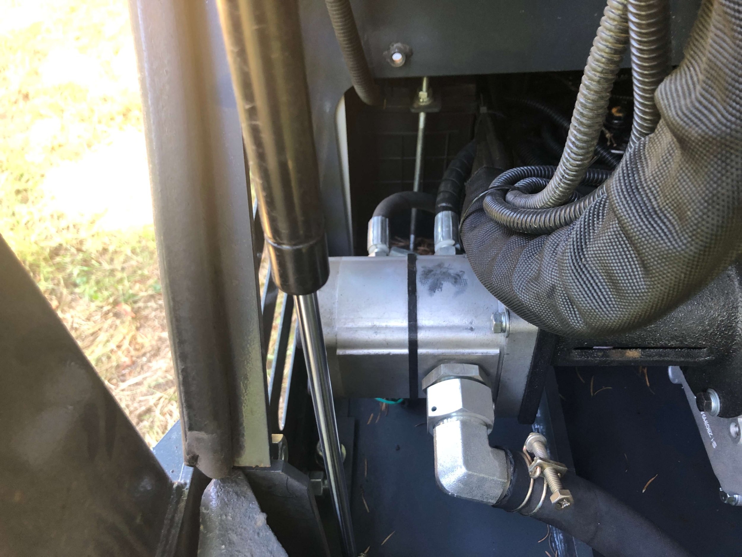

Two Outlets.
The outboard one goes directly to the pilot system. That system has a pressure relief and the interlock solenoid. This means the safety interlock ONLY locks out the main implement controls... not aux or travel.
Off the truck, the hydraulics were basically uncontrollable. I have about 30 years on excavators and, even though I know what this sounds like... I'm pretty good :). Running this thing made me feel and look like a rookie! I thought I just needed a bit of seat time but after a short while I realized that something was amiss. I spoke to my Finning Mechanic friend who suggested that the pilot system pressure may be set too high and was slamming open the servos. This was easy enough to test and so far made a huge improvement. I'm comfortable with Hydraulic systems, but admittedly a bit weak on the more complicated theory. I'm working with a couple pros to try to further tame this beast.

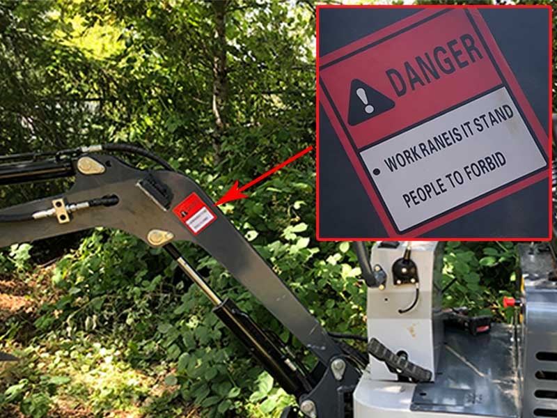

Can't make this stuff up. I didn't even notice this label until the machine was loaded in the trailer and I was halfway home. Clearly I have become complacent with warning stickers.
It is easy to laugh at this, but it really made me wonder... if these machines were able to leave the factory with no one noticing this, what else was missed? I know... it's assembled by non-english speakers but c'mon... how hard would it be to have SOMEBODY proof your work?
