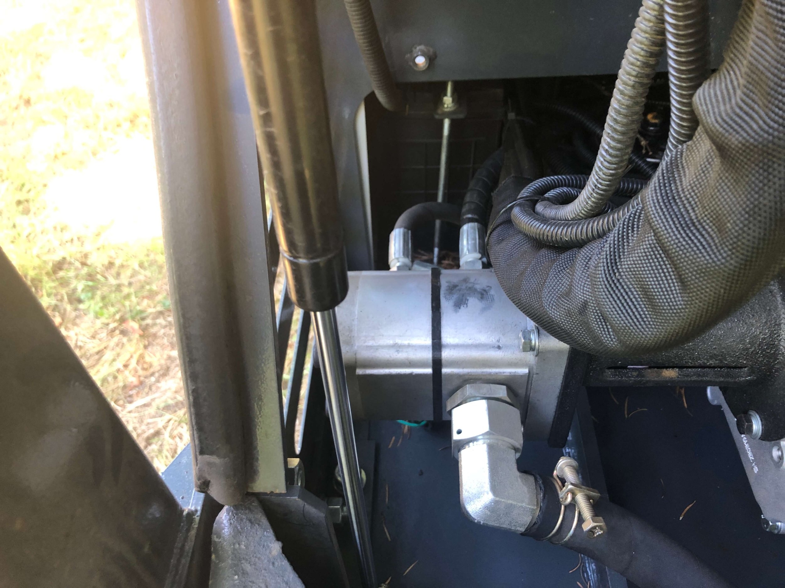

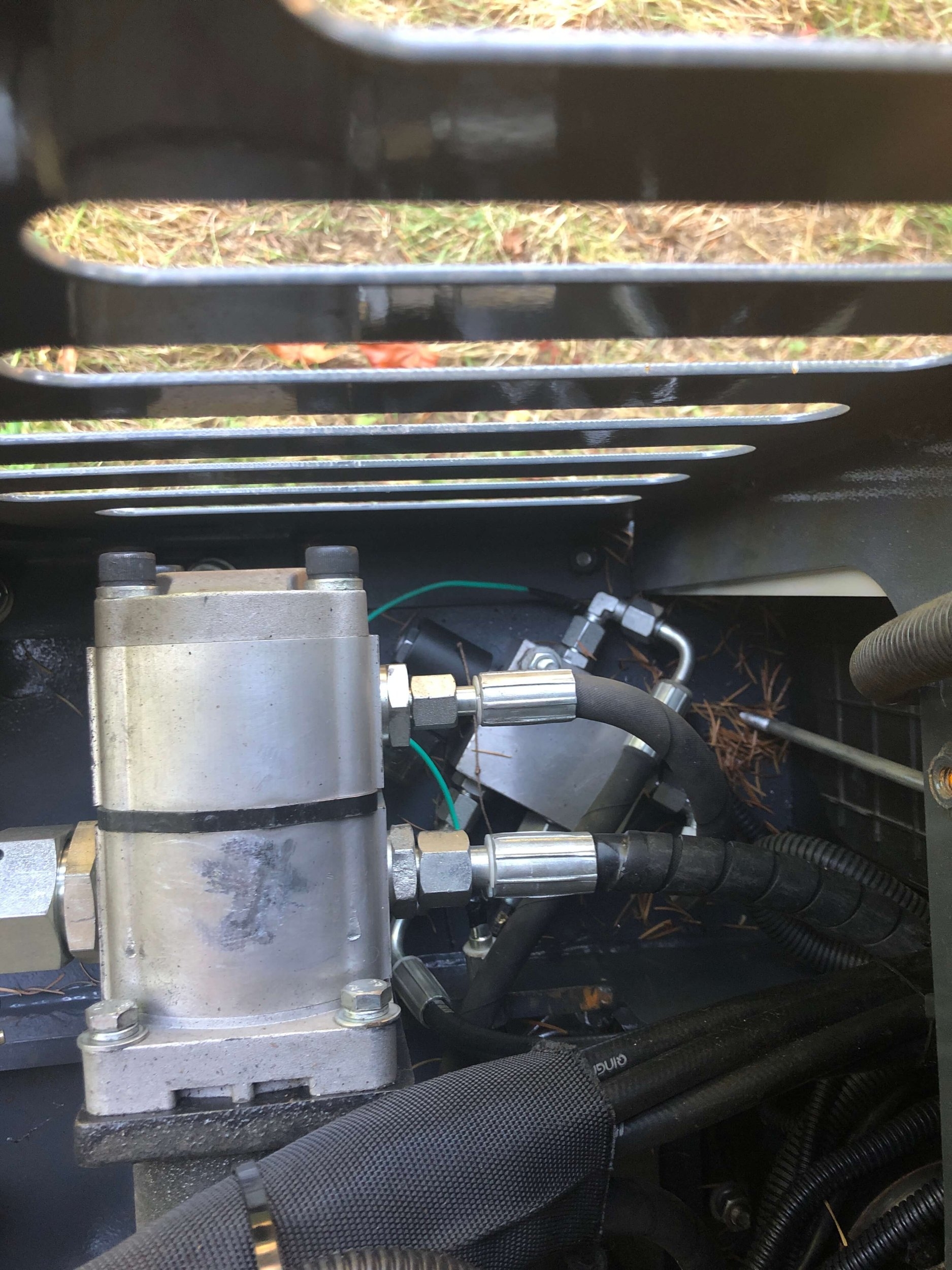

View attachment 813794View attachment 813795
Two Outlets.
The outboard one goes directly to the pilot system.
One more thing about your 2-pump system.
It looks like each chamber is about the same size, which would deliver very large volume to the servo system. That would mean that your servo system pressure should be pretty low, maybe as low as 500psi, in order not to deliver too much power to the actuators.
I suspect that is why the Diggit's servo system uses a flow divider, which could be set up to have a much lower flow rate to the servos, vs. the main valves.
Some pumps have a label on them with the flow rate stamped on it. Single stage pumps for these machines are usually about 6.5-6.8 cc/rev.
While the physical size of each section looks the same, the internal gears can be narrower for the pump of the pilot circuit. It's not uncommon for pump manufacturers do this, so they don't have to machine different length bodies for each pump size.
Yes, that is possible, and that is why finding and reading the label is important. Or taking it apart to see.
On the spare downsized pump we ordered from the maker (HeChuang), I took it apart to measure the volume, since there was no label.

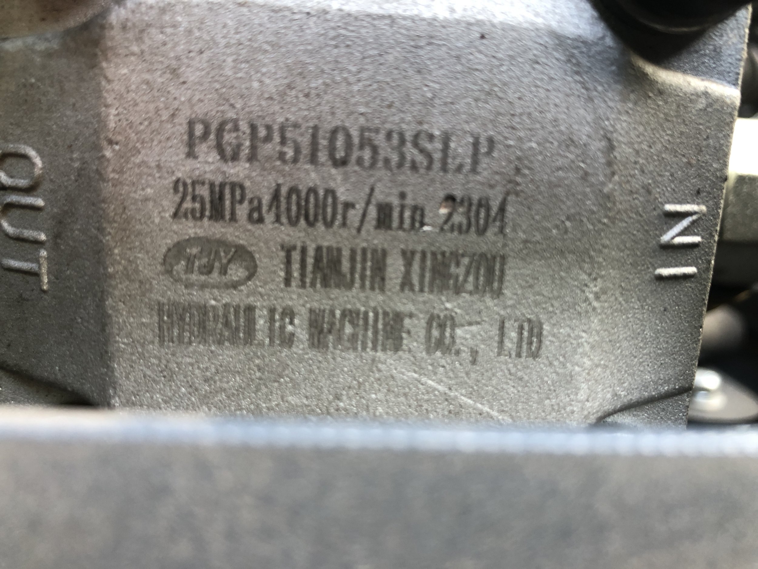

Thanks guys. I am working with my guy @ CAEL to get a manual or at least the proper component specs. The pump has a laser etched label which I'll attach here. I have yet to find product spec sheet. (admittedly, I have not yet looked very hard). If MPa = megapascal then I assume 3600 +/- PSI @ 1000RPM (?) But... flow?
