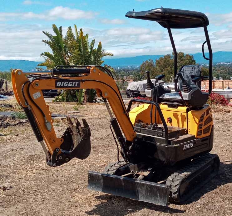

Here is the mini-X a friend just got, a Diggit EM15.
Interesting machine. It has a 43" wide blade, and it is 64" long, from tip of blade to end of track. The tracks look to be a bit longer than my XN08. I will post the track size later.
The boom is offset to the right a few inches, and there is no counterweight. Both are surprises. Sadly, no hyd oil filtration I can see. I suspect the weight is still about a ton despite slightly larger size, since there is no counterweight.
The biggest and most significant difference is the servo controls. They are hydraulic, not electric. Operation seems a bit smoother than the non-servo units I have driven.
More pix coming.

The Diggit EM15 was $5200 locally, at the big monthly Sacramento auction. They have 44 new Chinese minis for sale next week. Ginna be hard to beat what these go for, unless the seller uses a secret reserve.
A dual pump would only be of value if you have 2 independent valve stacks. So I can't see using one for a single directly-controlled 8-spool stack. The Diggit was a larger pump of unknown size, but used a flow divider to run the servos separately from the other directly-controlled valves in the 8-spool stack.
The Diggit build quality is only fair, tho better than the Oking units. The Rhino units so far (XN08) seem to be the best built. Rhino is huge factory, and not so likely to do-it-your-way.
