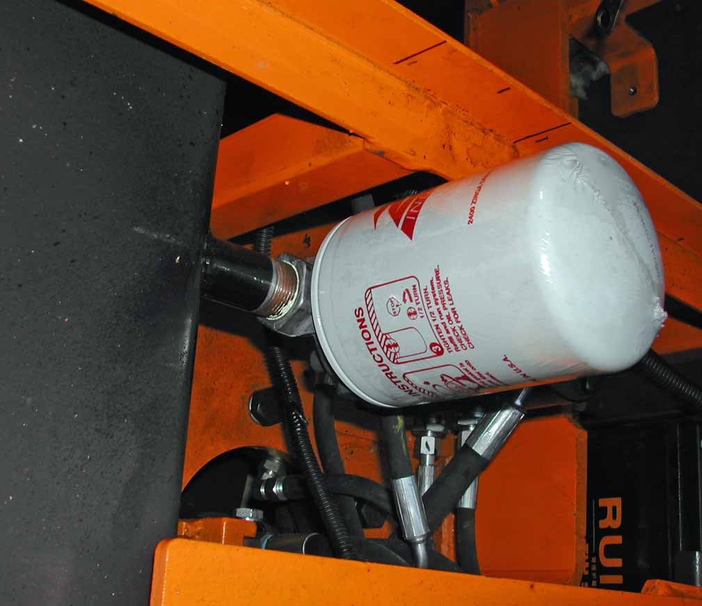

I would like to report more on the mini I purchased, but getting fittings to install the hydraulic filter from Discount Hydraulic Hpose has been an abysmal experience. Just ordered from Hydraulics Direct. Hopefully this order goes better.
   / Importing and modifying a new mini excavator from China
#766
I recommended Surplus Center above. The Zinga AE10 filter and Prince filter support are about $20 now, plus shipping.
Welding in a bung on the tank seemed easier that routing hoses and making a support for the filter fully inside the house.

I actually got the filter from Rural King. Box said it was a DeLavan brand, but the filter was a Zinga. Everything else I needed i got from Surplus Center.
I ordered the adapters this afternoon from Hydraulics Direct, they have already shipped and will be here Wednesday.
Discount Hydraulic Hose actually did something timely. My order was cancelled within 30 minutes of requesting a cancellation.

If you would describe how you intend to install the filter and the hydraulic hose plus adapters you are using I would appreciated the information. All too often people just say they bought what they needed without giving the actual parts used.
