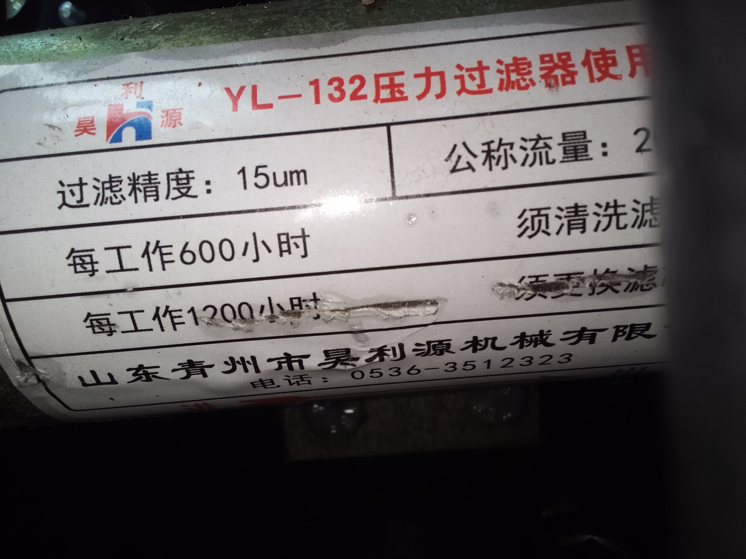

^^ I wonder how applicable cavitation is for these comparable tiny gear pumps?
Makes sense imo to have something to trap anything foreign right where it's introduced. Even just a screen in fill hole.
Brandonb, which are you considering, agt?
Here's pics of my stock one from diggit (nuoman, leking).
It might not flow full return well- this one is filtering 2 functions of 8 but I guess all fluid eventually goes thru it. Same premise as a cooler that cools but doesn't restrict full flow.
Translate shows the manufacturer- might be helpful to whomever you are buying from. It's beside the slew motor on the 'firewall'
