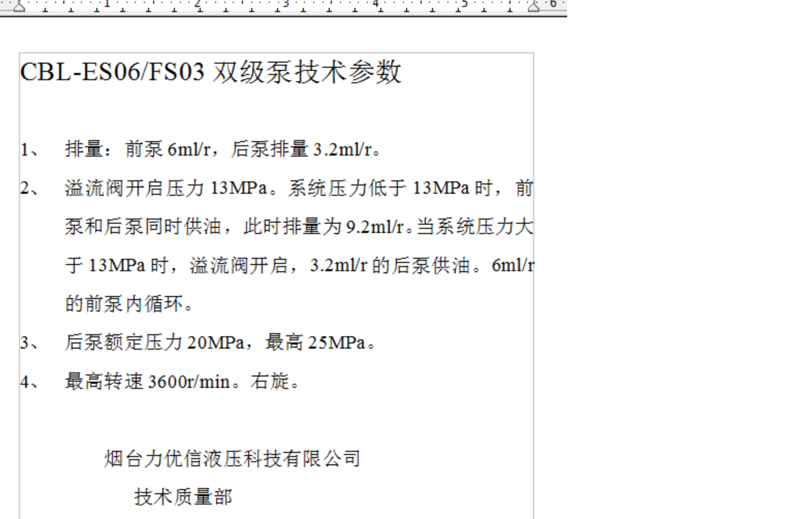

I finally got 'something' from them about diggit/leking 'YLYX' pump.
9.2ml total displacement (6+3.2)
Interesting. Did you get any explanation of all the pressure #s on the maker plate? I see 13MPa (1900psi), which I guess is the system RV setting. Seems low, while the 20 and 25MPa #s are crazy high (2900-3600psi).
If you have a 2-stage pump, you should have access to the full 9.2cc pump volume at lower pressures, but if you have a large pump with flow divider as I saw on the Diggit EM15 here, you would not. And I did not sense a flow rate change when operating the EM15 to relief.

Here's goog translate:
CBL-ES06/FS03 two-stage pump technical parameters
1. Displacement: front pump 6ml/r, rear pump displacement 3.2ml/r.
2. The opening pressure of the relief valve is 13MPa. When the system pressure is lower than 13MPa, the front pump and the rear pump supply oil at the same time, and the displacement at this time is 9.2ml/r. When the system pressure is greater than 13MPa, the relief valve opens and the 3.2ml/r rear pump supplies oil. 6ml/r front pump circulation.
3. The rated pressure of the rear pump is 20MPa, and the maximum pressure is 25MPa.
4- Maximum speed 3600r/min. Right rotation.
Yantai Liyouxin Hydraulic Technology Co., Ltd. Technical Quality Department
Compared to two stage pumps on amazon etc, the rv setting (which I still assume is adjustable) is already like 2-3x higher, while the total flow/displace is kinda lowish.
Perhaps after playing with settings it'd be fun to try a 14 or 16 gallon two stage with similar total pressure and similar rv setting capability
If I had a single pump I might wanna try an amazon two stage for < 200$ also. My travel controls aren't pilot and they do fine with the dual flow/speed.
I think a pressure gauge and adapter(s) is prob a good investment for adjustments and eventual troubleshooting
OK, I see. The 20 and 25MPa specs are just the ratings of the pump. RV for the system will still be about 2400-2500psi. And the 1900psi for the 2nd stage cutoff makes sense, too.
You should not do anything until you get a gauge and adapter to test and adjust the system RV. I suspect it is set low, and possibly close to the 1900psi setting, which is not what you want.

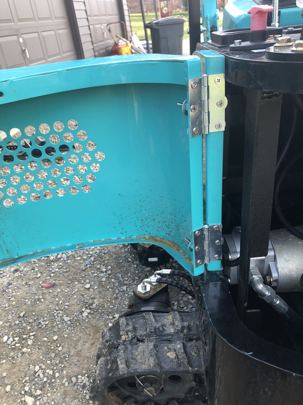

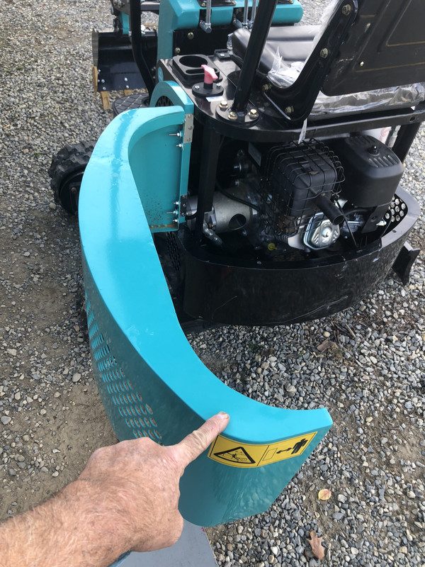

I added hinges to the rear cover yesterday to make engine access vastly better. Also a pic of the hydraulic filter I had previously added. With the rear cover hinged, I can move the filter further to the rear.
Good mods, Rich. Have you checked RV pressure yet?
