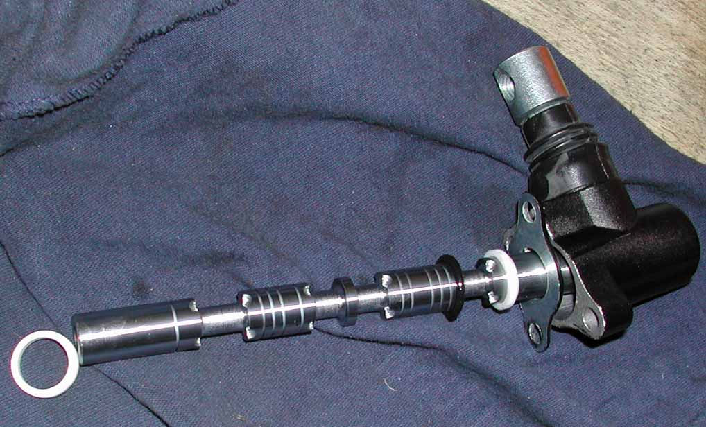

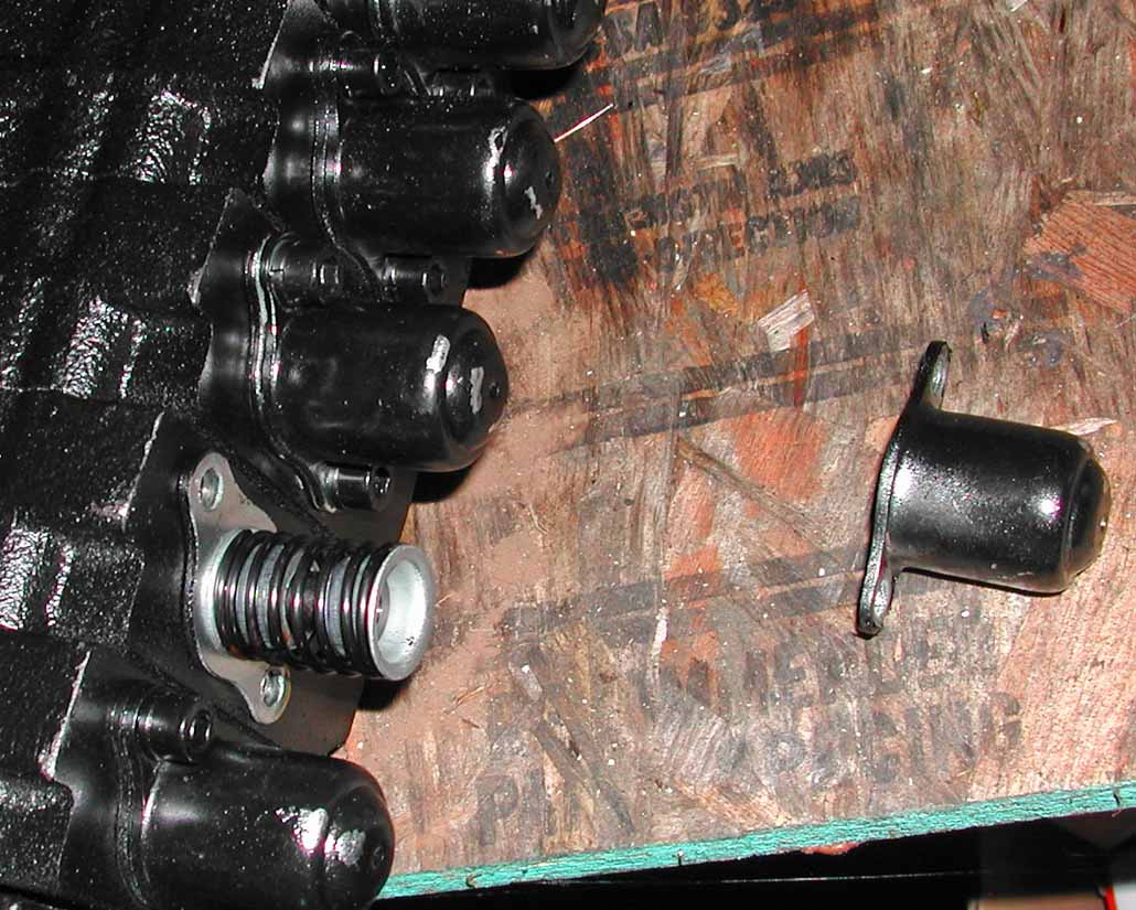

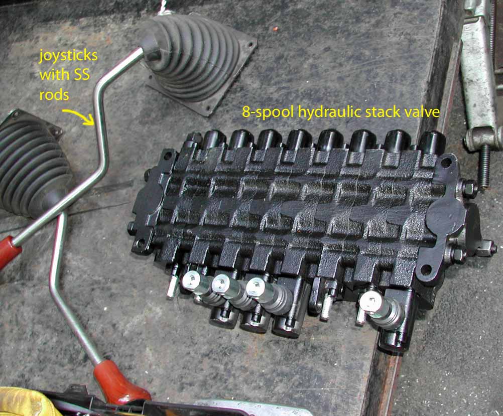

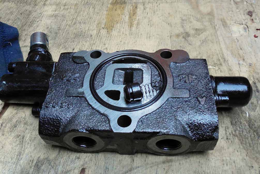

As mentioned above, I traded an extra stack valve for my missing engine. The
engine has a list price of a bit less than the stack.
When it did not work initially, I opened up my spare to see what was going on. That
was when I figured out where the IN and OUT were, and they were connected backwards.
You can see the load-check valve, which I removed for the photo. Plumbed backwards,
no flow would go to the tank when expected.
The spool looks good, with ramps on the lands to assist with feathering, or gradual flow
changes. Nice.

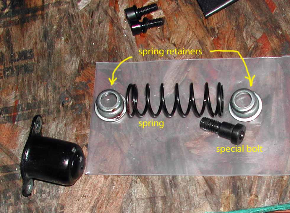

My AUX valve section (shown) I took apart to see what it would take to convert it from
detented to spring-centered. I have ordered those parts, but have not received them yet.
The change over looks easy. I definitely do NOT want a detented valve for the hydraulic
thumb I will add later.

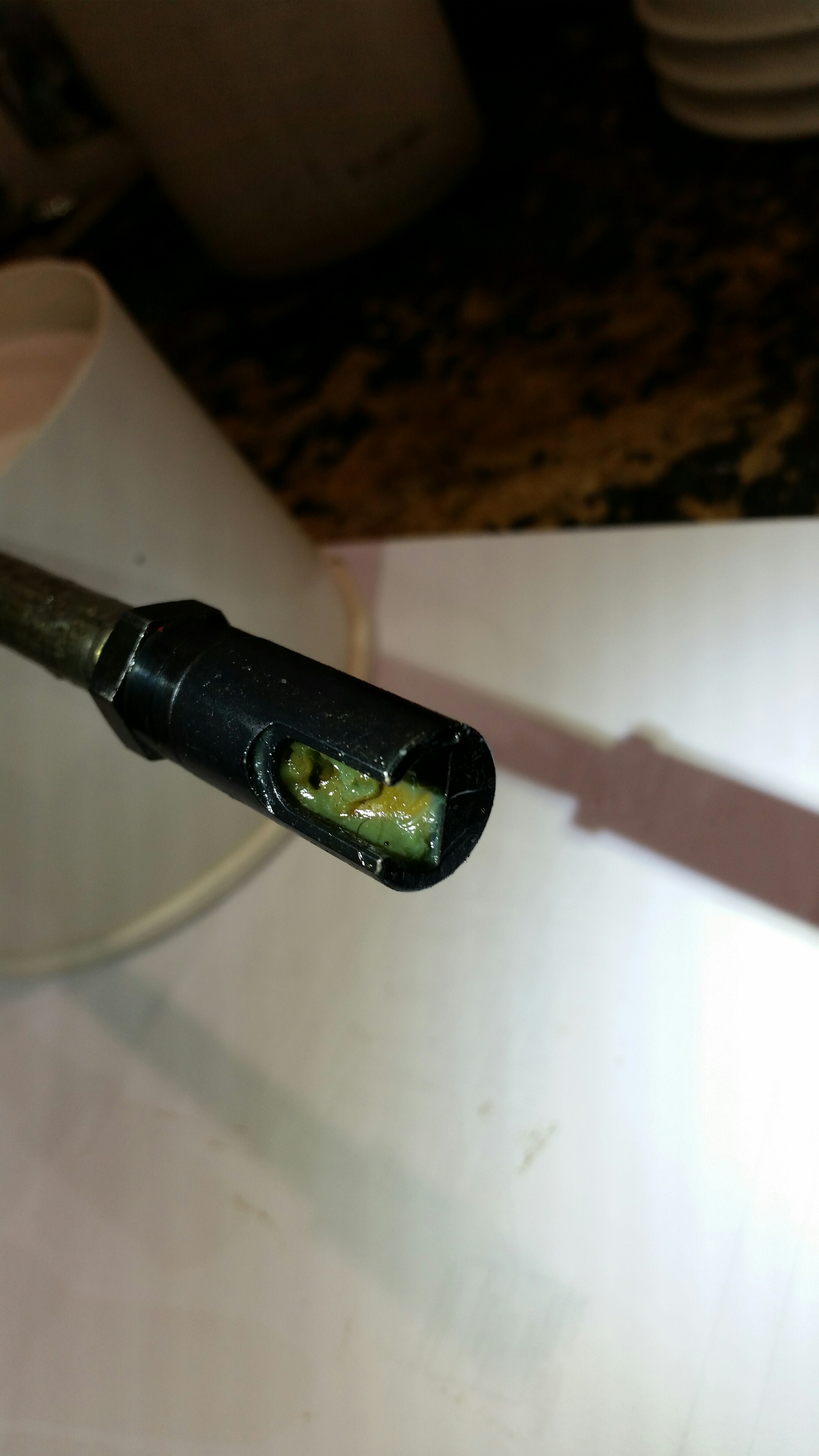

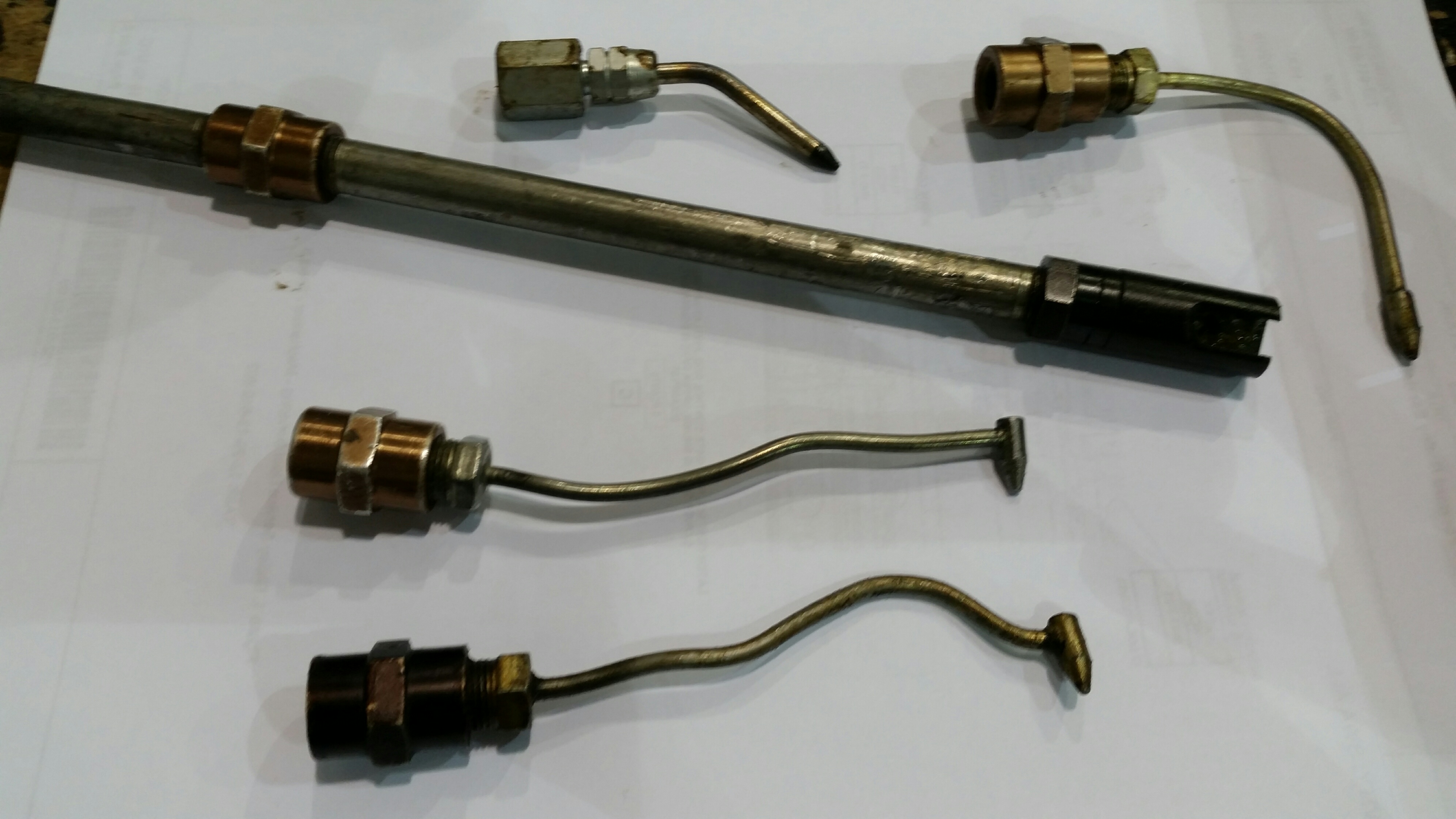

At work, we have zert fitting grease gun fittings that will slide on, 90 Degrees to the zert. One side is cut out. You only need about a 1/4 inch to push on. It doesn't lock as good as a zert coupler, but does the job.
We also have 90 degree flush adapters when a straight one won't work.
I'll try to remember to take a photo of it tonight.
hugs, Brandi
   / Importing and modifying a new mini excavator from China #84
Here is the 90 degree zert coupler I use at work and sometimes on my Mahindra's steering cylinder zert.90 Degree Grease Coupler.jpg
Also the 90 with various needle fitting adapters.90 With Needle Grease Couplers.jpg
hugs, Brandi
#85
Also the 90 with various needle fitting adapters.View attachment 567012
So those 90-degree needle fittings for your grease gun require some tool to apply pressure at
the head so grease gets injected. Looks difficult. Thx for posting, Brandi.

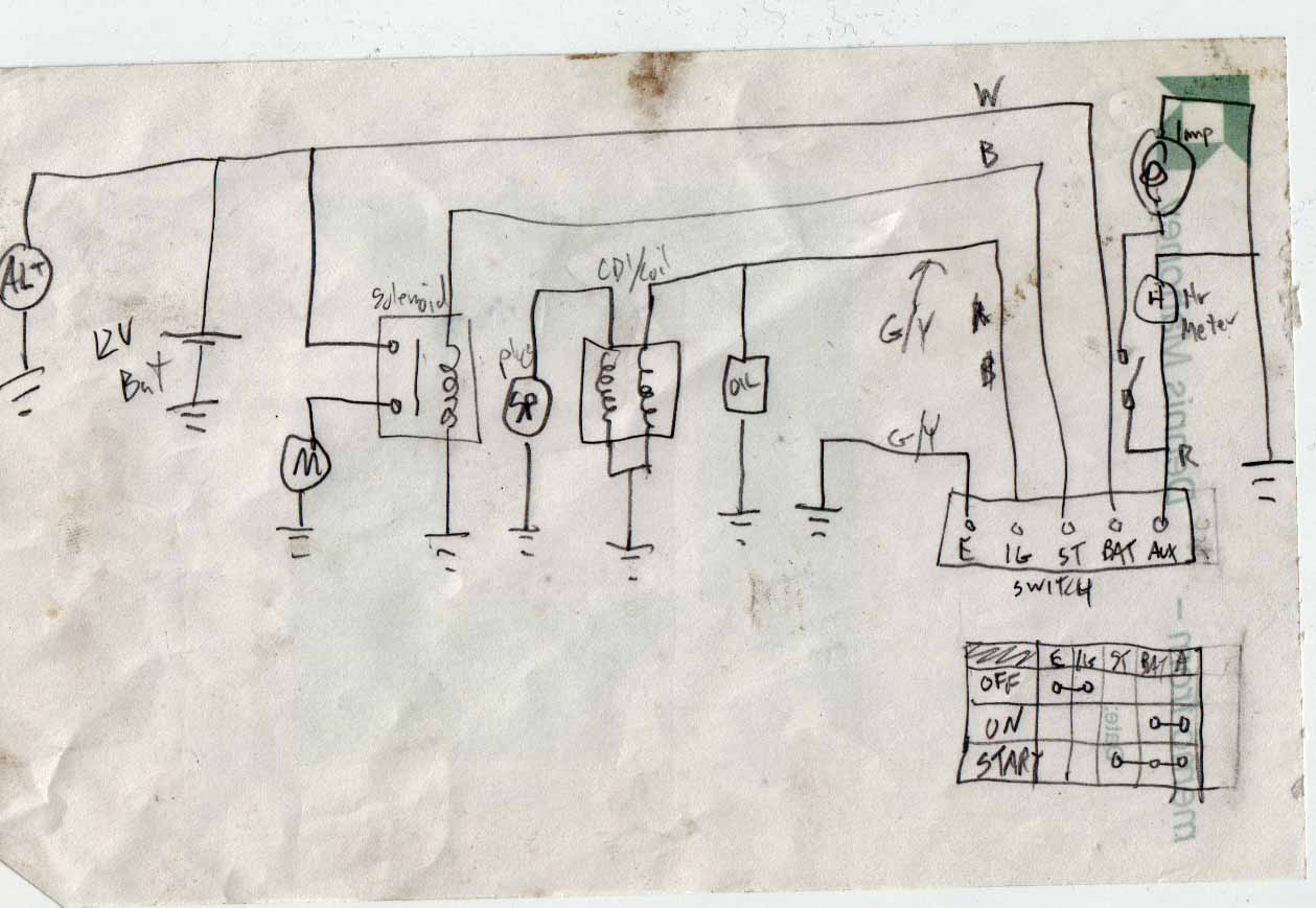

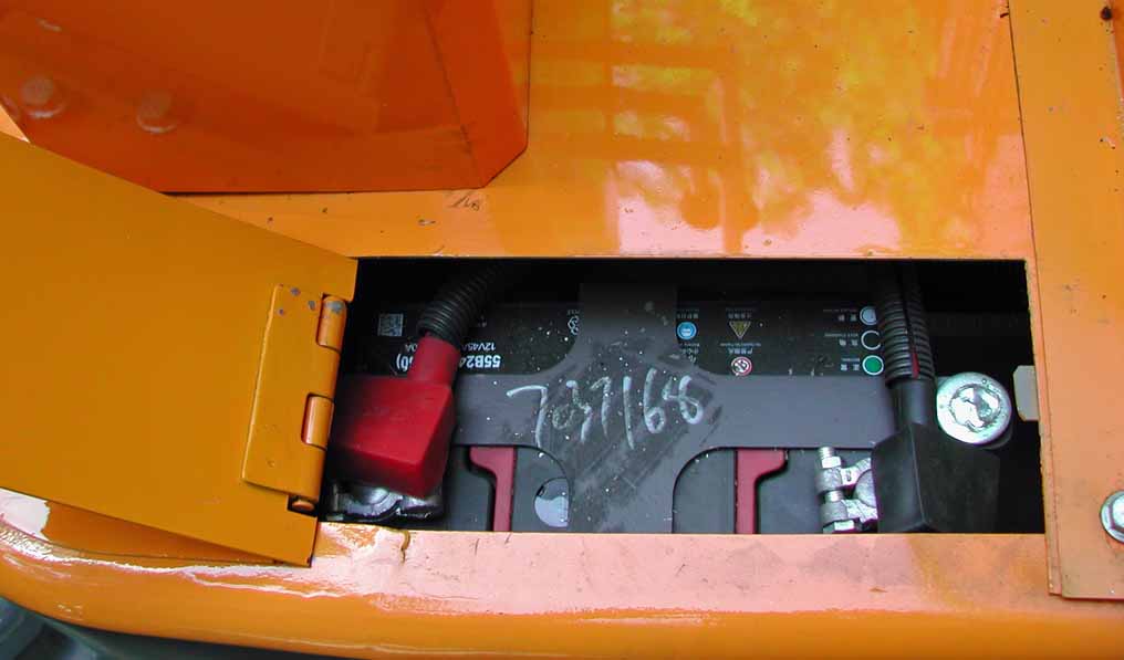

A few more comments on the electrical system:
A small car-sized 45Ah battery resides below the floor. It is somewhat accessible thru
a hatch, but the battery is larger than the opening, so the side panel must be removed
for replacement.
I had to redo the electrical system to provide a way to kill the gas engine. Small gas
engines are usually shut off by grounding out the ignition. Diesels are killed by shutting
off the fuel, in this case, mechanically. I also needed to provide switchable power so the
hour meter works and the work light is enabled only when ON.
The XN08 starter switch is better than the ignition switch from the gas engine, and it
provided an unused connection to kill the engine. Nice. I scribbled up a new schematic.
The boom-mounted LED worklight is a nice feature and quite bright. It consumes only
about 600mA, which is slightly less than the gas engine's alternator output.
The 90 degree needle fittings won't grease at all if there is any resistance. You have to hold pressure with your free hand to get grease in. Then, there is that squirt your face factor increasing
hugs, Brandi

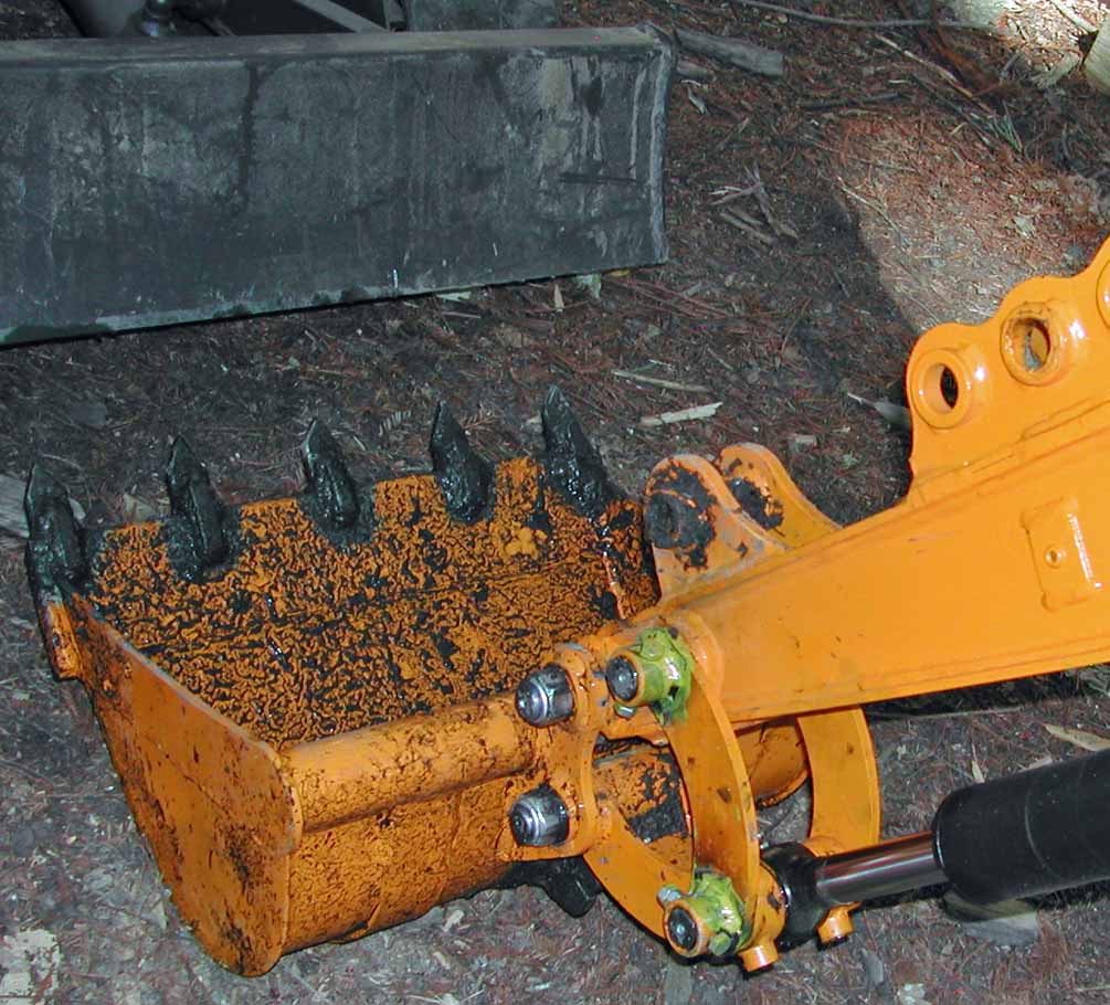

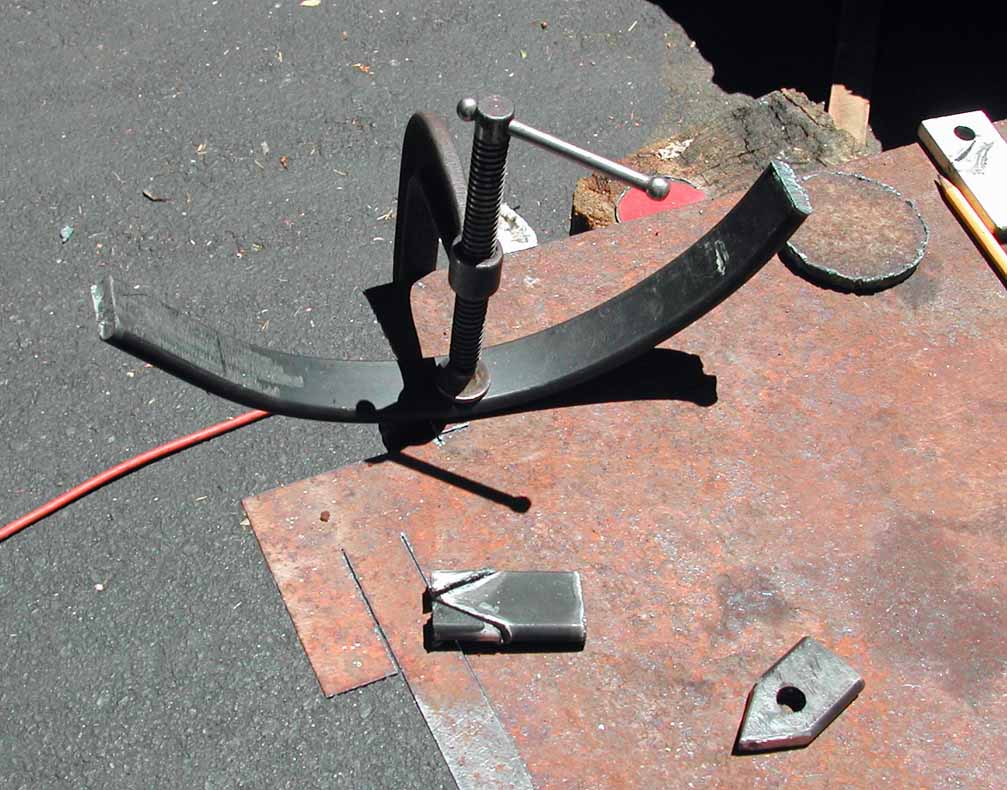

Before I got to using the mini-X, I installed the larger bucket and removed the mechanical
thumb. There were no teeth on this optional bucket, so I made and installed my own.
I thoroughly dislike the soft cast steel teeth that often come on low-priced equipment. They
are just too dull, and don't hold a point or edge. Years ago I tossed my cast teeth that
came with my Bulgarian backhoe and made up weld-on tooth holders. Then I used crimp-on
replaceable teeth with very tough steel cutting edges. Works well, but I have never
replaced the teeth.
So this time, why not just directly weld on some tough steel teeth? No tooth holders at
all. If I wear them out, then I will cut 'em off and weld on new ones.
So here I am, cutting some teeth out of a rake tine. The tine was about $10, new, from
Agrisupply. The bucket photo is after my first test dig. I will see how they hold up.

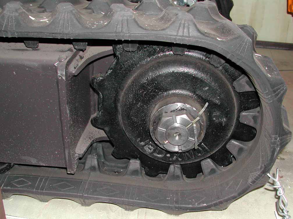

So here is where I cap things off with the videos I posted on my Utube channel.
A few notes on using this mini-X: with 2400psi and 3" cyls, this machine can
really pull itself around, even with the dozer blade dug in. The hyd pump is more
than big enough to generate decent flow even at 2500RPM or so. The only
thing that is slow is the drive speed. The wheel motors are enormous.
Getting the oil too hot by running long periods on hot days will be an issue. An
oil cooler would be a great upgrade. Larger units from China seem to provide
coolers and better filtration. Both are necessary for this machine to last.

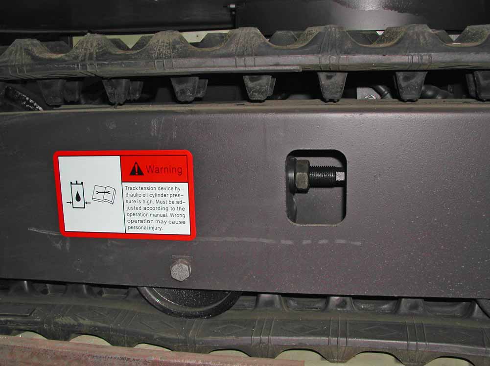

I have not tried out the track adjustment. It is mechanical, not hydraulic like you
see on name-brand excavators. Larger Chinese units do have hydraulic adjustment.
These small Honda-clone engines have no oil filtration (even on Hondas), so frequent
oil changes are a good idea. I plan to install a drain valve to make this easier. The
engine runs great, tho it generates some sympathetic vibrations that cause rattling
at idle. I will install padding to fix this next time I have the rear panel off.
