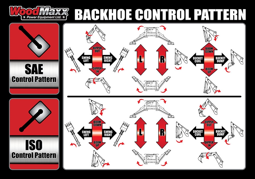

Earlier you mentioned you changed the controls from default excavator to backhoe configuration. Could you explain the difference? Thanks.
   / Importing and modifying a new mini excavator from China #97
There's two different standard configurations for the joysticks and what functions they control.
#100
MOSS has it, with a nice diagram.
ISO is what is sometimes referred to as "backhoe" style, while the SAE pattern is for excavators. I have many hours on my backhoe, and there is no way that I am gonna have 2 different configurations here. Note that excavators sometimes have a boom swing as well as a house rotation action. The simple XN08 has only the house spin, so I am using the swing function for that.
The change is easy: just swap 4 hoses. Some other machines even have a selector valve to make this change by just flipping a lever.
