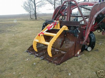

You may have to do some trial and error for best application. The teeth should just touch the point of the bucket. I believe this picture is one of those grapples on Ebay.

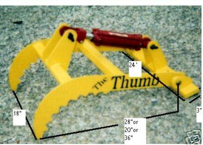

This picture is the one on Ebay # 7577336746 at $349.
It would appear that the grapple can be ordered to fit your bucket. I would email the seller and ask some questions. If you have the bucks, you could put two of these on your bucket, and independently control them with two valves.
