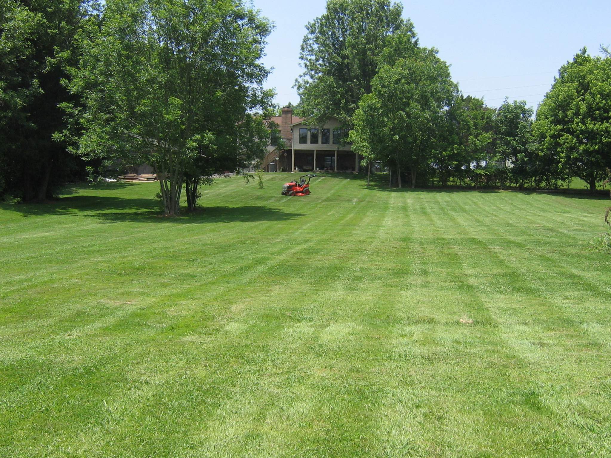

Many if not most of the brand new MMM's need to be properly setup on the tractors they end up pairing with. Dealers may or may not do this and just deliver the MMM installed with whatever adjustments were made at the factory.
My 2004 BX23 gives a nice finish mow and has since I properly adjusted it as described in the manual.
Tire pressure has alot to do with the finish cut also.
Adjusting the MMM isn't hard to do on a BX.
Make sure the tires are at the proper psi.
I made up a serviceable blade gauge out of cardboard. Basically you turn the outer blades side to side and measure the blade tips to ground on both out sides. If one side is higher than the other adjust until they are equal. With that done turn the blades front to back. Measuring from the center blade measure the leading tip to ground and then the trailing tip to ground. The leading tip should be approx 1/4" lower than the trailing tip.
A critical mistake some folks do is make their measurements from the deck as opposed to the blade tips.
Kubota does make high lift blades and there are several aftermarket brand of blades that are good as well, i.e. gatorblades.
I use gatorblades on mine.
Generally MMM's are shipped with Kubota's std lift blades.
Good luck
Dave
