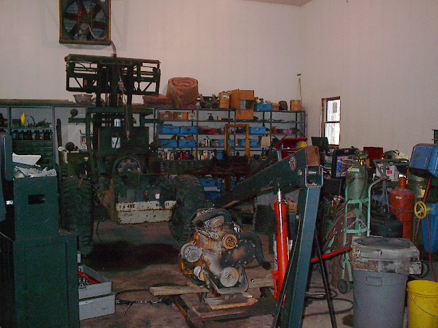

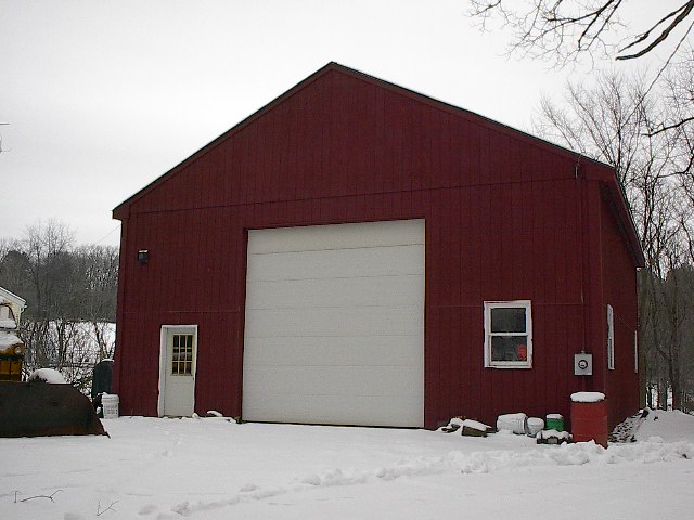

I built this 36x40 x16 w 14x14 door 2x6 construction alaskan slab and heated it oil fha unit heater had 2 ceiling fans to bring heat back down ran rebar all along outside and welded it all together had some mylar I got for free put that down first then insulated with foam lifted wire up with bricks and poured floor.
BTW as you can see there is a large exhaust fan in the pictures used it in summer to circulate air in shop and to remove smoke in winter while running equipment leaving the small door open I had to hook up switch so that either the fan would run or furnace but not both as it would suck the flame backward through the burner,
