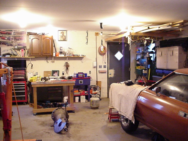

attachment.php
I built a 24x32 CMU walled shot 16 years ago, It was non insulated.
The slab had 3 loops of Poly from "radiantech"
I then installed a 20 gallon oil fired water heater, circulation pump tied to
T-stat.
This worked perfect, I kept the T-stat at 45-50 deg in winter and it was WARM in there.
Slack
