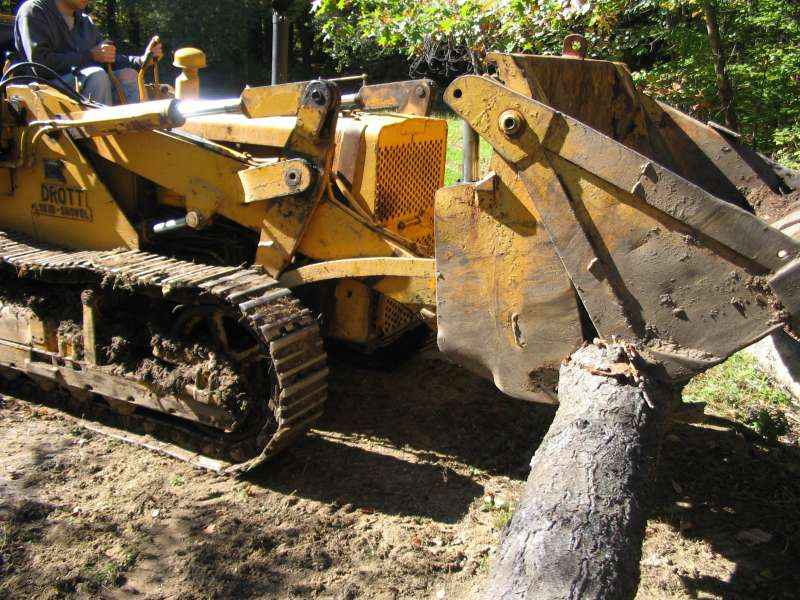

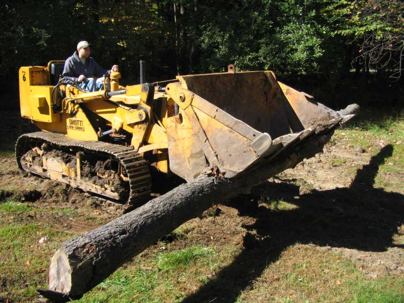

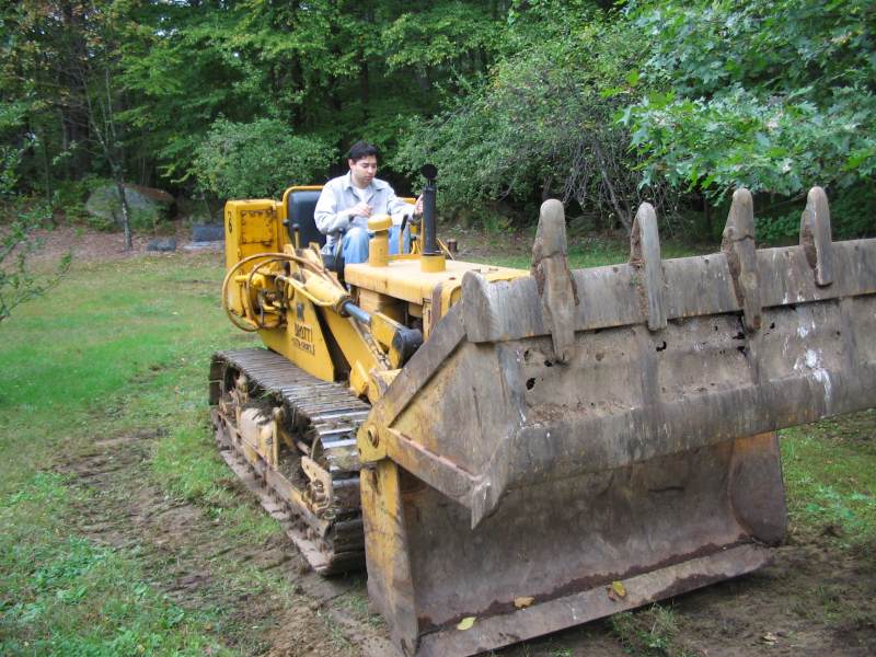

Now here's a REAL 4-in-1 setup in action. :p :D
