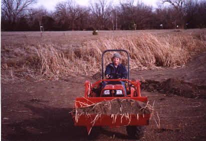

Hi, John, hope you had a great Christmas, Oh, it is a long and entangled story. I probably cannot keep both tractors permenant but for now I do have two. My sister will probably aquire, eventually, the BX for her husband and herself now that they have bought property, built a house and are moving their three horses to a new barn there. Since their main needs are MOWING and manure moving and property upkeep and building flower beds and landscaping and drainage control on 5 acres and they have a wonderful concrete pad in the warm, dry barn for it I may (?) sell it to them---eventually---. On the other hand, I too have aquired additional property here so two tractors could be useful. Just do not know. Right now I am having a Tractorfest running the two machines through their paces.
One thing RET that I should mention to be fair, I have become one with the BX and the 2410 is still odd (new) to me so in time I maybe as quick with it as I am now with the BX, my wife is the one who said to me that it was clear I was faster on the BX with the FEL--and let me tell you this--I need a digital camera----the lift height is virtually the same and I think without measuring it the reach at mid lift maybe greater on the BX. Neither one really get it up high enough to dump over into a high clearence vehicle (4X4 truck), both will cover a contractor wheelbarrow up with one bucket load (some exaggeration)!!!
J
