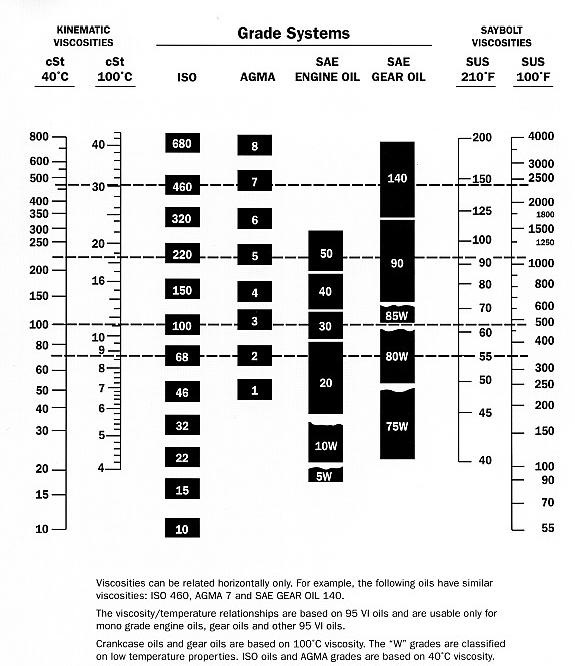

Fluid Viscosity Limits @ 230ーF [110ーC]
Optimum SUS [cSt] 70 [13]
Minimum SUS [cSt] 55 [9]
This is not an OEM pump. It's actually a variable displacement piston pump. There will be lots of body, and hydro modification to this tractor.
This is pretty heavy oil, more like about a xxw60 (rated as a motor oil, not at the 100 F most hydro oils are rated at). It could get VERY viscous at cold temperatures. I'd be very leary of raising the pump above the manufacturer's 18 inches. The suction line would need to be fairly large to keep from having a lot of friction pressure drop. I don't think most hydro oils are this heavy, more like about xxw20 rated as a motor oil.
Ralph
   / Inches of mercury conversion to suction of oil #20
ISO 32 hydro works in most tractors in most weather. 15w-40 works fine in my T5C when it's too cold to dig, warms up just fine as expected.
