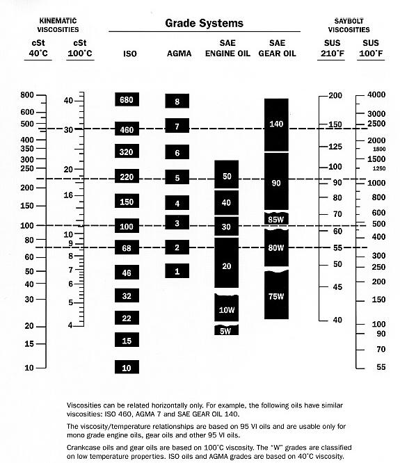

Might be a tad lighter than xxw60, more like xxw40 based on the chart PutnamVistor posted, e.g. 14 cSt @ 212 F and 135 cSt @ 104 F. Still plenty heavy.
I'd find some of that ISO 32 stuff.
