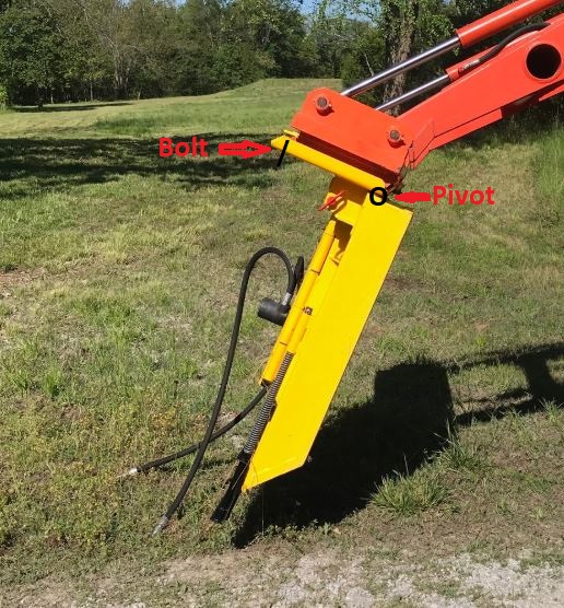

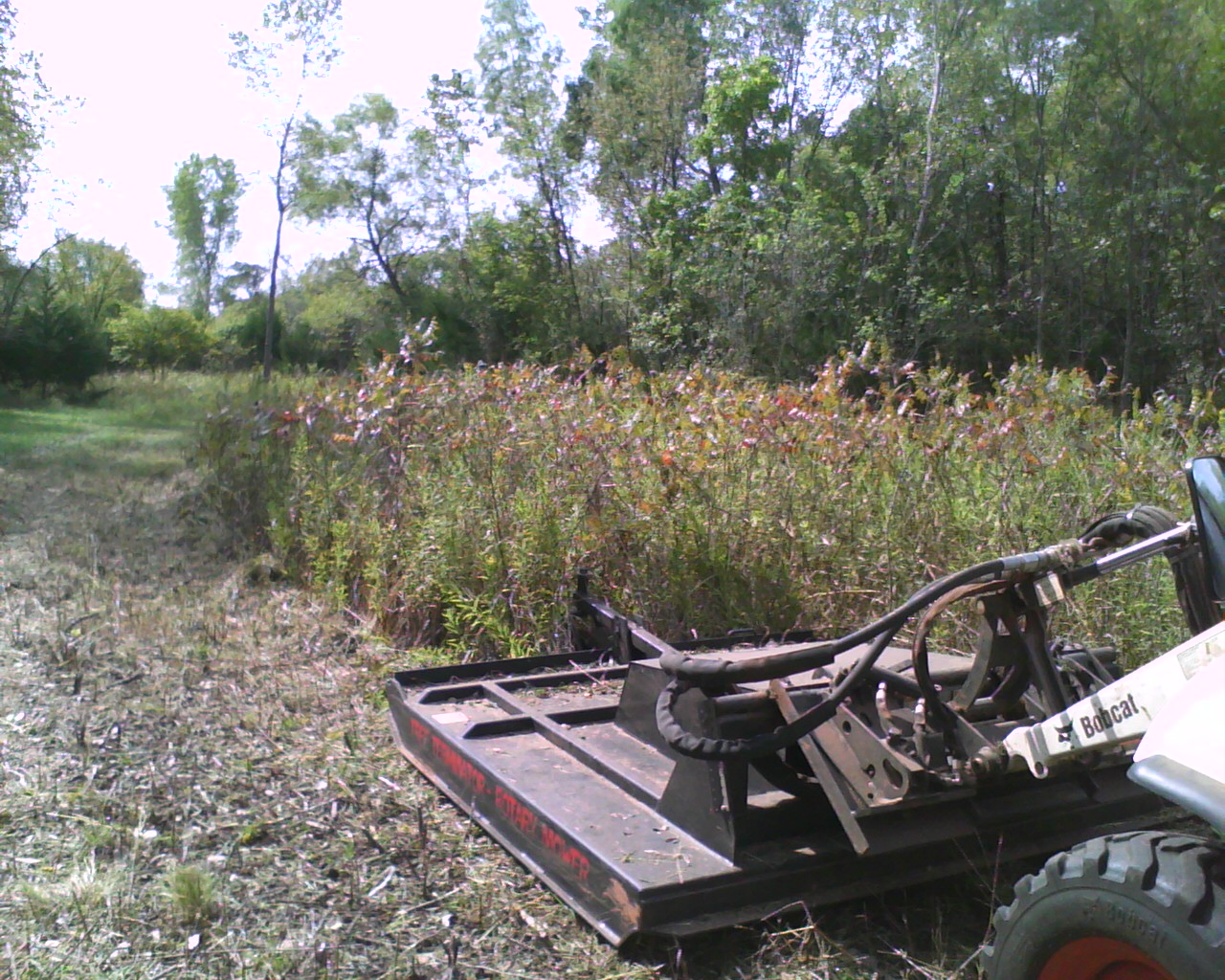

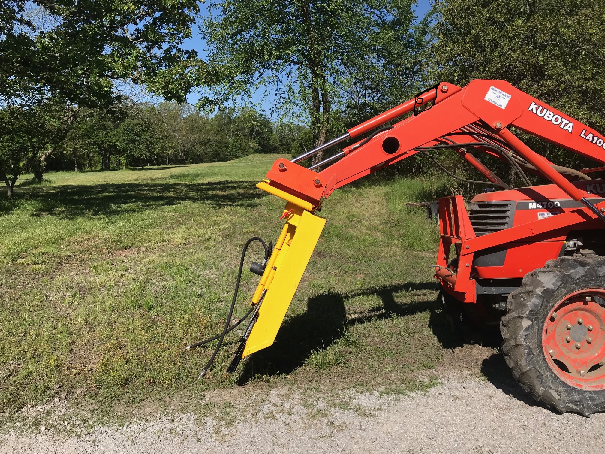

   / Increase Kubota FEL tilt #30

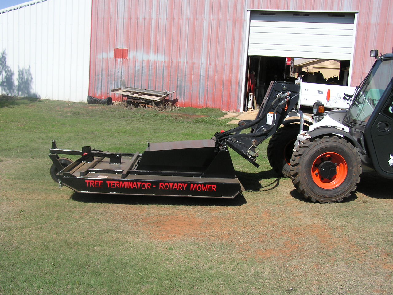

My brush hog has a hinged SSQA mount plate:
You could make one on your mower with the hinge pin at the bottom and a way to lock the hinge while using:
Then sell the idea to Trailblazer. :thumbsup:
