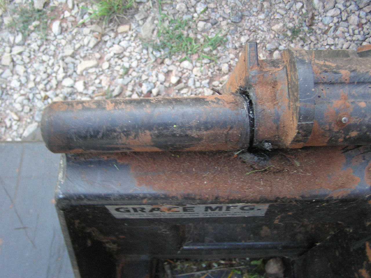

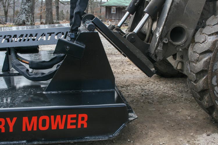

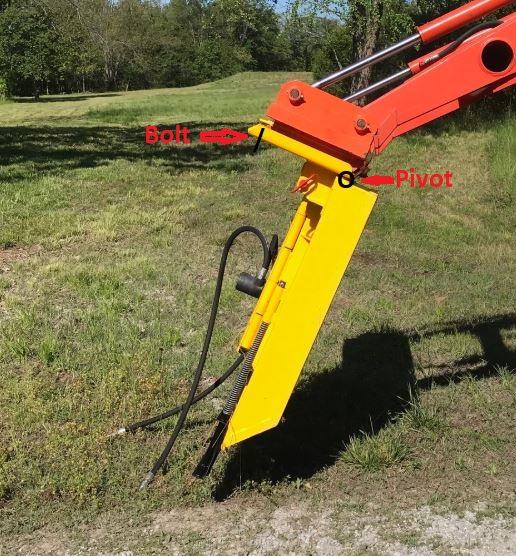

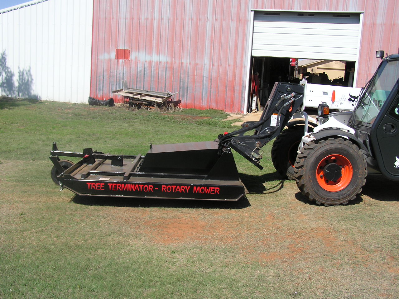

My brush hog has a hinged SSQA mount plate:
View attachment 655155 View attachment 655157
You could make one on your mower with the hinge pin at the bottom and a way to lock the hinge while using:
Then sell the idea to Trailblazer. :thumbsup:
Yes, that's another way to play the ssqa adapter plate. Did you make yours? Can you take another picture or two, close up, showing your pivots, etc? I'm definitely working through quite a few strategies...!

   / Increase Kubota FEL tilt #33

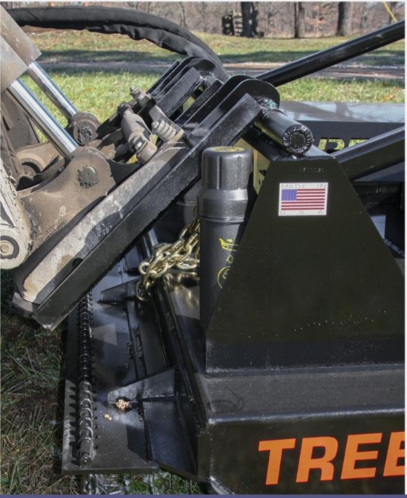

Did not make it. It is made like a door hinge. The attachment plate is welded to the hinge.
One way to do what you need is it buy or make another attachment plate and hinge it at the bottom.
Pictures from Grace MFG Website:
And mine not connected, looking from the front. The attachment plate is at the back right:

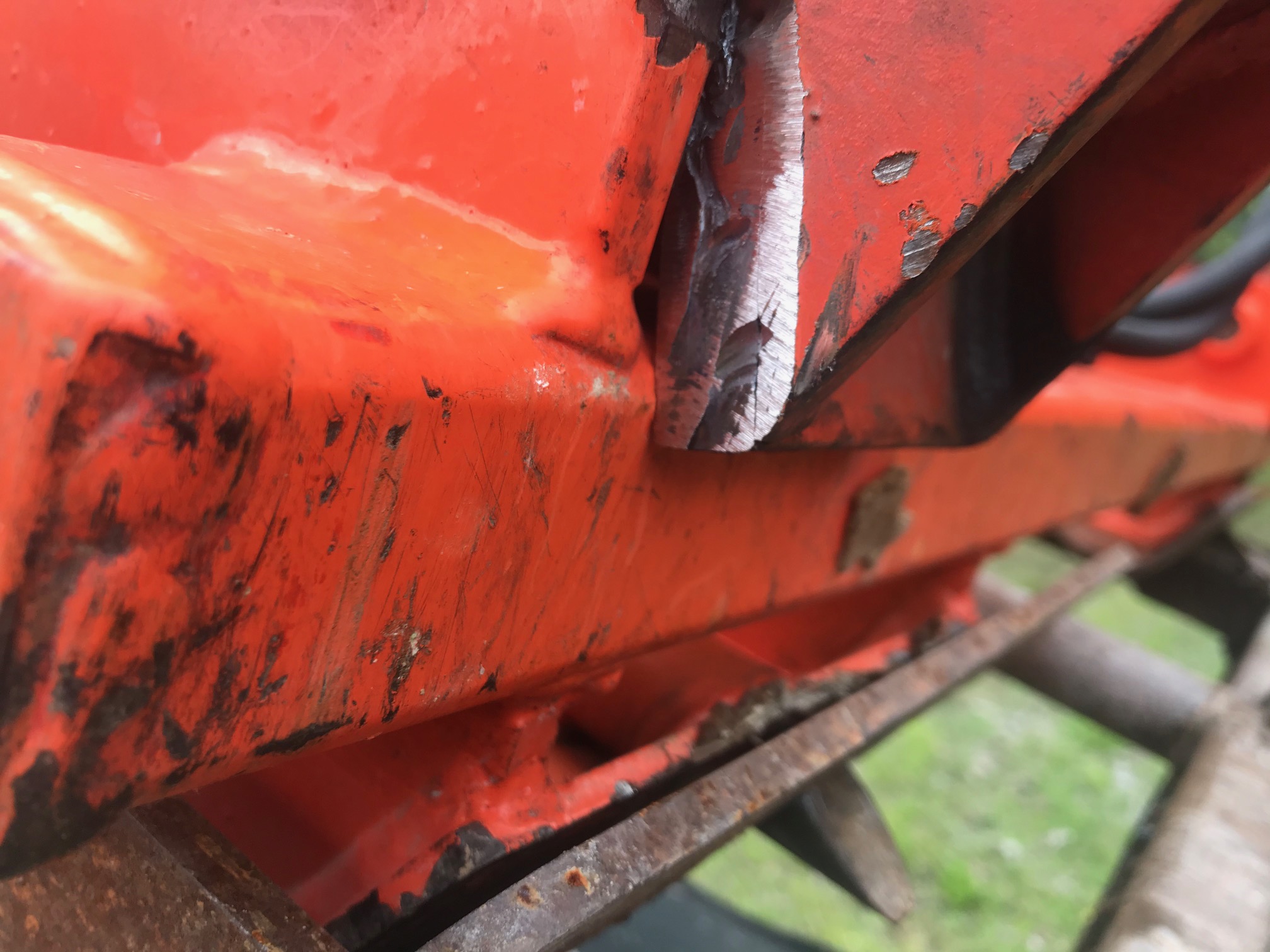

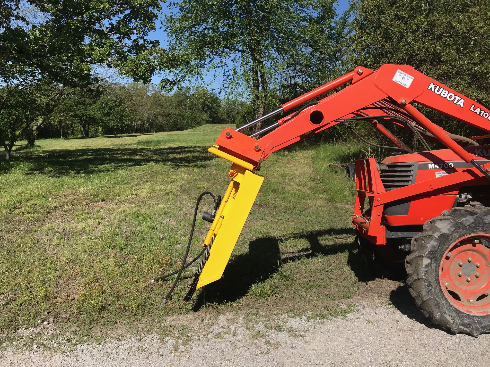

Ok, here's a quick update. Based on ptsg's mention of the bucket stops, I inspected those and indeed the qa plate was hitting/stopping on them. I went ahead and cut them off and I got a fair amount of additional tilt. The qa still stops on the mount and it appears I can cut a bit more off and possibly get more travel out of the cylinders unless they bottom out. I'm not sure how I could figure that out before cutting?
I did get about 1 1/2" of additional travel out of the cylinders.
Anyway, here's a couple of pictures to show the gain. I'm reposting the original pic to show the difference. Who knows, I may get out of this without having to build something!

It did make a difference. I don't think you'll be able to get the mower vertical by just cutting the stop though, but it's something already.
You can always measure the cylinder the way it is now, then disconnect the pin on the quick attach and extend the cylinder to see if there is any travel left in it.
The stops are there for a reason, so if the quick attach hit the stops at the same time the cylinders has no more travel, it would be golden.
